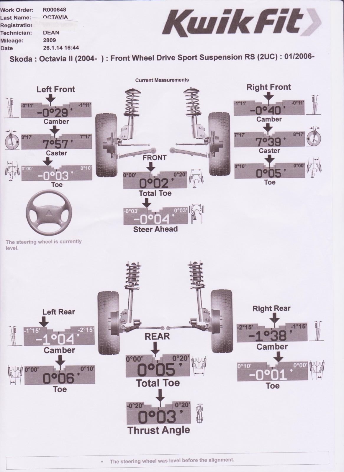

Local KWIK Fit dealer in Southend on sea (great service bought winter tyres + twice a year swap over to/ from summer set), now has 4 wheel alignment system. Just had car checked FOC. (see attachment)
Skoda UK contacted me on Saturday afternoon. They provided a hire car for 4 days and were checking if everything ok. Told them car does not feel right and needs further checks made. Skoda with contact me next week, to discuss options / solution.
