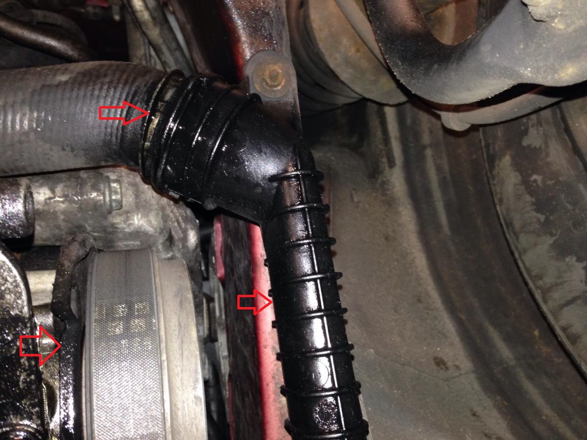

I thought I would start a new thread for this. Whilst under the car I noticed a reasonable amount of oil as detailed in the attached pic. The arrow on the far left shows where oil is collecting very close to the aux belt. This appears to be coming from the sump?
The middle arrows shows wat appears to be an ill fitting intercooler hose - possibly escaping the cooler . Would this cause the oil which is noticable indicated by the third arrow?

Twice now I've bought filters that weren't crimped around the edges properly so oil leaked from the filter it's self, worth a check
