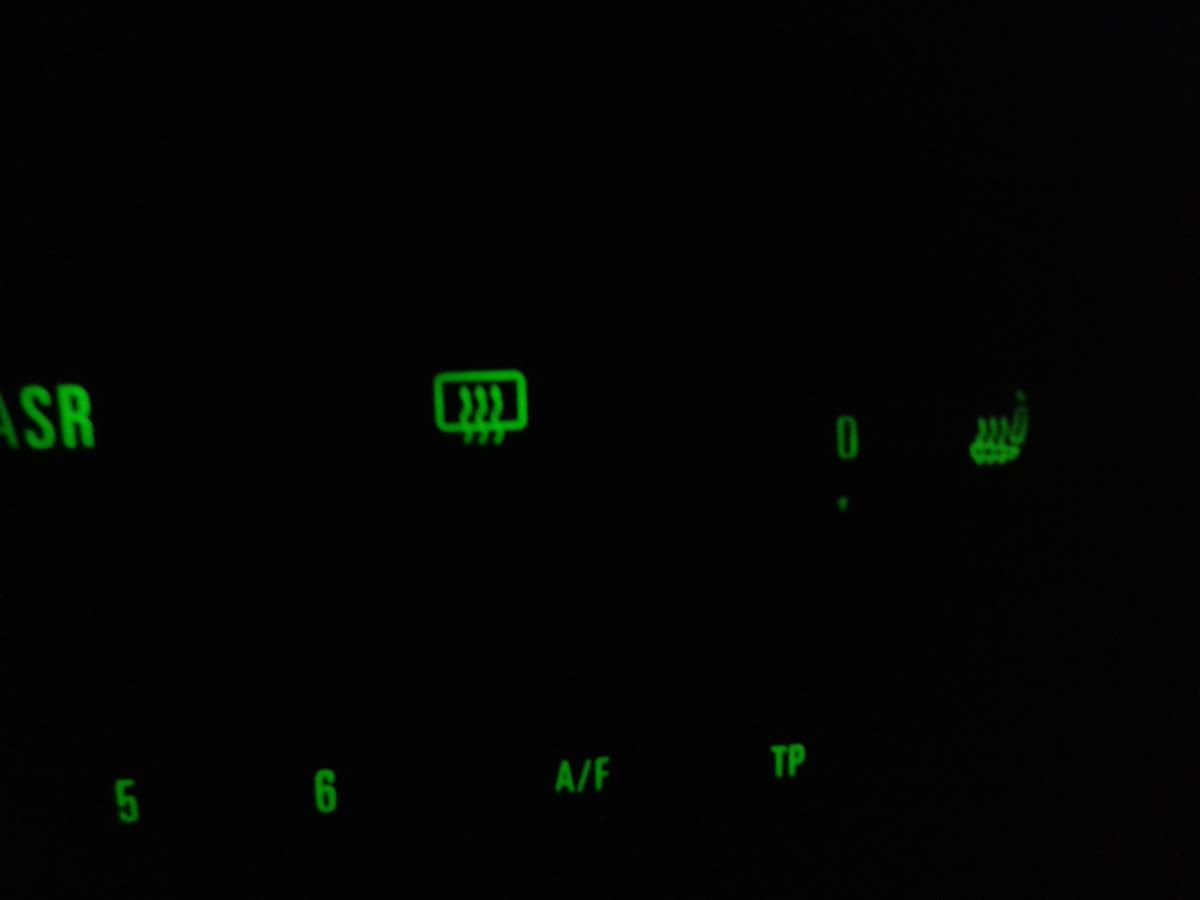

Ermmm. Mine light up. Will post pics in a bit.
Edit. Doh.
Mine light up.
Not sure if these will be of any use
Mine light up. Vrs normal 56 plate none leather
Mine light up also.
Mine light up on my 2006 Elegance estate.

They only light up when the rest of your interior illuminates from turning on your dipped headlights

Checked mine this morning and yes I can confirm mine has lights! Amazing I'd never noticed it before!
