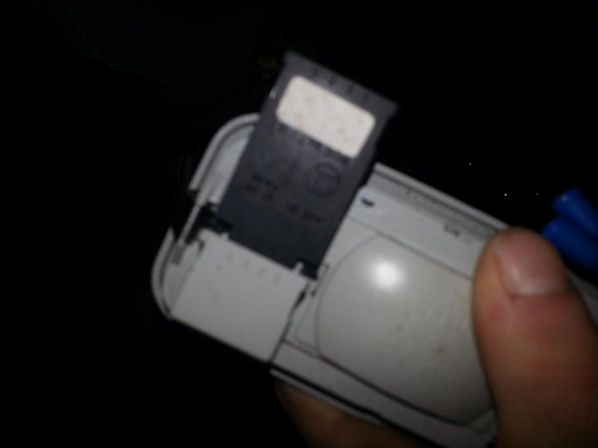

Sorry break. ... phones try what tom says and they do run on a parallel I fitted two to the rear off my hatch... theres one for ya tom and you can fit a interior light delay too..
Yeah I've got one of those delay relays sat in the top of my tool box waiting to go in a, I bought it ages ago off Phil-E on here. I think they were originally fitted to an L & K model.
I have a spare and sold a few there fitted to glxi and slxi... have you got a rear intermittent wiper relay
Yes mine is a glxi, and it also had remote central locking too, but it has a mind of it's own sometimes.
