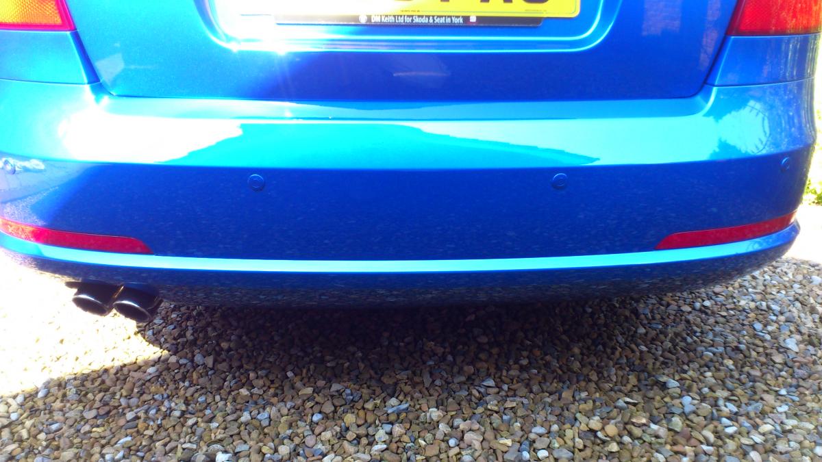

3)Find a Cobra dealer that will supply the Parkmaster kit. When I bought my vRS I wanted parking sensors and didn't want the type that load in from the front, but the smaller, flush fit sensors. I paid £170 fitted for a kit that looks OE.
image by jonnyguitar, on Flickr
4) Either do what Karl did and DIY an OPS kit or find an OE retrofit company who will do it for you. There is a guy down south who does OE retrofits and can supply and fit rear OPS for £270. If I had found out about that before putting in my Cobra kit, I would have definitely gone down that route.
