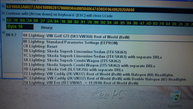

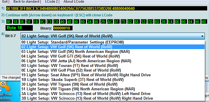

Today I was thinking again over this problem and the only one place where I don't check was Byte 18. There are different settings for the different models, am I supposed to change it from there? I attache 2 pictures found on the Internet to see  what I am talking about. I don't remember how it was tuned to my car, I have to check.
Beware that your Byte 18 is hidden behind the mask of ’00’
So if you want / need to change it back to what it is now good luck... because your current code is hidden!
Currently my 18 byte encoded at 1B, of any change it?
