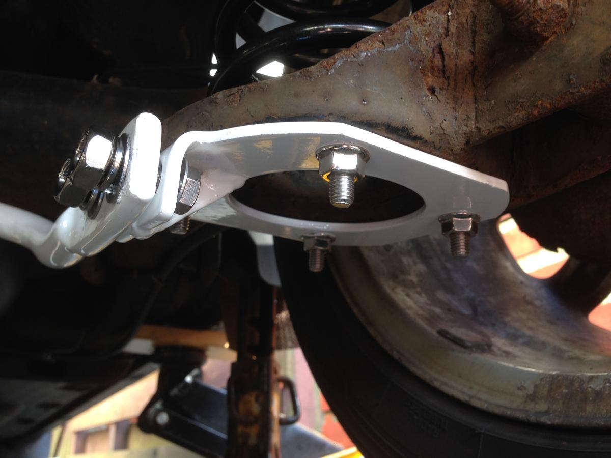

  • the design of the jabba and whiteline is very poor, clamping it into position? This is fixed into position by 8 bolts, much better in my opinion.
Actually lot more difficult to fabricate if it were one piece and difficult to fit as well, bolts are much more forgiving when it comes to slight differences in alignment.
I'm talking about the part where the bar meets the cup.
Having that bit welded and doing away with the bolts would surely be stronger. If it was in fact more like a torsion bar than a roll bar like you explained in he other thread, having that part welded would seem to help it do it's job.
The cup part that mounts to the bottom part of the suspension leg is also bolted in, by having slightly larger holes that would help for alignment purposes.
I'm not so much doubting what your saying i'm just trying to make sense of the design, as it is a lot different to the major players in the market.
It does as others have said look more like a lower strut brace rather than a anti-roll bar.

Plus torsional forces would eventually brake the welds. If it was welded.
And make the box it comes in bigger too :P
predictive text haha
Edited by fletch101
Plus torsional forces would eventually brake the welds. If it was welded. And male the boc it comes in bigger.
fletch has it right, welds would fatigue and crack. This way the bar can be made of tempered spring steel and the mounting plates can be mild steel.
Ah I see that makes sense.

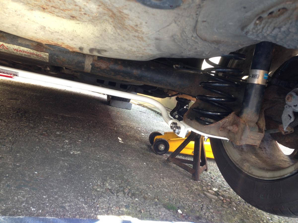

Recently purchased the Ultra Racing RARB for the Fabia. It's a solid looking piece of kit and comes with stainless bolts nuts and washers. Bought it off ebay for the polo 1.8t as it says in the product description and fits perfectly!
The car is now planted, significantly less body roll, and handles far better.
Pictures of mine, PS. Rust adds to character ;)
Now...... Are you sure that you tightened those bolts up? :)
That's before i torqued them up :P more of a reference picture if anyone buys it as it has no instructions :(
