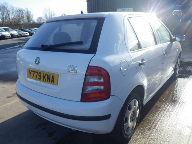

I have just bought a 2001 Fabia 1.4 Mpi
On the way home it completely died which we are hoping is a failed alternator and loss of power. The Power Steering was the first thing that failed
We have water contaminated in the Header tank which looks like a head gasket failure as I would have expected on a Rover K Series.
I can find no mention on this forum of HGF on these cars
I am about to order a gasket. Are the head bolts of the Stretch Type and do I need them when the engine is stripped down?
Any advice would be appreciated
