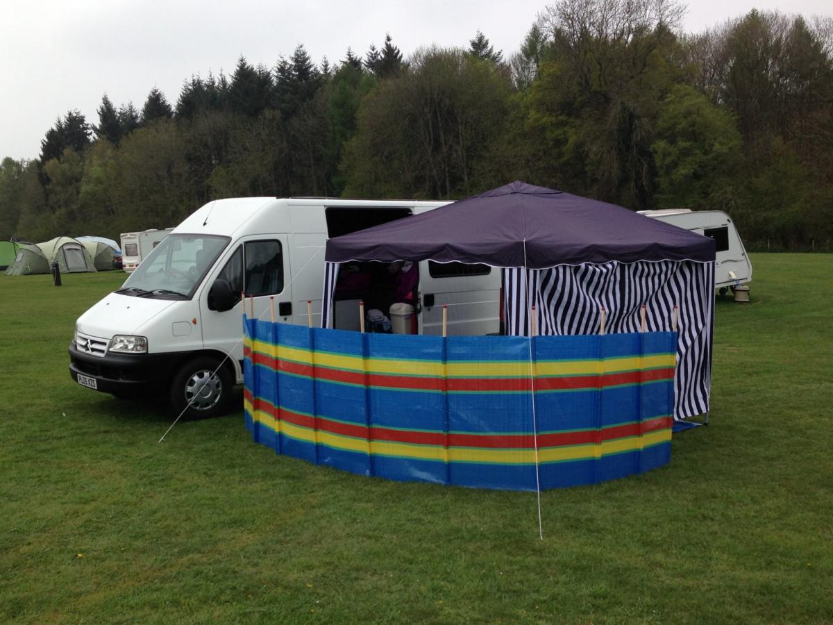

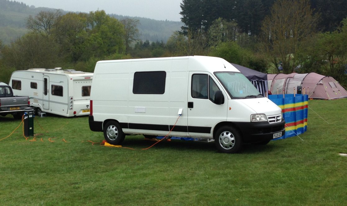

We are camping now in the Relay
That looks great :) I've always fancied a van, and I'm warming my wife up to the idea.
My dad had a 1986 Talbot Express based campervan which was exactly the same vehicle underneath as yours.
The gearchange on that was floor mounted, and had so much slop and throw you felt like your arm was going into a different timezone. No power steering either so much fun in low speed manoeuvring :)

You need to get yourself an awning Techie!
We just installed a new one as the previous one was very old. Got one from an ex-bike racing support van. Awning has never been wound out even. Came with sides etc and was a bargain!
Phil
Lol. I reckon I can cope without :strong:
Phil
I bought a pop up gazebo, bonus is its up in a few minutes. Quite fancy a roof mounted wind out one but they are far from cheap and pretty unstable when windy.
Ah cool. We have one of those too.
We got ours for £300 so it was a good price.
It comes with rigid side bars and proper tie down straps as it's designed to be wind proof (to a certain extent obviously!).
Phil
