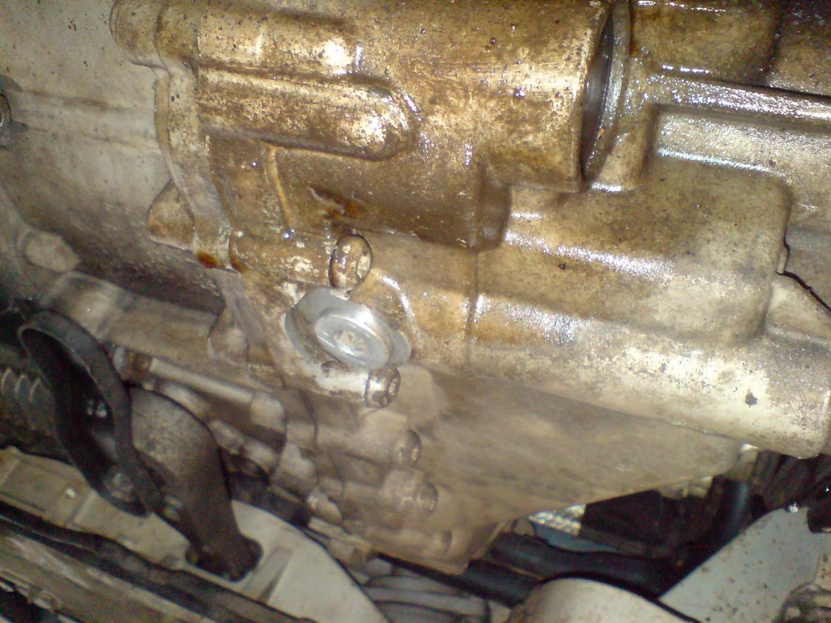

However, the transfer box I mentioned maybe correctly named as Power Transfer Unit ? its attatched to the gearbox and looks lke the diff housing on FWD car - it splits the drive and sends power to the rear via the propshaft. Mine definately has a magnetic drain plug fitted - looking from the O/S wheel its located level with the bottom of the inner CV joint.
As I understand it its filled via the gearbox but has a seperate oil drain as it wouldn't be drained when the one from the box is removed.

No, its part of the gearbox but there are 2 drain plugs to remove otherwise you'll have left old oil in part of it.
Usual gearbox drain plug - in my case a 10mm hex
2nd drain plug(magnetic) -drains from diff/PTU housing
Hope that makes it clear.
Scott

cheers Looks like a steel plug?  mine were soft ally with a deep but tapered hex socket  and very easy to damage

Correction the PTU is filled seperately from the gearbox
