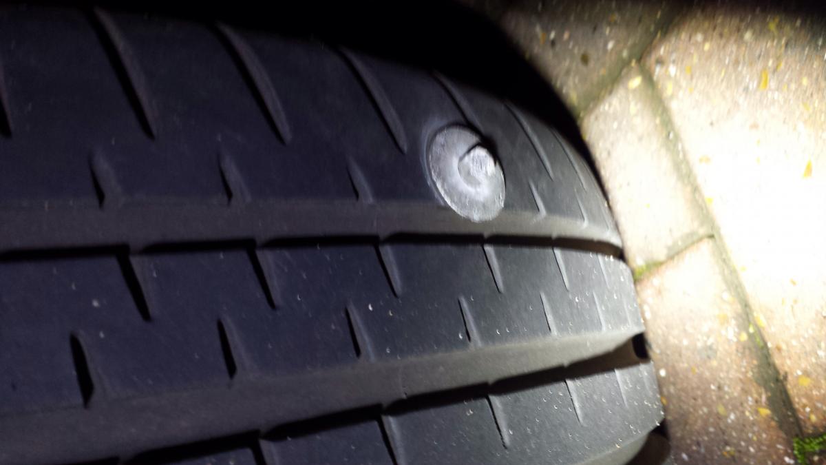

Well my car (VRS hatch) just ticked over the 1000 mile mark and when I left work last night a kind person has left it a present. They must have known it had reached this milestone...the wa£&@/r. Happens quite a lot to our work unfortunately.
They will be pluggable so should only cost a tenner or so from Kwikfit. Be thankful that (if it was deliberate) someone didn't key your car instead.

That's quite near the edge of the tyre though.....

I'm pretty confident that won't be repairable but switching to even more expensive 19's when it'll probably happen again isn't wise..... Maybe a new job should be on the cards?
I had a vulcanised repair done to a tyre that was deemed unrepairable with a plug a few years ago. Worked fine and had no issues. Not many places do it though. Cost me about £6.

I'll have a check And see if it can be fixed. Been looking at a set of Xtremes for a while ...I just can't help but think it will then need lowering.
it looks to be more than 3/4" from the side so should be ok
Do you have a spare to fit temporarily ? Not driving on the affected tyre will minimise the chance of any additional run-flat damage.
National do free puncture repairs - I got a puncture in a similar place repaired recently.
You just pay for the valve and balancing (usually around a tenner) - voucher here : http://www.national.co.uk/special-offers-puncture.aspx
If you want to suss whether it's repairable or not before going in, there's some useful info here : http://www.etyres.co.uk/tyres/punctures

The tyre looks like it will plug. I had a similar a while back & the tyre place plugged & vulcanised it. Seemed like standard practice for them.

Result. They managed to plug it so that saved me some cash...however as a result of my money saving, and maybe a couple of steins of lager last night I managed to spend £150 on cleanyourcar....whoops
