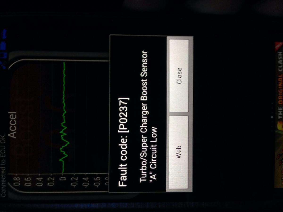

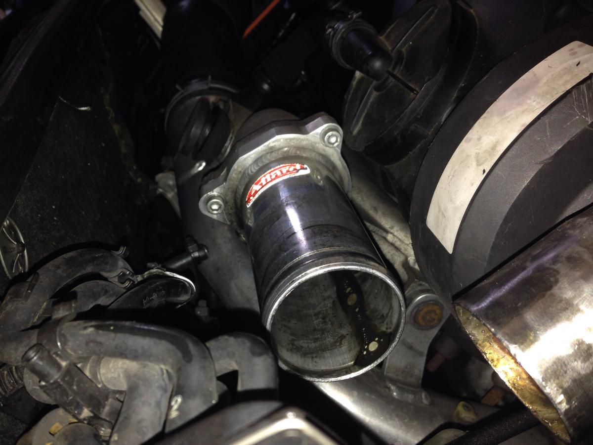

So my turbos been playing up for a few days now, started having no boost in first or second and I now have no boost at all. Had a quick look at it today. Found a wet looking patch on the front of the intercooler, with water in the hoses mixed with oil. The cars not loosing to much coolant or oil though. From under the egr delete it was covered in watered down looking oil. That's all I can see from a quick look today, I'm thinking my intercooler has some how burst and my turbos away.. I've not got to much experience with problems like this so any help would be appreciated! Also from the engine management light I'm getting an error code, 'P0237' which says 'turbo/supercharger boost sensor A circuit low' thanks for any help
It's not unusal for the inlet tract to be moist.
Might be worth undoing the boost pipe to the bottom of the intercooler and letting any fluid drain out.  I do this when I change the oil.
The probable causes for P0237 are:
  • wiring short to earth
  • boost sensor
  • ecu
Good luck

Do you have a front mount cooler or side mount?
The water could just be condensation and most likely nothing to worry about. Oil in the intercooler pipework is pretty normal as long as its only a small quantity.
