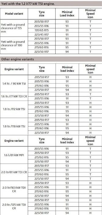

I asked exactly the same question a few months ago. What the car comes fitted with doesn't necessarily mean this is what it is type-approved with as it may just be a commercial thing by Skoda to get all tyres in one rating.
I have the Vector 4Seasons on mine right now with the correct load rating but on a V speed rating.
The last type approval number for the Yeti (ending in 18) listed by Skoda Germany, has both T and H for the 225/50 R17 tyre depending on engine. Think this has a lot to do with tyre manufacturers now making tyres in this size in the lower ratings; when the Yeti first appeared W rating was about it. Again I think this was possible due to the size being used mainly for high performance cars like the Audi TT originally.
