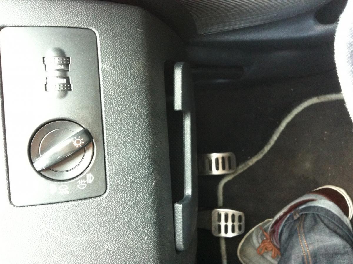

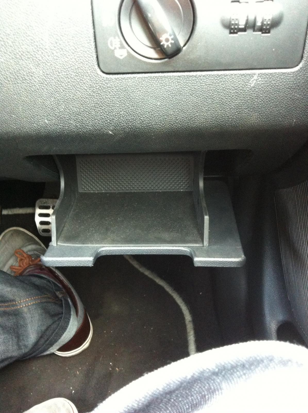

I found a compartment under the steering wheel. It says in the hand book it's lockable... I opened it and now I can't close it again, I've pushed and pushed and it won't close completely. Any ideas on why this happens or how to lock or unlock it? I've tried closing it when the car engine is on and off and with the doors locked and unlocked but it seems to make no difference. Here are some pictures to show you what I mean. It did used to sit flush before I opened it though, only had the car 2 days... sigh.
Here's the pics
Yea sorry I meant that but wrote different :(
No probs :)
Your compartment cover has simply come off the hinge clips. It's designed to be removable and the main diagnostic socket is behind it. You just need to get it back on the hinge clips and it'll be fine. It's not lockable, it just clicks shut.
