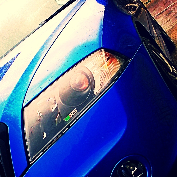

job done! well worth it.
vrs rear caliper sticker as a finishing touch
