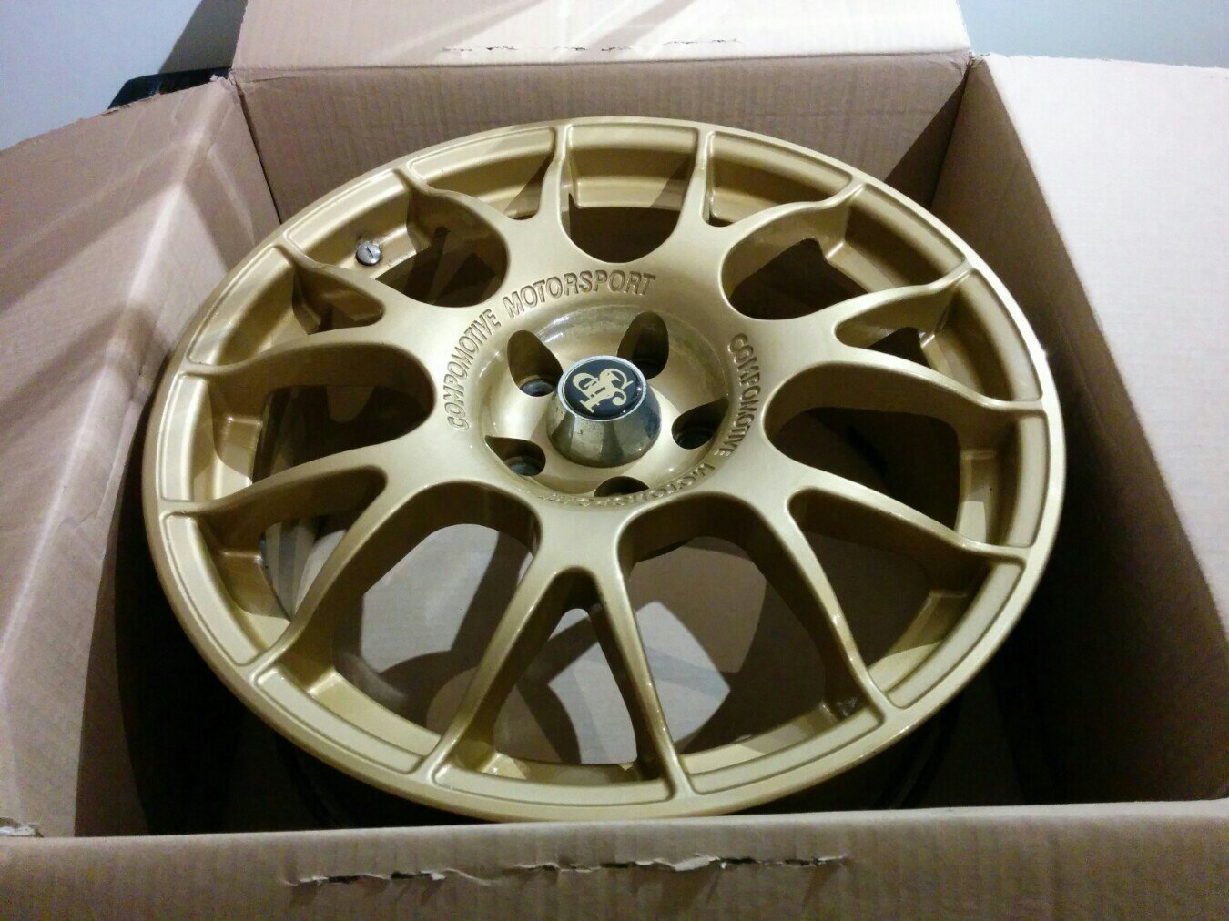

Now have Brimma's old wheels :-) post-103429-13949188346131_thumb.jpg
Now have Brimma's old wheels :-) attachicon.gifuploadfromtaptalk1394918795293.jpg

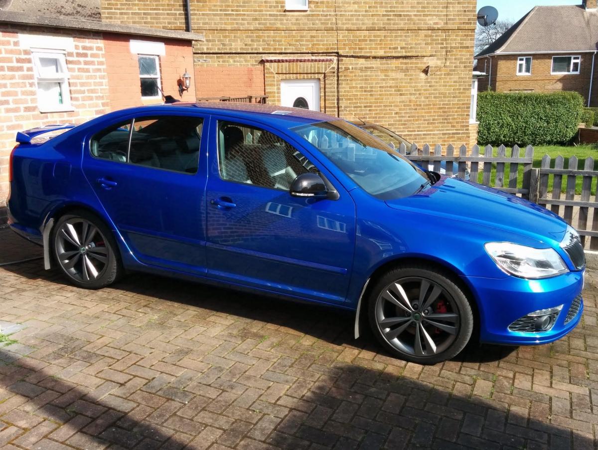

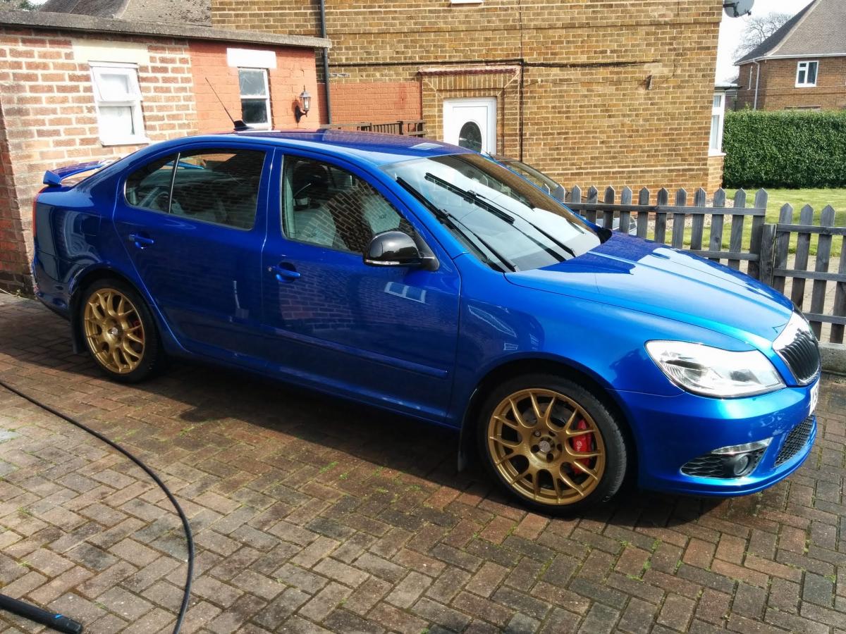

It's taken a while but I have got around to getting the tyres swapped over from the Neptunes to the Compomotives.
Before
After
I shall be changing the colour when I get them refurbished, but I'm going to wait until I have worn out the PS3s.

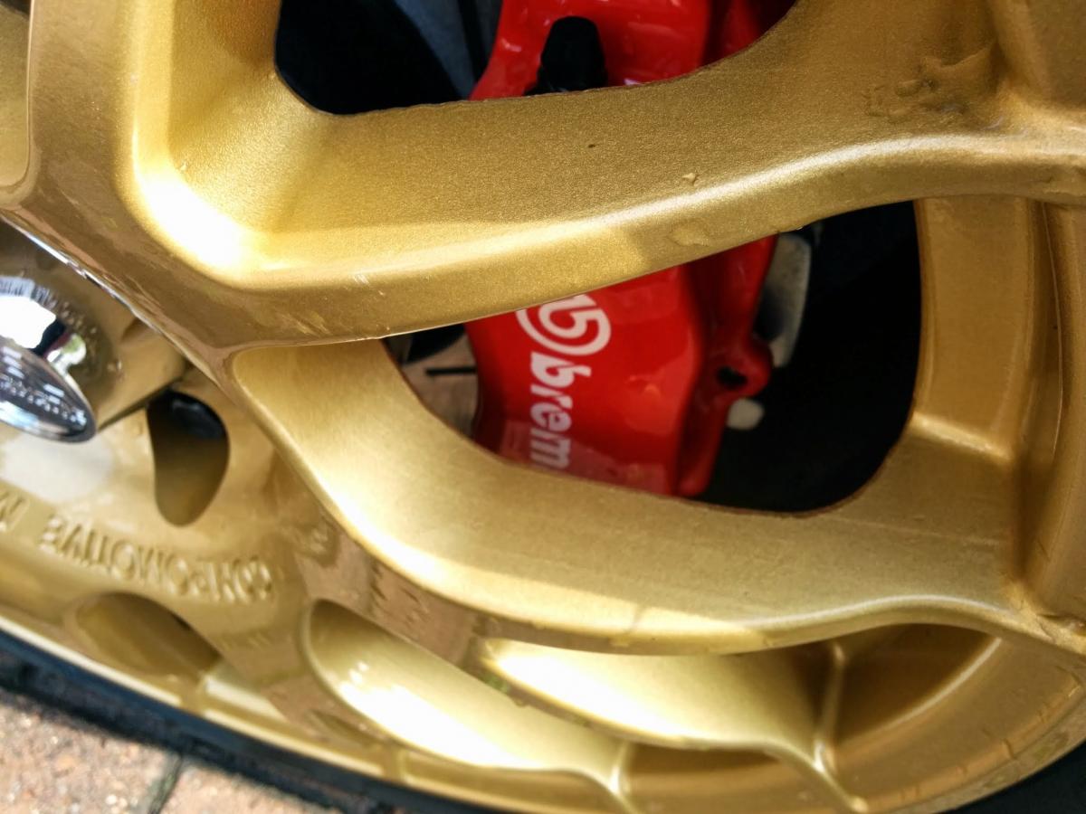

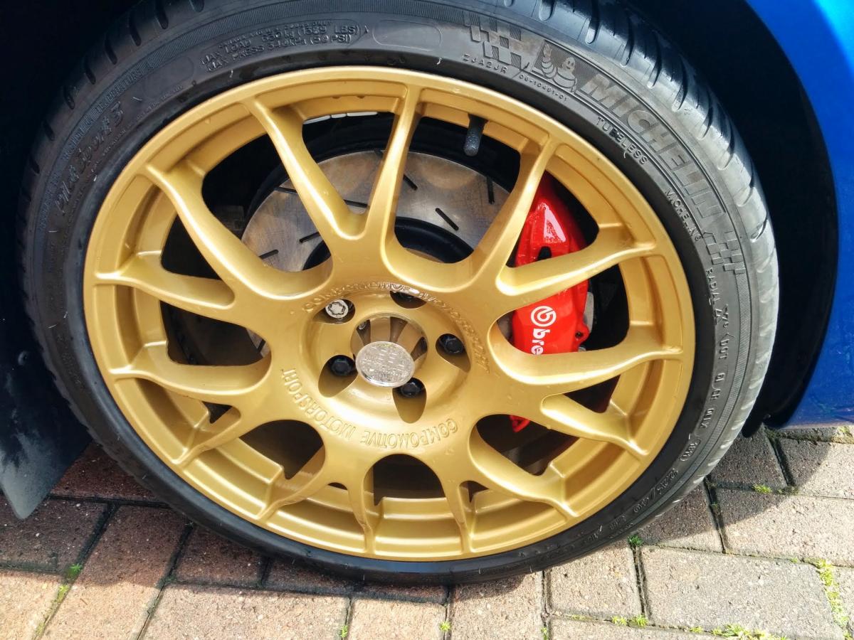

Fitted the 986 calipers as well, loads of space behind the wheels, I'll just have to get some bigger brakes :p
post-103429-0-66865300-1396209943_thumb.jpg post-103429-0-69252600-1396209944_thumb.jpg
There must be around 12-15 mm spare space.
I agree
I agree
Me too...............but then I would  :)
I'll have to keep an eye for you, pretty distinctive now.
Got to to agree with the others on this one, keep them gold.
I'll have to keep a closer eye on the Spotted page.
The colour combination is slowly growing on me. The other half hates it, even more reason to keep them the same  :rofl:
