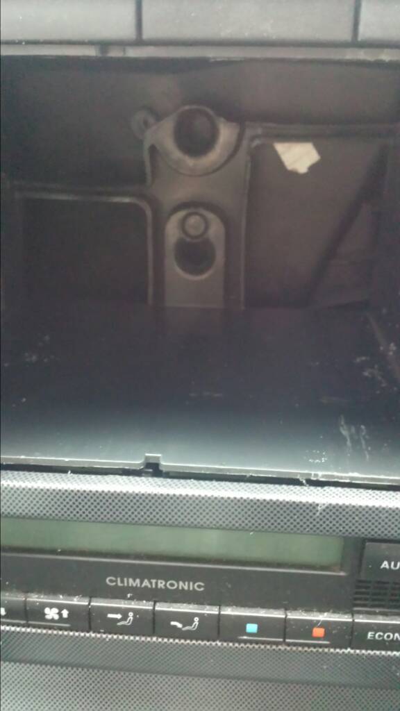

Recently bought a double din head unit to replace mine but having massive trouble fitting it. I cant get the cage to be flush it just sticks out. Ive attached some pics if somebody could point me in right direction of what to do?

is there actually enough room to fit the radio in without cage flush?
the radio goes in without the cage, but is loose and doesnt fit flush.
If u look in the hole you'll see like a plastic H bar
U carefully remove that ( watch the loom )
It will give u clearance

^^^ What he said. I`ve fitted a JVC double din to mine a few days ago, had the same issue, snipped the H bar out, sorted! B)
Where is the h bar on the side or right at the back?

The H bar is right at the back. All you need is that half cage you have, that`s the same as I fitted.
So its just that at the back? Whats best way to cut it?

Thats it, 3 cuts n gone
A hacksaw blade will do it
Just go careful cos of loom
U could get medieval and use side cutters :D
Snip snip

Yup, that`s the puppy. I used tin slips believe it or not, probably not the best, but it worked. Just watch out for the loom/wires as Lloyd mentioned as your doing it though.
cheers for the responses, will give it a go tonight. do i need to get rid of all of it including the bigger bit in the middle?
Garden cutters rip that mofo up nice and easy ;)
As said, this H piece has to go - I reached in with a good pair of side cutters and butchered it out, like a bad dentist pulling teeth! :D
It took me about 30 seconds. And stereo fitting became joyous.
Yeah bud
Both sides.
And along bottom
Maximum space
