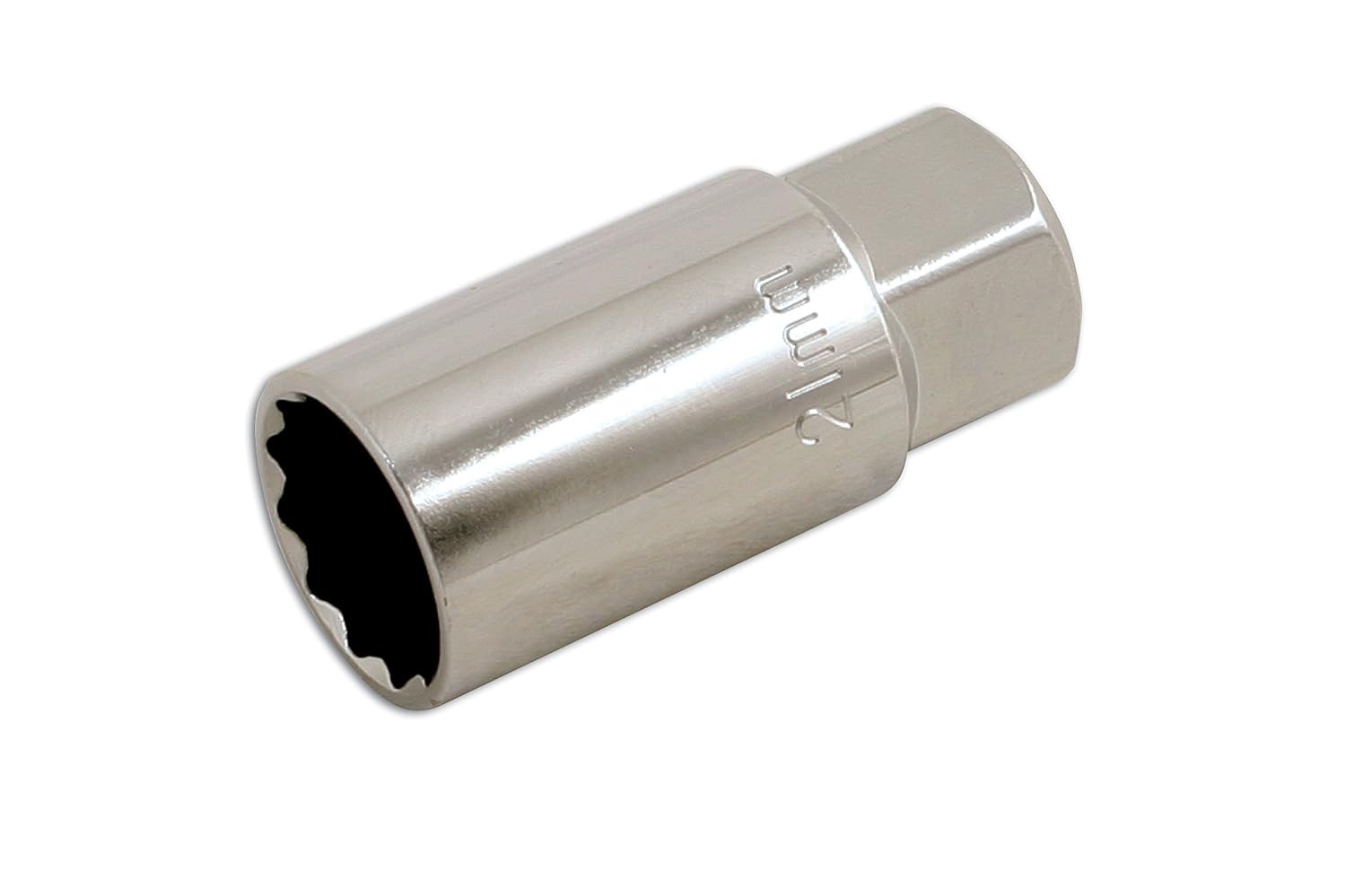

21mm deep socket.

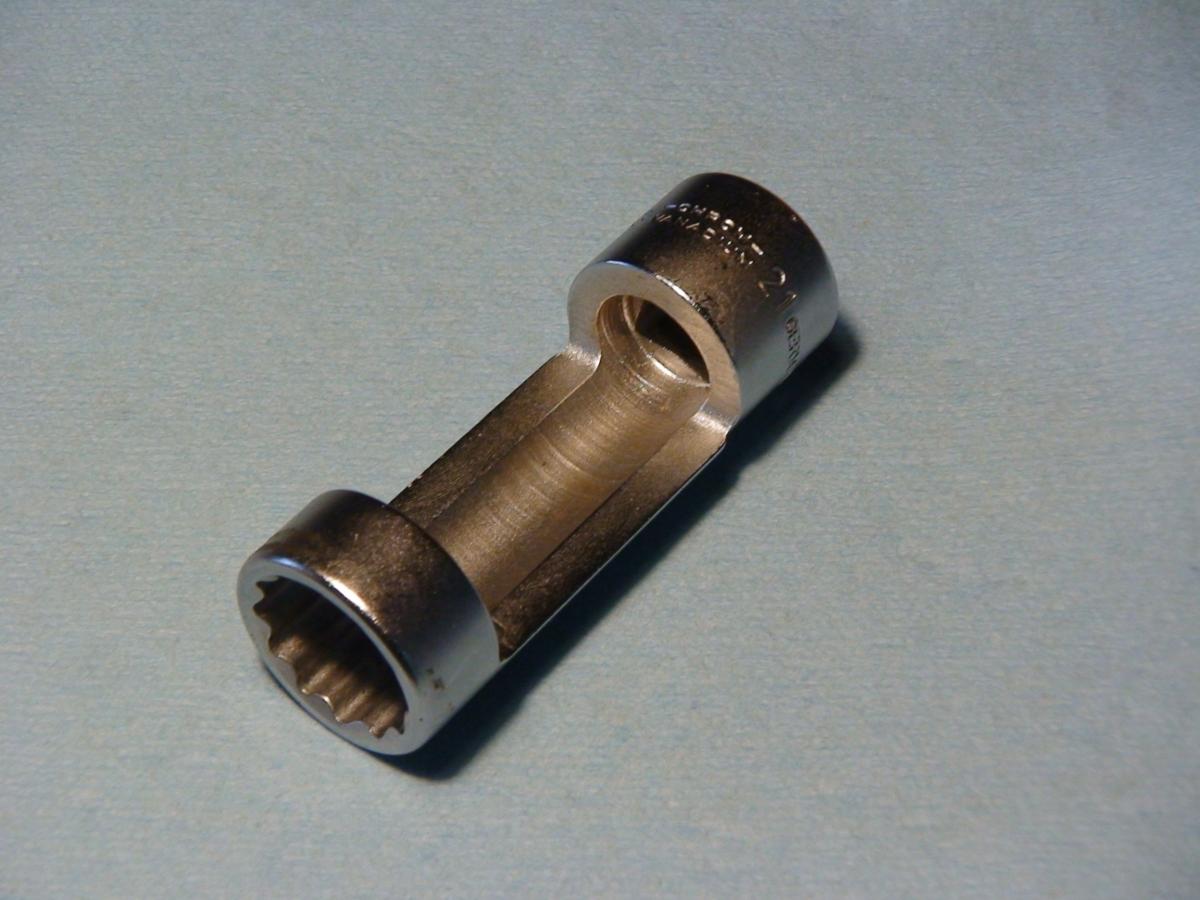

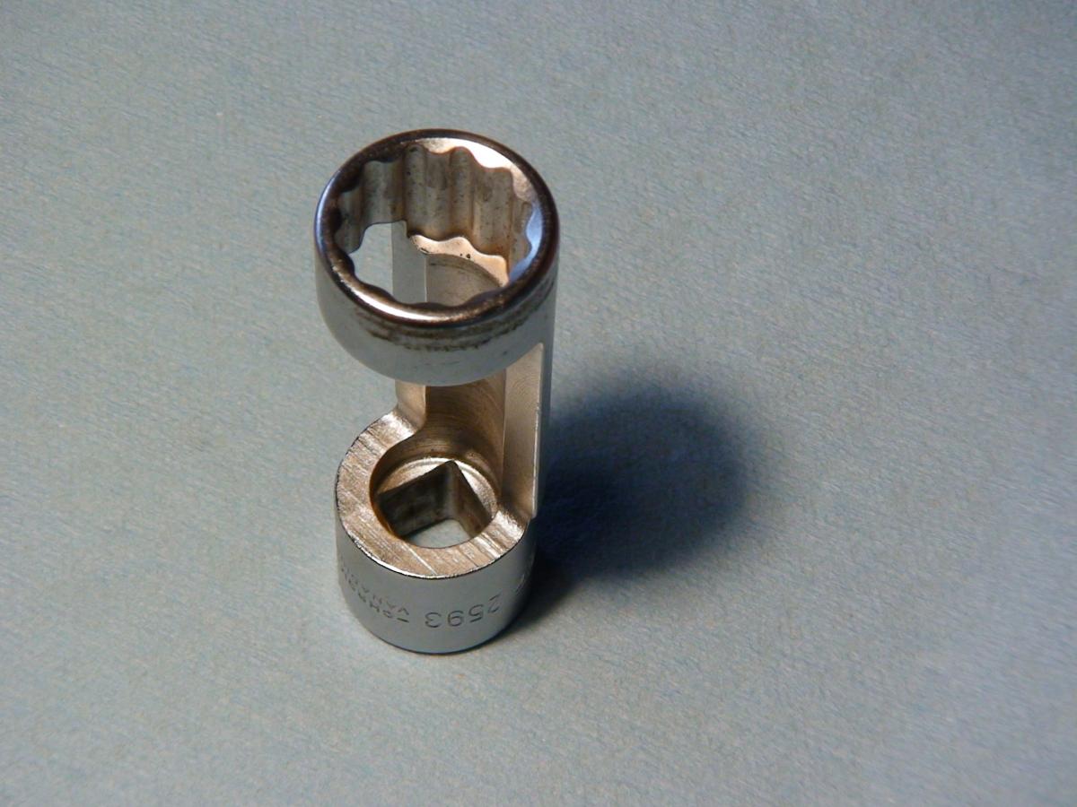

You should be using an open socket (see below). It's the only way you can correctly torque the nut whilst counterholding the rod.

You need a open socket 21mm for std bolt or 22m for a coilover strut nut
Depending on how often you use it i would just get a 21mm deep ring spanner form B&Q . They are 21mm/23mm either side and 22mm/24mm so i got both
plus i got this kit as i love my tools :rofl:
Laser do a 21mm open socket. IIRC, it's listed as a diesel injector socket.
Although aftermarket struts tend to use a 22mm top nut, the thread size/pitch is usually the same as VAG top nuts, which are 21mm. If you only use VAG top nuts, you really only need 21mm.
