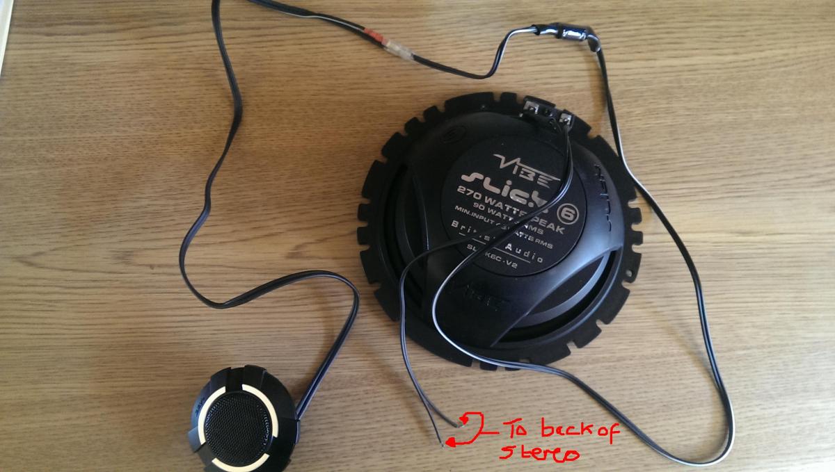

Hoping it will sound better than the standard set up. Can someone tell me, does the door card need to be removed ie is there a crossover behind it, or can I just flip off the existing speaker grill and screw in the new speaker.I am going to try and modify the new tweeters into the existing housing. Should I go with the way the speaker and tweeter are wired up now, or wire them up like in the picture below?

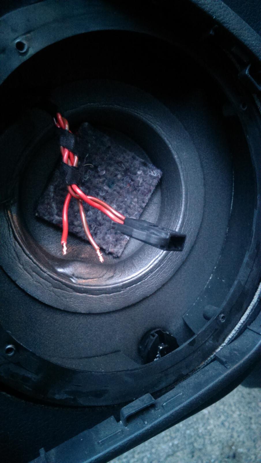

Door cards off bud, full access to speaker
No crossover

Yeah the tweeter pos will piggy back of the speaker pos
Same with neg
Then the oem - to -
+ to + mate
Phone wouldnt zoom enough
Thanks Lloyd, I have pretty much full access to the speaker with out having to take the door card off as in picture 2. But I will remove it anyway, tomorrow hopefully,I was going to do it tonight in the dark then realised quite quickly that's a stupid idea lol

Will make running the tweeter up easier with door card off
What i did is used a soldering iron to melt the oem tweeter bracket to the size needed to fit my tweeter
Then used buytl to form a ring around tweet so no sound lost backwards into door
Then used a glue gun to tack the tweeter in place

mind your door membranes when your tackling the speakers! or you will be taking the door cards off to find the leak...
Thanks, I wasn't 100% sure if it was just sound deadening or waterproofing as well
the plastic is very much waterproofing.... just search for "Water in footwells" or leaky doors....
quite a few are sourced back to a/m speaker fitting breaking the plastic...
