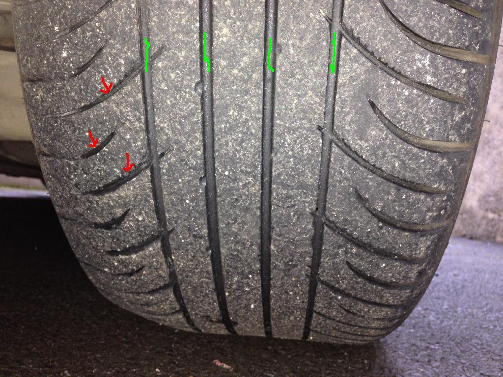

its just my car failed its MOT today for inside edge on the rear tyres
went to my local tyre place and they believe they are completely legal (as do i), i was just in a pickle whether or not to get 2 new rears at £218 or buy a whole new set of wheels and tyres as i don't particularly want to spend £218 on a set of wheels i dont particularly like.

Doesn't the MOT guide say that the tread in the centre has to be above the minimum and there are no steels/canvas showing? (And no damage etc but not relevant here)
I wore the edge down on my winters by running them too low pressure wise, both edges are worn but the centre is fine. Council MOT place advised me on them 2 years ago. I put them on the rear and kept the pressures where they should be... passed 1 MOT since with the same advisory and another centre didn't even advise (edit because I forgot about the last bit... my brother has the car now and MOT'd it at a difference council centre).
Edited by DanHarper
1. The grooves of the tread pattern are not at least 1.6mm throughout a continuous band comprising the central three-quarters of the breadth of tread, and round the entire outer circumference of the tyre Note: Each side of the central band of the tyre can be devoid of tread (ie. ‘bald’) and still meet the pass.  See diagram below
Source: http://www.motuk.co.uk/manual_410.htm section 4.1

Basically the tread on the rear has between 3-4mm over the entire tread. Except the rear inner edge (10mm) which has worn.
This is how runflats wear apparently
Print the page off the manual and shove it in his face (or go to another station, get the all clear and complain to VOSA).

I know its hard to tell from the pic but the tread over the tyre is about 3mm (well above wear markers)
Wear is on inside edge
3A8E6634-ABBC-4E0C-8096-3F1AAF043888_zps
Legal or not?
If the grooves that I've arrowed in red are not cut as deep as the main grooves that I've marked in green, for MOT purposes the red grooves are not part of the tyre tread and the depth cannot be measured there, which makes it legal.
So the tyre is legal basically.
Just as i thought.
Failed on both rears like that
Then appeal!
It isn't that difficult to do, plus it points out to VOSA a garage that is possibly failing cars on purpose to gain work or sales.
The garage will not like having an appeal against them!

tbh, id be tempted to fail that (if i was a tester, which im not!), if an eye isnt kept on it it could go right through and deflate. Id say turn it round to the outside where you can see it and it would be safer.
Safety is the most important thing.
Looks a bit like a tracking issue to me?
Its a runflat
Tbh i keep an eye on my car.
No tracking issue its just the camber on the back and the fact its a runflat (its how they wear on the rear apparently)
From a legality and mot point of view the tyre is completely legal
