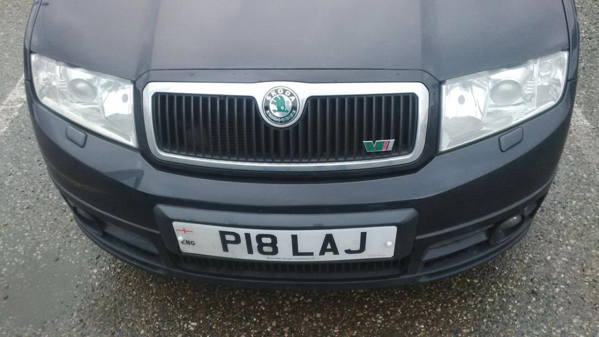

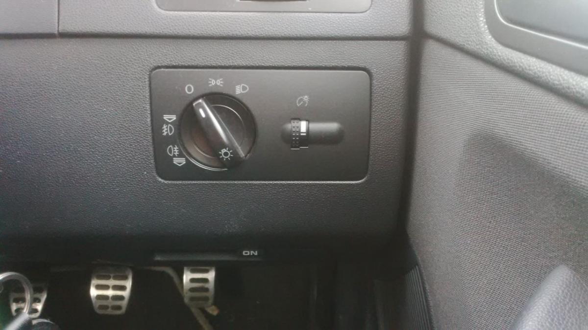

I have 2 photos that show the light controls and the front of the car, can you tell weather they are factory fit from these?!
Does anyone know this car?!
Looks like the real deal to me. No switch for the levelling plus projectors and washers.
Great thanks!
