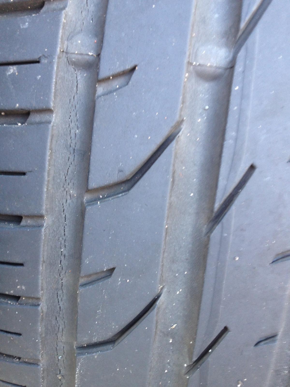

Just noticed on SWMBO's Citigo Sport that between the tread on the front tyres (haven't had time to look at the back as she has gone to work in it) the rubber is all cracked. She's had the car for 6 month and its done about 4500 miles.

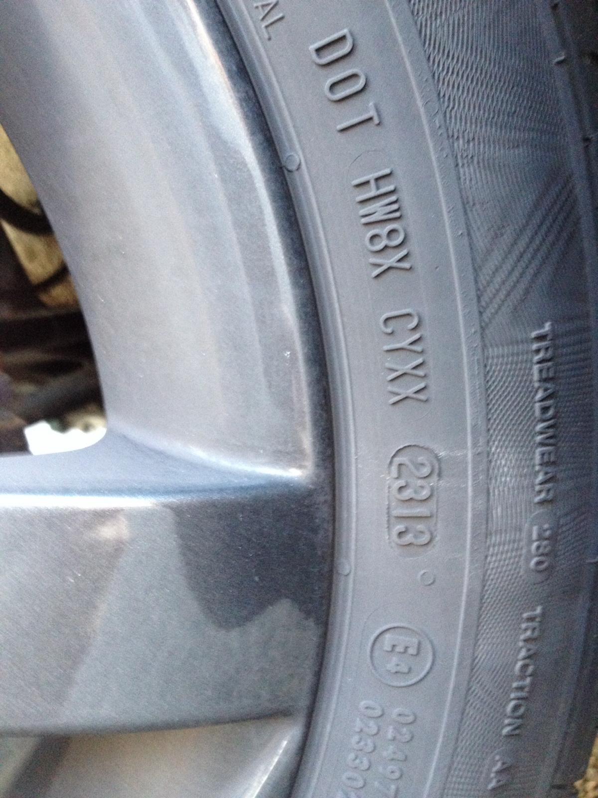

Just checked mine,all seem fine and all have a manufacture date of 3413,ie week 34 2013,what dates are yours?.
Mine are fine but I would expect that after only 2000 miles lol dated 2713

The cracking on hers is in the grooves of the tread pattern.
Once I've had a look I'll post back and I'll get a pic up too.
@leckman where is the date located pal?
The production date is on the tyre,just above the rim you will see an oval shape with 4 digits in it,this is the date I am referring to.
Cheers I'll have a look for it.

Mine has 0313 on them and are all ok.

Sorry for the delay in getting these up guys, been hectic the last few days with passing the wife going to work as I come in and getting sorted for my sons birthday party today.
Anyway hopefully the pics have attached to this ok. I've checked all 4 tyres and they are all the same, the one in the pic says 2313 for the date (assuming I'm looking at the correct bit) and the other 3 say 1613.
I've asked my dad to check his as well (also Citigo Sport) and he said his is the same. He didn't know what the date was though.
Yes, you looked at the right bit of digits in order to find out the manufacturing date.
To be honest I don't like the cracks on the tyre. I suggest you to ask a tyre expert about this and then ask your dealer. If it was me, I would send an e-mail with the photos to the Continental and ask their opinion.
Google 'Tyre Dry Rot' and you will see similar photos.
Glad i've got the Bridgestones. Don't like the look of those cracks.
Not fit for purpose, the dealer should change all of them without any quibble.
