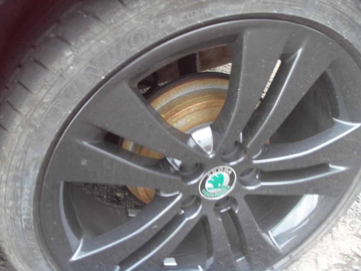

Fabia Montecarlo alloy wheel colour/paint code
Hi, Does anyone know the colour and paint code for the alloy Trinity wheels fitted to my Montecarlo. Seems to be confusion as to what the actual colour / paint code is . Who can supply's the correct paint in aerosol cans.
Parts book lists the colour as FL8 black matallic, although they do look more granite grey to me and most posts I've read suggest F7S is a good match.

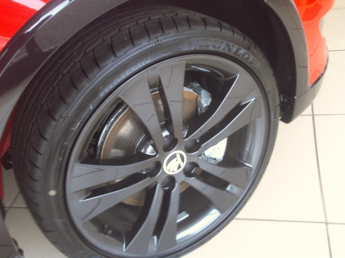

Monte carlo wheels are dark grey not black. Correct paint code is F7s
I have the Monte black edition and my wheels are the dark grey. However in all the black edition literature they say that it comes with black wheels. Is this just the way they they describe that colour or have they put the wrong wheels on mine?
They will be 'Off-Black'  which anything not Pure Black is known as, so 50 Shades of Grey.
It will be the correct Black Trinity Alloys on your car in a Greyish Black.

Ive tried both these codes and none of them match the greyish colour monte carlo wheels i have the dealer give me the fl8 code which is black and there not black can any one help me need to get a replacement alloy on my car asap

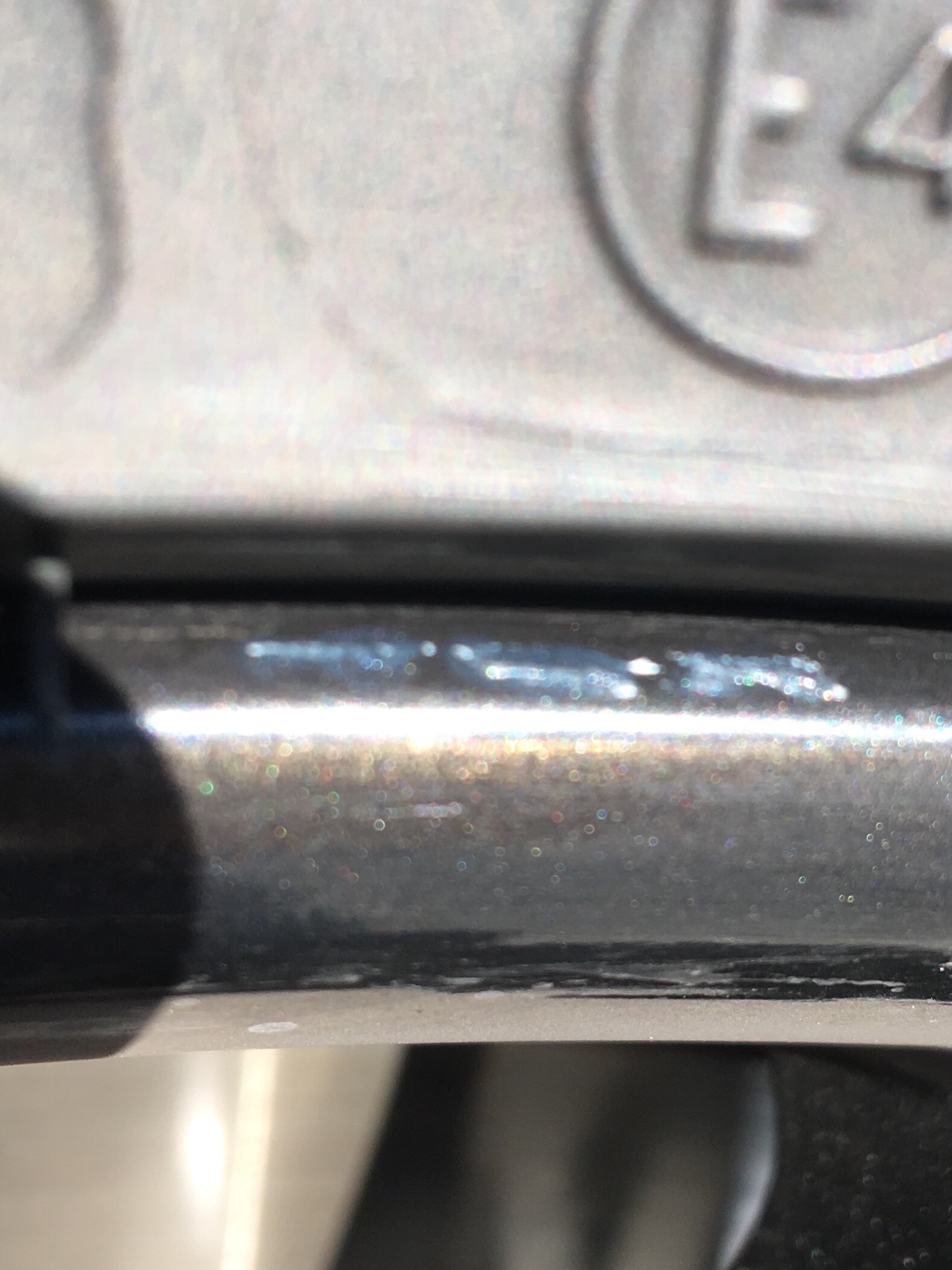

for what it’s worth, I just tried FL8 and it’s not even close, mine defo aren’t grey.  May ask to borrow some paint chips to match it
