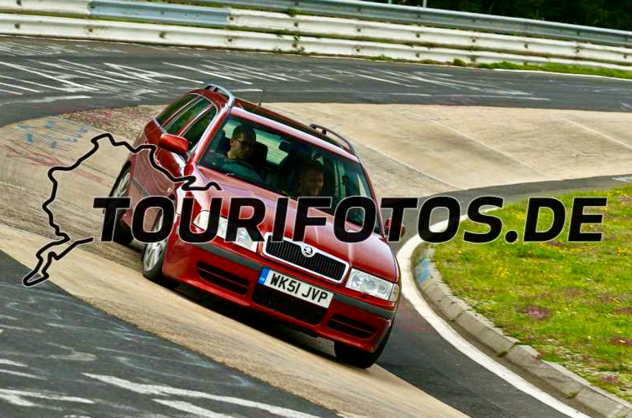

Sorry to drag up an old post but I wondered how you got on with this?  The reason I ask is I'm currently in Germany at the Nurburgring with my 4x4 and am already thinking what else I can do to it.  It's already mapped with a blue haldex controller, 312 fronts and 256 rears, R32 front ARB and springs/shocks.
How have you got on with yours?
Couple of pics of yesterday :-)
Thanks
Tom
