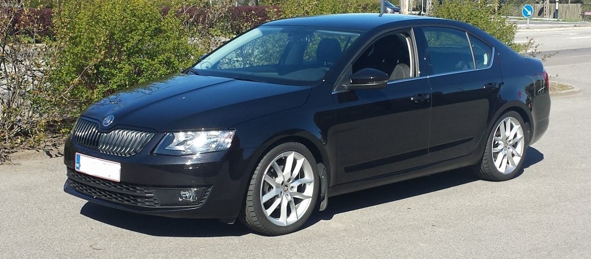

I installed HR 40mm springs on mine o3. Feels better now  :happy: And looks a lot nicer.post-110629-0-32210300-1398345986_thumb.jpg

I installed HR 40mm springs on mine o3. Feels better now  :happy: And looks a lot nicer.attachicon.gifSænket.jpg
Looks great Bellua - is that the car fitted with HR springs in the photo?  If so, any spacers used?
Yes the pic is a week old, after the HR springs were fitted. and no spacers.
