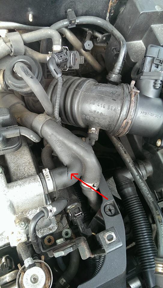

split pipe, can anyone name it?
As per title really, i took the cover off to get at the screws to replace the MAF today, and found this pipe had split. No idea what its for, can anyone tell me?

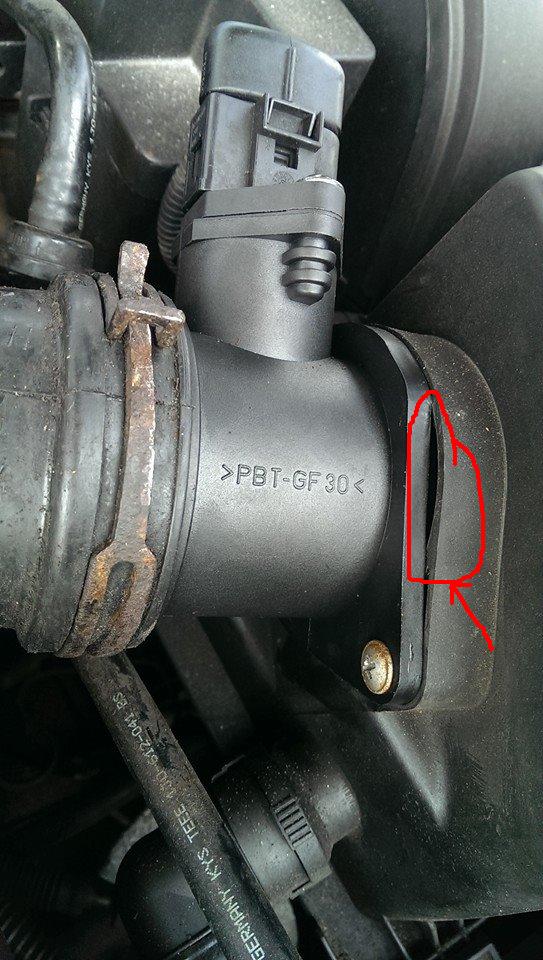

also is this gap supposed to be on the join for the maf and the edge of the air intake box?
That split pipe is part of the crankcase breather system, basically it's there so the vacuum from the engine can evacuate any oil/fuel vapour from the engine block and cylinder head, any leak in the breather system can lead to some strange running issues and/.or misfires etc.
Secondly, an air leak upstream on the mass airflow meter is not going to cause much harm, but it will allow a small portion of unfiltered air into the intake, if the leak were the other side of the airflow meter it might lead to running issues.
Thanks Tom,  so if I was to order another pipe,  what would I order? Is it better to order a complete set of various pipes and just replace them all.  It has some strange running issues which were mostly sorted by replacing the maf. So probably that will sort it all out.
A bit of tape to cover that gap should sort it I reckon
I just know that pipe as ' the y pipe ' from my experience, you're better off to get the set of silicone breather houses. Everyone 1.8t I've ever had, had one of the old hoses tear when I was doing a job! But that could just be my luck!
You're better off getting the forge kit. I put that on my gti, and will be putting it on my vrs once I get to work on it. All the pipes for replacing the old ones are about 70 pounds I think.
I just order the lower breather and the crankcase breather hose both in blue silicone from creation motorsport,  cost60 quid posted mind..... Oops,  don't tell the Mrs!
That's what I did got the kit from CM but bee careful with the plastic elbow under the manifold they go brittle and break really easy. Might be worth getting one as well.
