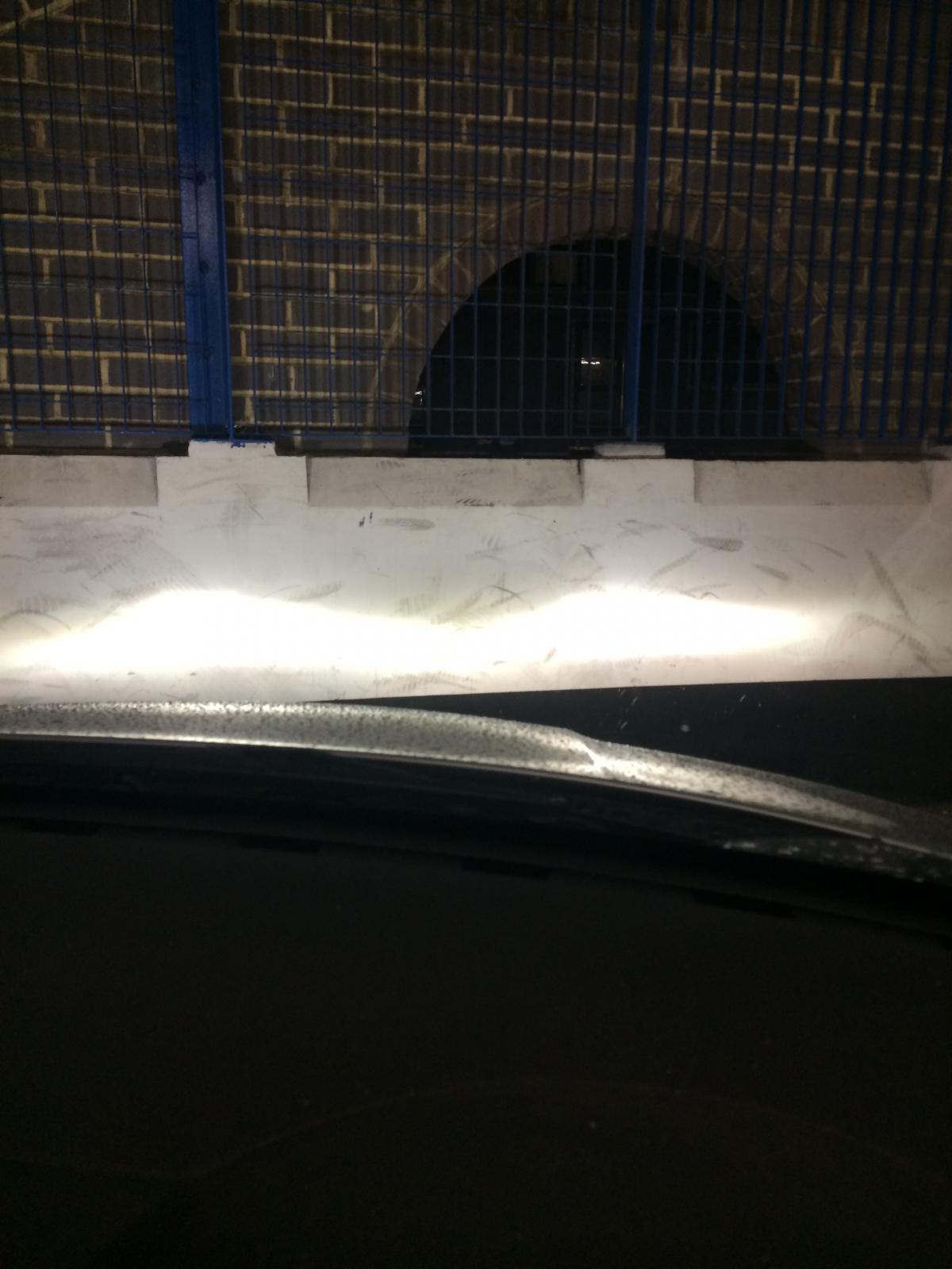

I don't see why people go mad when ever HIDs are mentioned on here! I have had mine in for ages now, and as long as they are aligned correctly, and your lenses are clean they aren't that bad. I admit there is a bit more light scatter with HIDs, but they are in the same locations as the halogen bulbs.
These are my HIDs Direct 35W 4300k bulbs, with which I have never been flashed
I'm not going mad, and I congratulate you on at least opting for 4.3k's rather than something higher, sadly that's about where it ends.
You've fitted a product that generates it's light in a pattern/shape and location that the reflector was never, ever designed for and by your own admission you're aware the beam is scattering all over but you justify this with 'I have never been flashed'. I know a man who was never convicted of car theft, still makes him a car thief. I'm a big fan of HID's, but in the correct setting and no matter how you spin it the way a filament bulb and an HID produce light is vastly different and your reflectors just aren't designed to deal with it. In projectors it's less of an issue but in reflectors it's just wrong.
