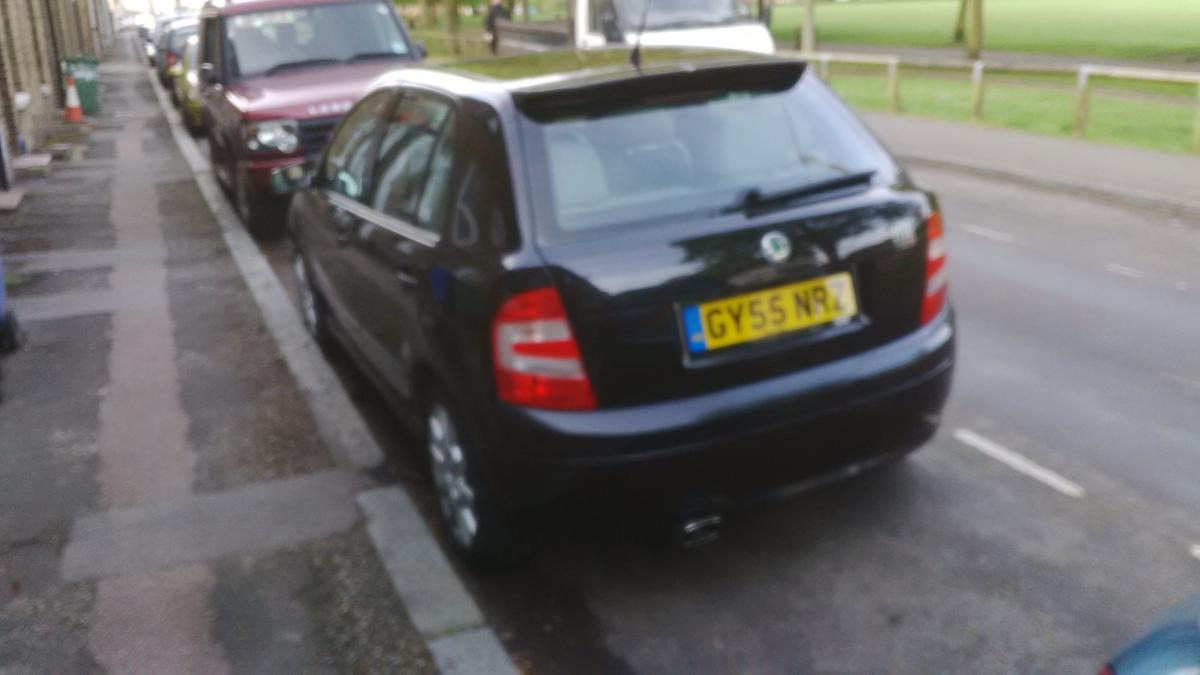

Im also wondering if I have a facelifted car or not? I know there was an engine change to blt but was this part of the facelift? I can take a pic of the boot floor sticker tonight if that helps?

You can tell if it's a facelift by the rear lights.

I think I have a facelift then!?(pic attached)

Great info! looks like I have a facelifted car with an asz engine.
yeah my ASZ engined '04 plate red car was a pre face lift
Mrs Pasty's '54 plate black car is facelifted with an ASZ engine
The BLT engine was only introduced near the end of the Fabias life to meet tougher emissions regulations - think it was '06 onwards
My 55 plate has the facelift rear lights, slanty finned grill and no door pins in the rear doors (only noticed this after reading the link above - this is also something that bugs me lol) but still has the asz engine as mentioned above :-)
