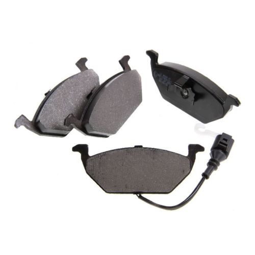

Before changinh my front pads and discs they was squealing very bad i noticed that the pads and discs was very low o i replaced the lot with new but after changing the front pads and discs i still have the squealing but what i find wired is that the new pads dont have a curve at the bottom its just a straight line but ive been told there the right pads for the discs ive added a pic of the pads

i took the pads back to the shop the guy said it could be the pads so he exchanged them for  a diffent set witch is chamferd edge but its still no change its still squealing

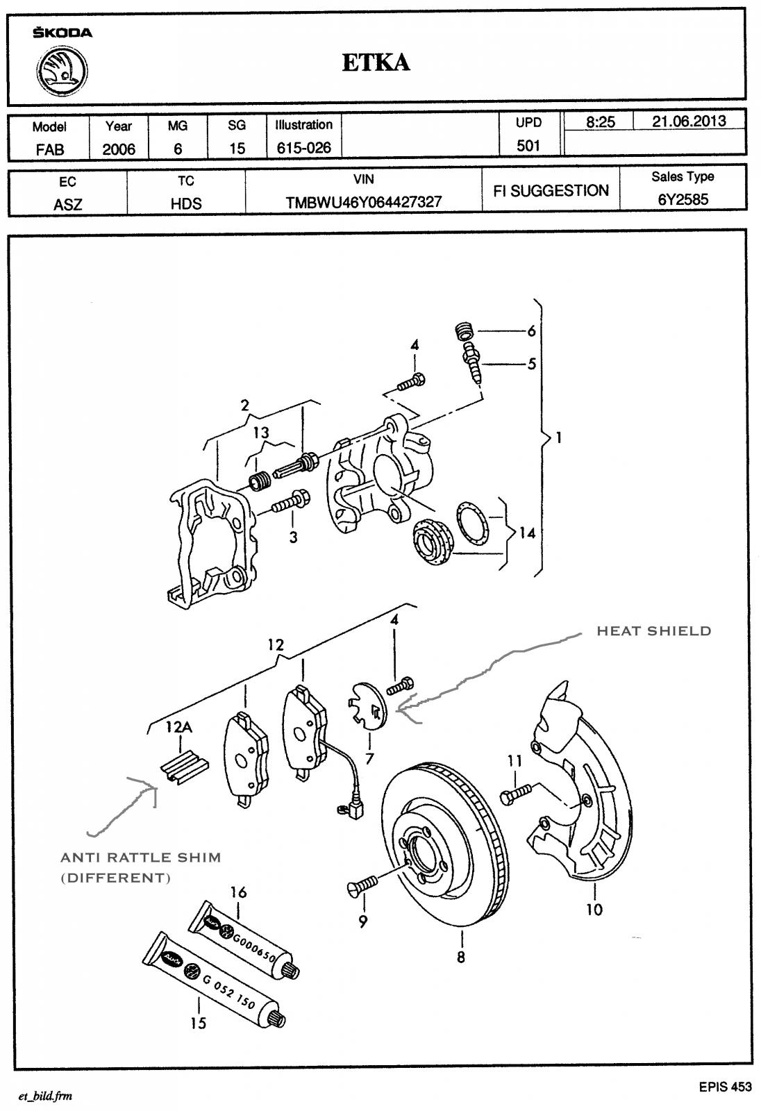

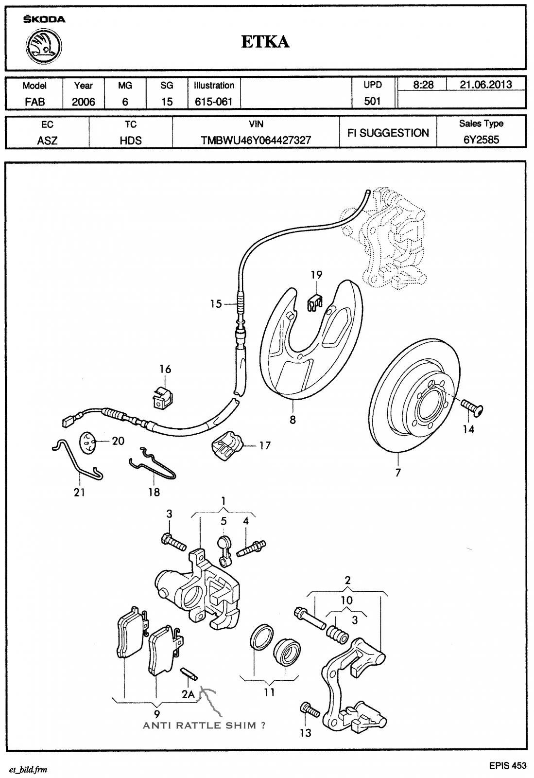

Diagram of front & rear if any good, thats fitted to my 2005 Fabia VRS..
