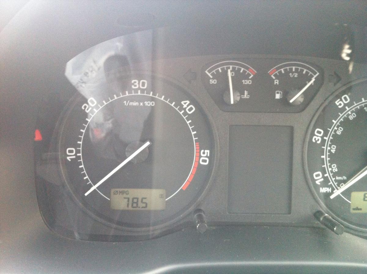

Something is definitely wrong if 45 on the motorway is your highest. Same engine and over 30 ish miles I got..

Well mine was either the downpipe, turbo, smic or the map sensor. All have been changed and I'm where I feel I should be, albeit I'm running a little more power.
