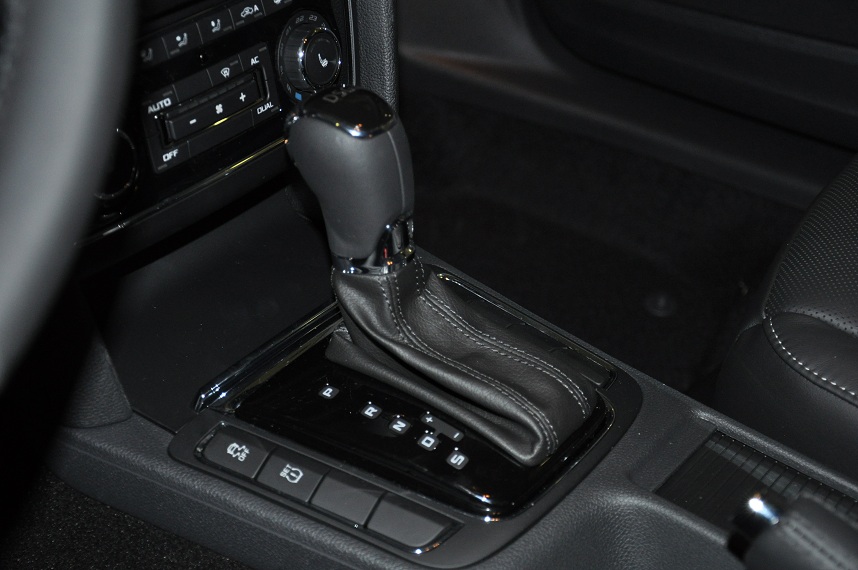

And now, due to popular demand, the most exciting and innovative mod to my Superb!
*drumroll*
After Enriquez (who else :rock: ) showed me his knob (not that one) I knew I had to have one that looked just like his (what?) For you comparison-freaks, the smaller one is the Facelift gearknob. I did the same mod in my Octavia II, I retrofitted the O2 FL gearknob. It was remarkable how such a stupid tiny mod transformed the car. You never look at your knob (or do we?) but you feel it all the time (allright settle down!) and for about a month it felt like a completely new car.
As you can see on the middle picture, my old knob had a scratch. Top tip; If you plan on removing your Columbus to plug in the reversing camera, remove it completely and don't balance it on the gearstick... I was also not a big fan of the seam visible in picture 3, lots of dirt found it's way there.
So, open the ashtray, pry along the chrome edge of the black baseplate (the ENTIRE black baseplate including the buttons pops out) as soon as you get it to lift, wiggle a finger underneath and the gearstick gaiter frame pops loose. They are separate, so in theory you could use a thin plastic trim removal tool, and try to remove the gearstick gaiter from without moving the baseplate. The risks of sticking something sharp between the leather gaiter and the frame should be clear though.
Anywho, the gearstickgaiter is attached around the round gearstick with 4 plastic tabs, pinched together with the ****** metal ring of doom. A small needle-nosed pliers can be used to open the ****** metal ring of doom sufficiently to slip it over the tabs, and off comes your knob. Refit the new one, but instead of the ****** metal ring of doom, use a ziptie to hold it in place. Et voila, enjoy your brand new motor!
Partnumber is 3T0 711 113 AB or AD. Mind damaged ones, they can be had on the 'bay for the princely sum of 20€, or the ridiculous amount of 99€'s, so shop around.
To finish off the story of my knob, here's the old one including the ****** metal ring of room.

Ah Crisss but you cheated, that's the pre-FL DSG knob I believe  :rock:
I love it. :rock:
new knobs they mounted with MY2013 models, also pre-FL :D
