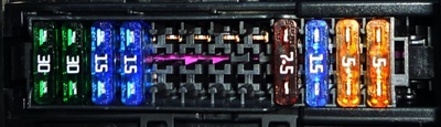

Have a look at your fuse box. you will be looking for a spare fuse position with a metal contact on one side ( see if it has 12 volts when the ignition is on (not permanent live)). See pic. you can get connectors to insert from the back of the fuse box from Vehicle wiring products.
