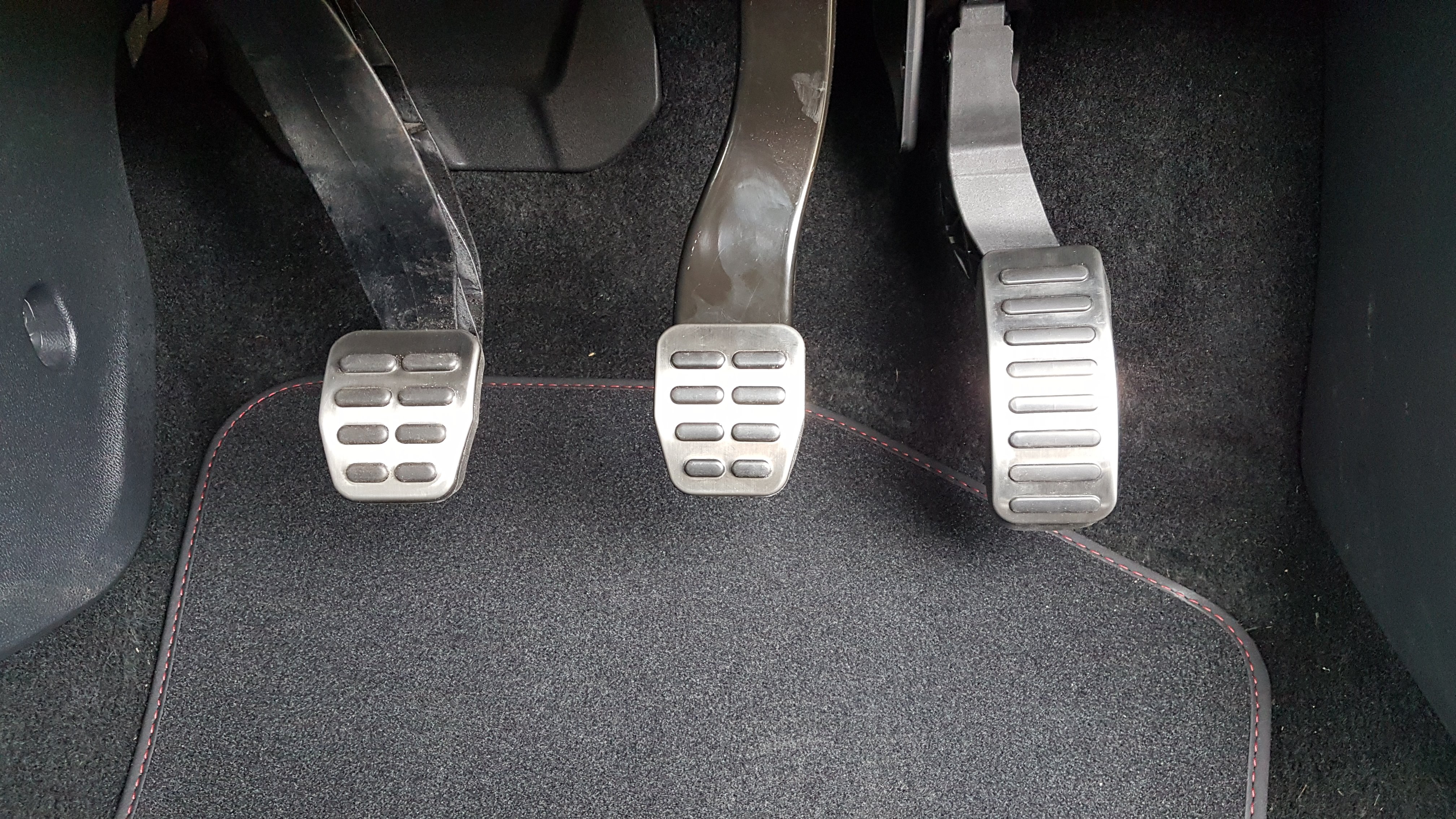

Bumping this back up as I looked into getting these sports pedal for my Go.
Took a chance on eBay and purchased a set 8N1064200 for only £32 which I thought was pretty good value.
Came from a VW dealership and included instructions and all.
Clutch and accelerator pedals were pretty straight forward to fit.
Clutch take off the original rubber and put the new one on.
Accelerator slip the new one over the current one.
Brake- this is where I had a bit of trouble as I couldn't get the original rubber cover off due to the raised 'points as pictured already.
Will give it another go tomorrow as I ran out of time.
I didn't want to use brute force in case I break the original rubber cover but if I have to then no issue.
Managed to get the brake one off and new one in
