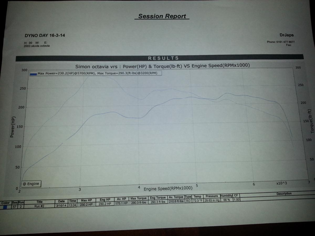

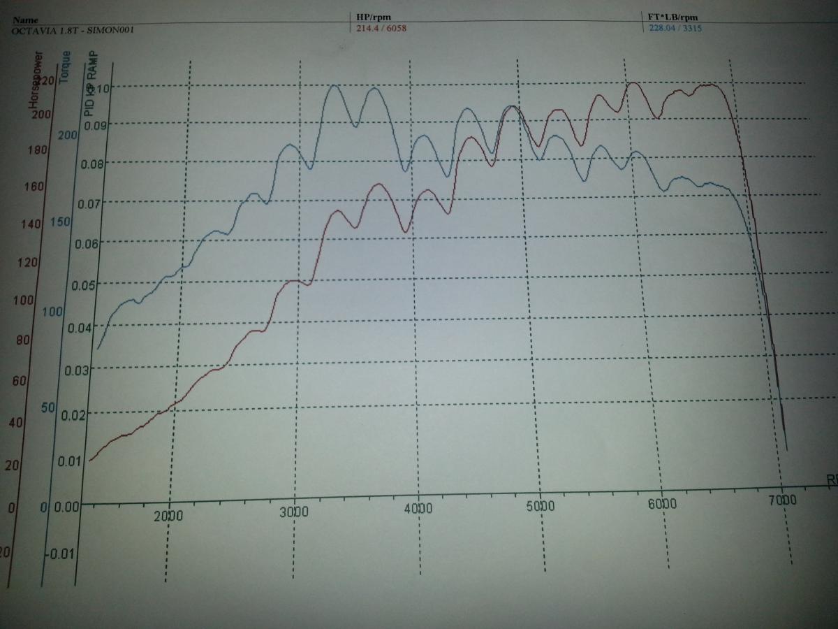

had my car rolling roaded twice within two weeks of each other at two different places.
the second graph was done on a 2 month old rolling road
my problem is the difference in power out puts and the serveraty of the graphs.
looks like a bloody heart beat!

I'd be pretty happy with the figures from the second power run!
The numbers on the first graph, are they wheels figures? It looks like a very sensitive set of rollers that shows up all the lumps and bumps. It is also a characteristic of the standard mapping in that it "pulses". You don't feel it on the road as such but a power run showing data without much smoothing will show it up. Mapping companies that really know the standard ECU (R-tech, Shark etc.) can map this out. Think it is called "torque intervention". Tonnes on Google.
Also, what rolling road hardware and software was used in both cases? The first printout looks similar to the setup at R-tech. What gear was used and how did they pick up the rpm reading?

I'm assuming the second sheet is Dr Japs/Dr Remaps? I'd be believing their sheet.
Their equipment and the guys are great, they had my Scimitar on it a couple of months ago.
it is the dr japs in stockport. they are really good.
