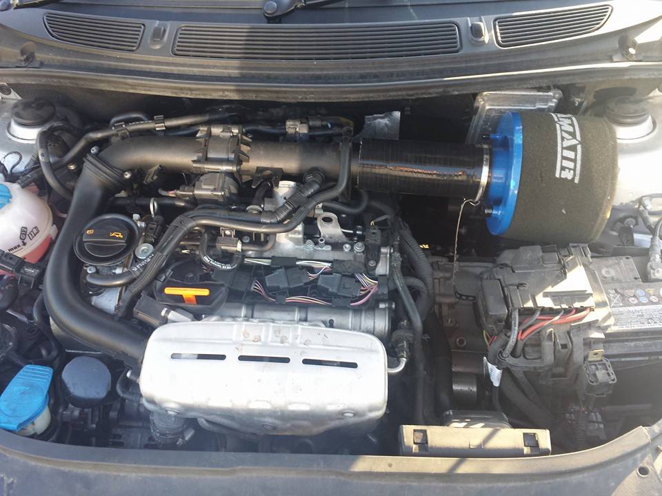

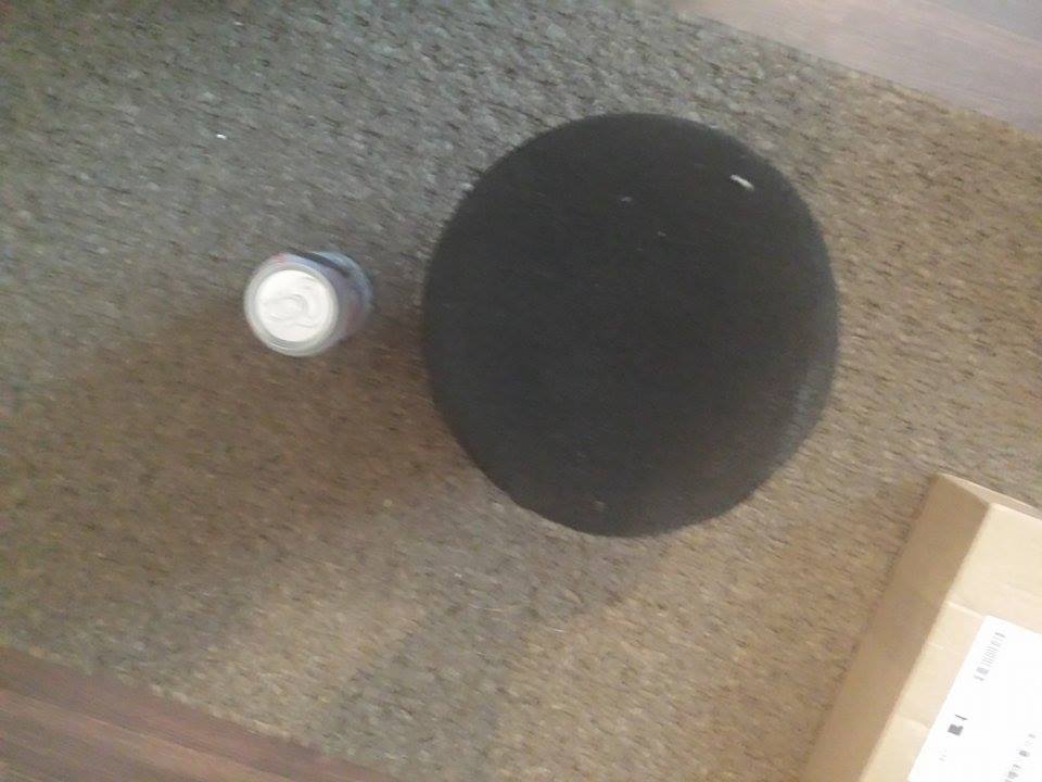

got this going in at the weekend if the parts i need turn up.
i received my barbed nylon connectors for the breather hose yesterday, just waiting on a reducer and some jubilee clips..
then some final tweaks and come cutting and it should be done :) standard air feed will be going back in also. its tight though as the filter is huge
Edited by matthewl
I might have a small concern over the temps our engine bay hits and having an open filter like that.
That said, this is an area few have experimented with so should be interesting to see how you get on.

That should De-tune the car nicely,
about 40 *0C plus behind the Battery on a warm sunny day.
That said though George, if you look at the design of the standard filter routing and the front slam panel, it doesn't inspire confidence that it would breathe all that welll either.
I think as is being suggested you need to consider the impact of heat soak.
I had my oil temps close to 130 degrees on track on a mixed weather day at Castle Combe.  It was a trick not to burn myself opening the bonnet inbetween sessions.
I have measured the temps in the standard Air Box, the Inlet, and a variety of inlets.
The position of post #19 is as poor as it gets,  Cold Air Feed required and some shielding.
Have a fast run, stop in the heat, bonnet stays closed, a nice sunny day,
restart the car and it takes some nice hot air in for a bit, it has the sensors having a hairy for a short while
This is a very low tech tuning aid, but handy to measure under bonnet temps.
£3.15 expenditure or so.
mathewl.,
youre right this is a new area, until somebody gives it a go, nobody knows and we will continue buying over priced enclosed systems....
i see no issues with this in my opinion, many cars run open filters, this is whats used in every car scene. If it were that bad, would drift cars (which get no airflow while sideways) run intakes like this, from a performance point of view, no.
end of the day ive put it in a high pressure area at the back of the engine bay, this should be fine.
This isnt NA tuning where heatsoak plays a huge role(10oc = 1hp), think about it, the air you suck in goes through a turbo and heated then through a supercharger then through a piddly intercooler, which is just a heatsink...
this so far hasnt cost me much, so if it doesnt work, no worries. i have confidence though.
Edited by matthewl
