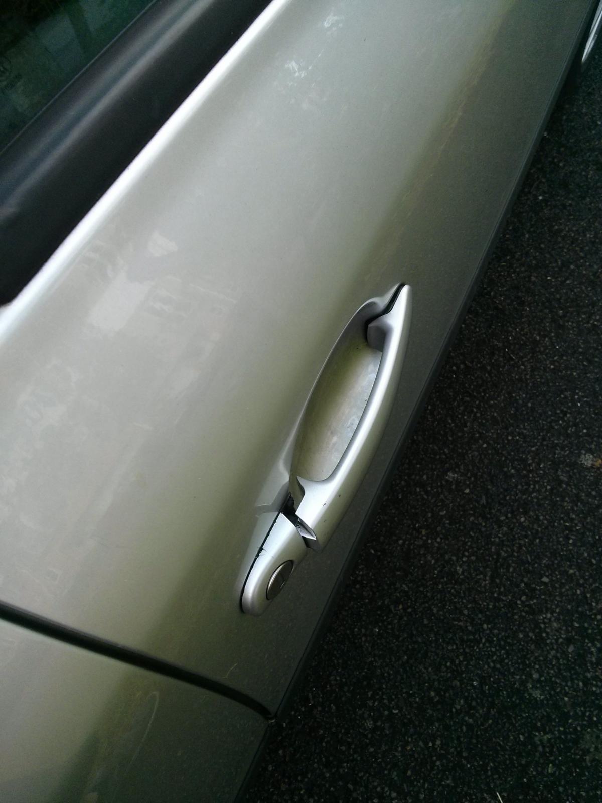

I have battered my fingers trying to sort out my central locking problem, and success, that now works.

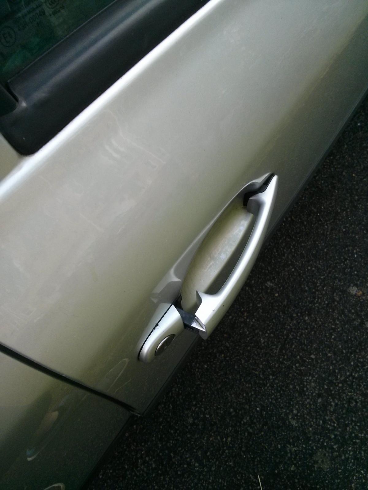

However, my door handle now doesn't sit flush with the door. It sits proud as in the first photo. When I use it, it sticks open, as in the second.
Please tell me it's an easy fix and not something expensive and awful.
I think your Bowden cable's not in the right notch mate.
It lined up with the mark I made... presuming that is the little bit that sits in the threaded groove?
When I put it back together... the handle didn't see free even before I reconnected the cable to it.
