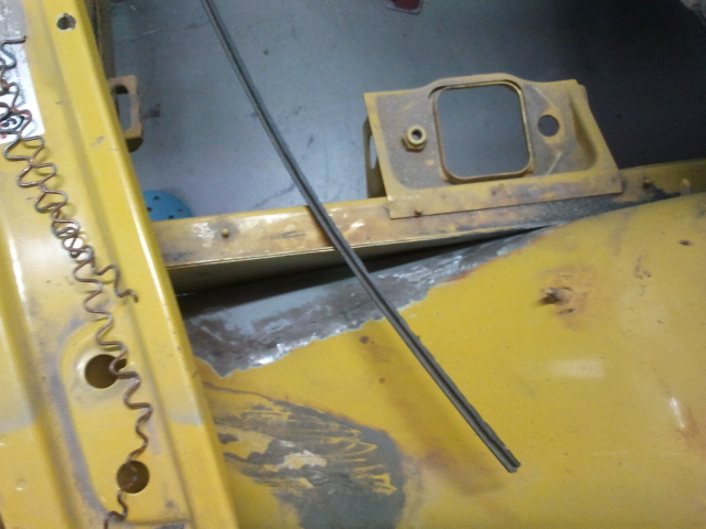

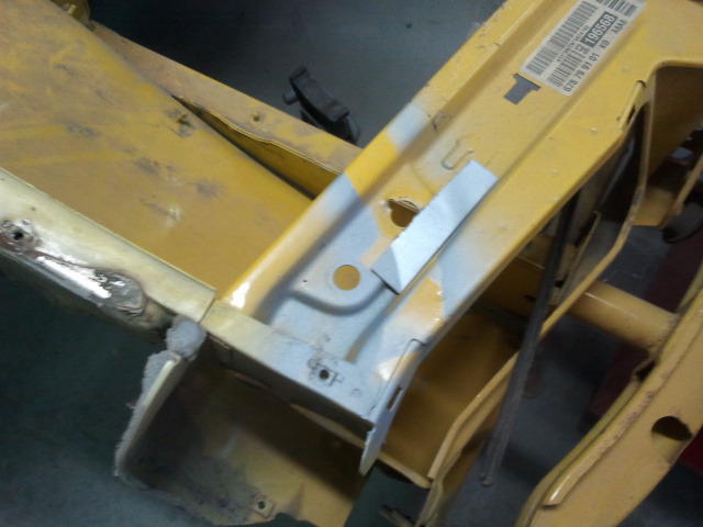

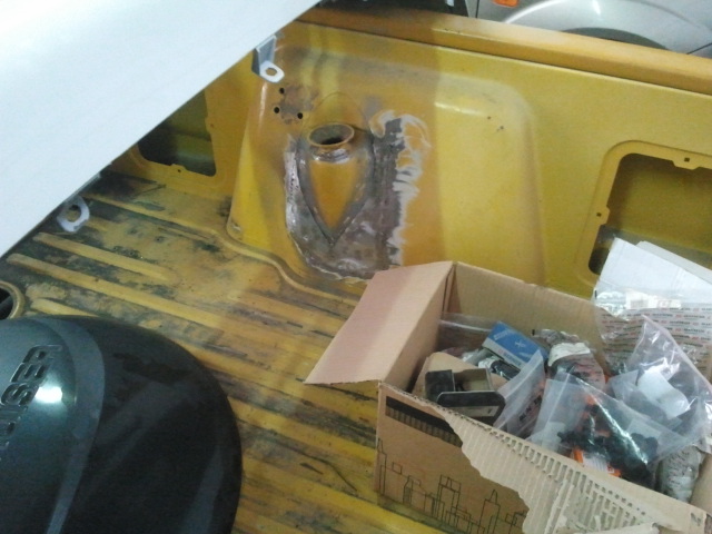

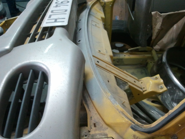

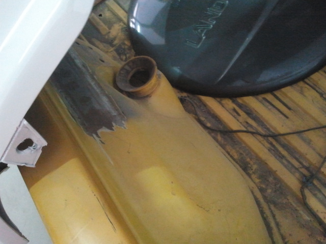

Hello: news about the patient.post-117156-0-16048400-1454516135_thumb.jpgpost-117156-0-53299400-1454516181_thumb.jpgpost-117156-0-52177400-1454516215_thumb.jpgpost-117156-0-27186500-1454516236_thumb.jpg I write from my mobil, this is a experiment sorry for any inconvenience.
