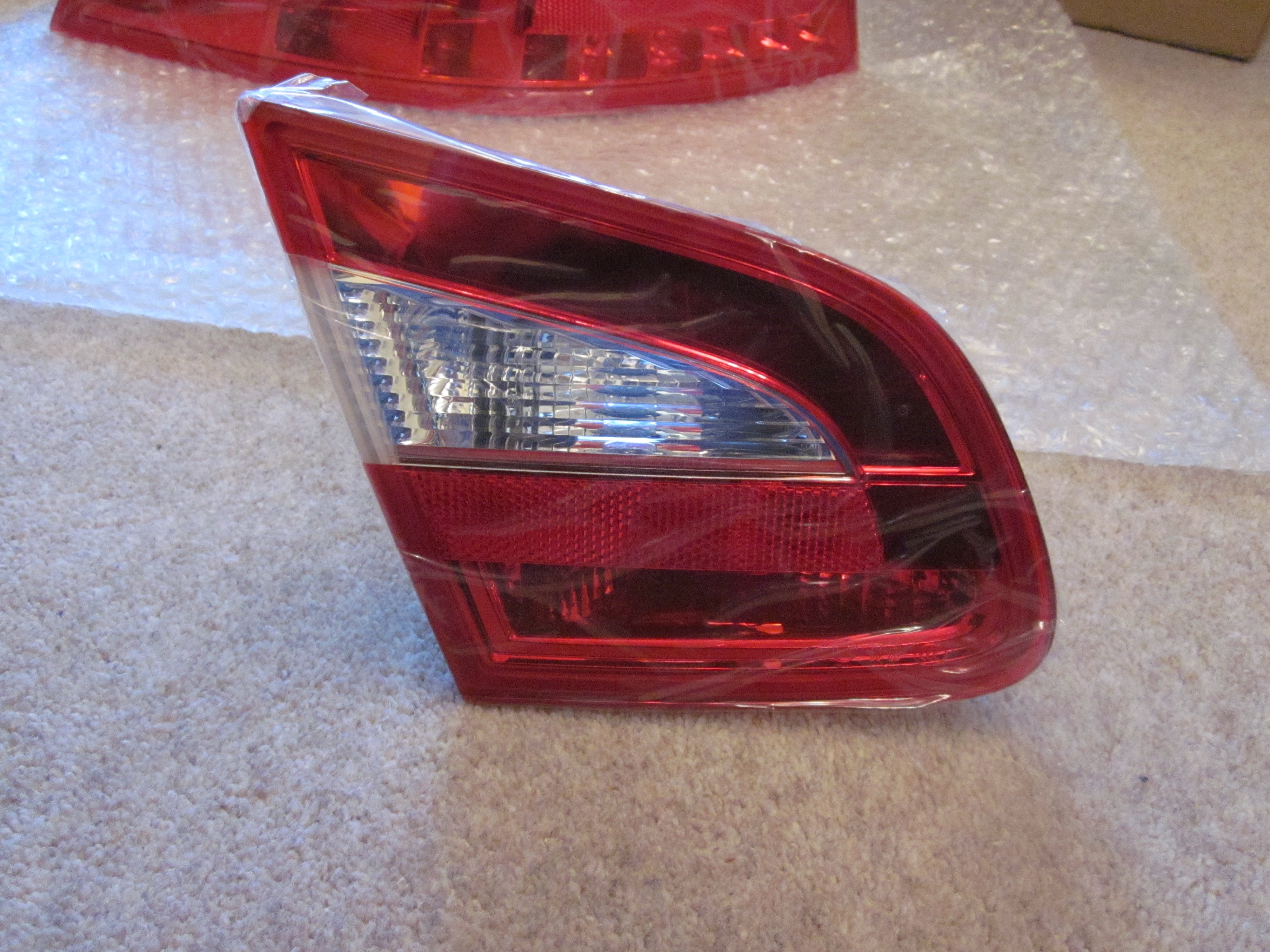

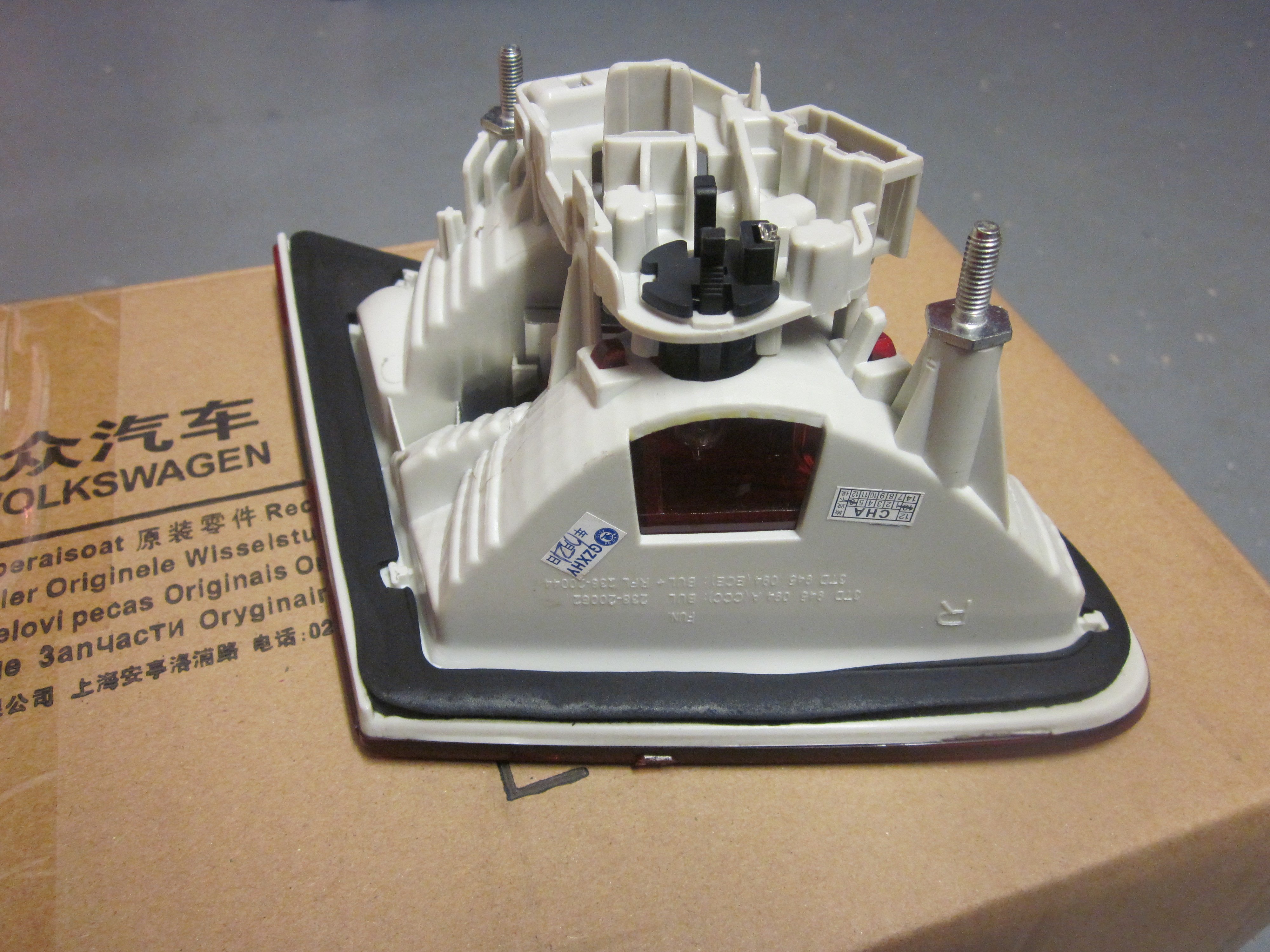

Guide to retro-fitting the LED rear light clusters from the MkII pre-facelift Laurin & Klement Skoda Superb Twindoor to a standard non-LED Twindoor Superb.
CHECK LIST:
1x 3TD945095 (near side (left) outer cluster) - £130.00 inc. VAT
1x 3TD945096 (off side (right) outer cluster) - £130.00 inc. VAT
1x 3TD945093 (near side (left) inner cluster) - £60.00 inc. VAT
1x 3TD945094 (off side (right) inner cluster) - £60.00 inc. VAT
4x 50W 6Ohm automotive (non ceramic) resistors - £5.00 each inc. VAT (UK produced high quality resistors, don’t buy cheap Chinese versions).

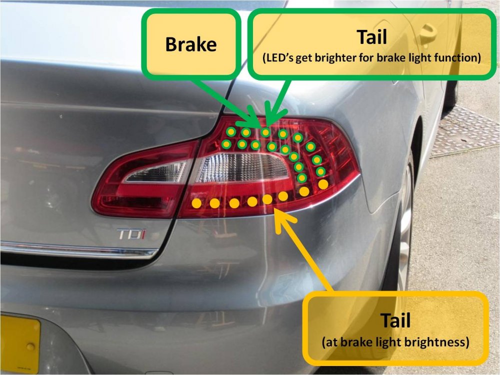

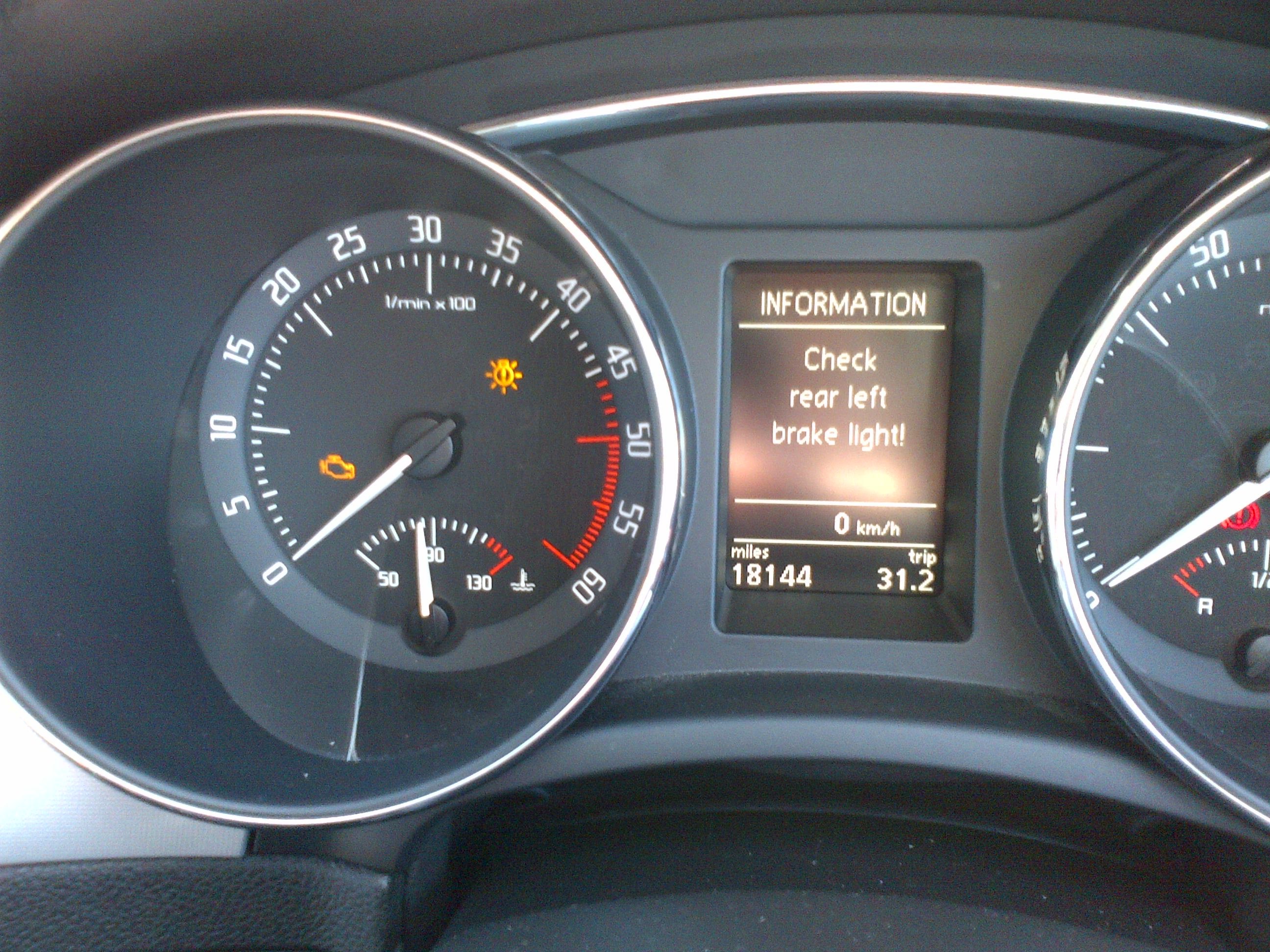

 NOTE: The lights are plug and play out of the box in that they will operate as normal.
However you will then trigger the blown-bulb warning on the dashboard due to the lower current draw of the LED’s.
To prevent this you will need to increase the current draw to fool the CANBUS into thinking that normal incandescent bulbs are fitted. To do this you will need to use one resistor for each LED function. One for the tail lights and one for the brake lights so two resistors for each light cluster.

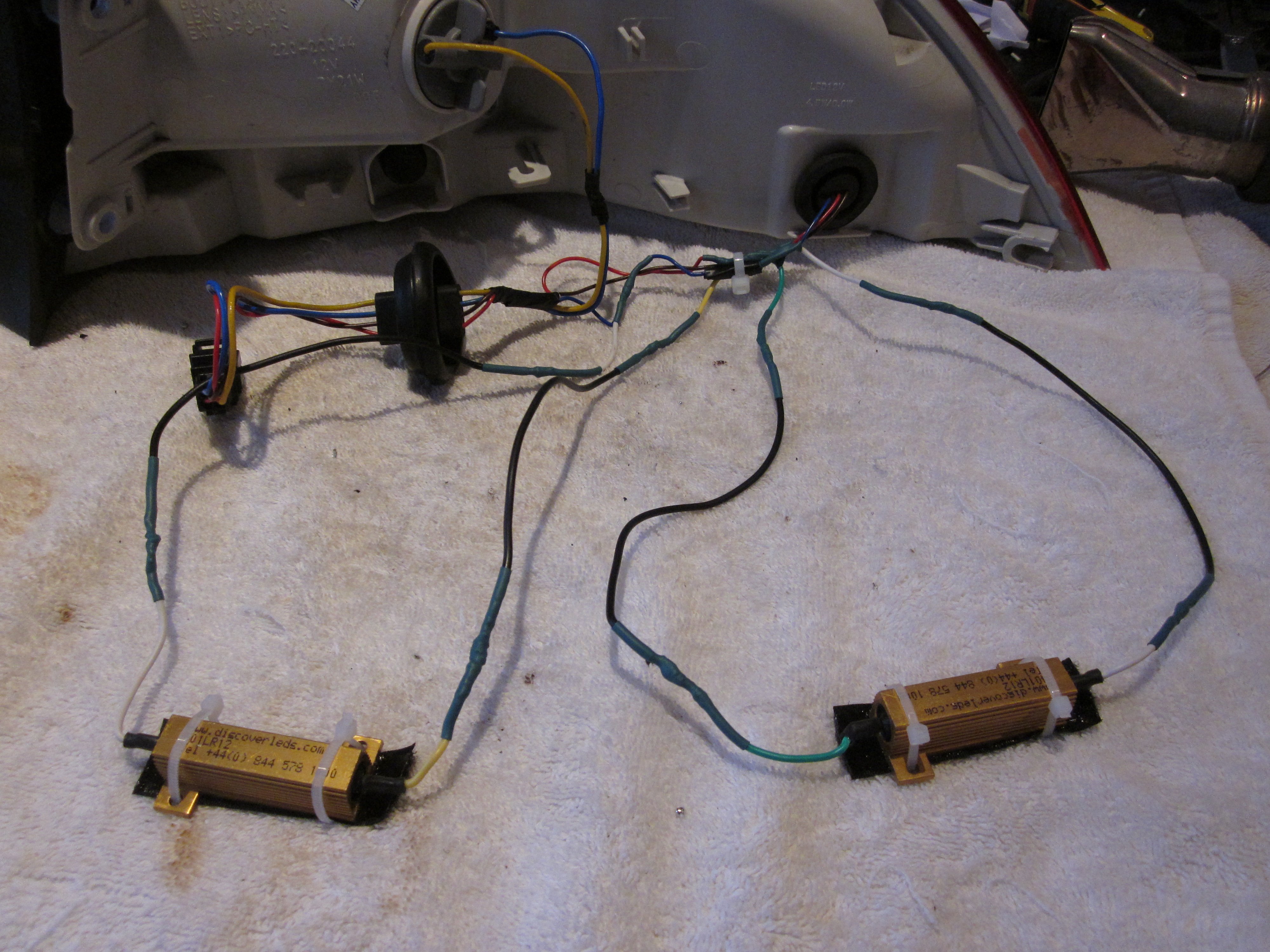

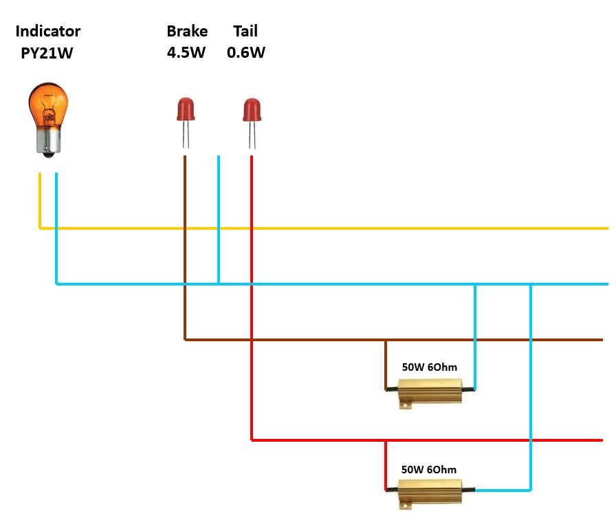

Wiring diagram:
 One end of each resistor to negative (blue).
 The other end of one resistor to the tail light feed (red).
 The other end of the second resistor to the brake light feed (brown):
Resistors added, clusters now ready to fit…

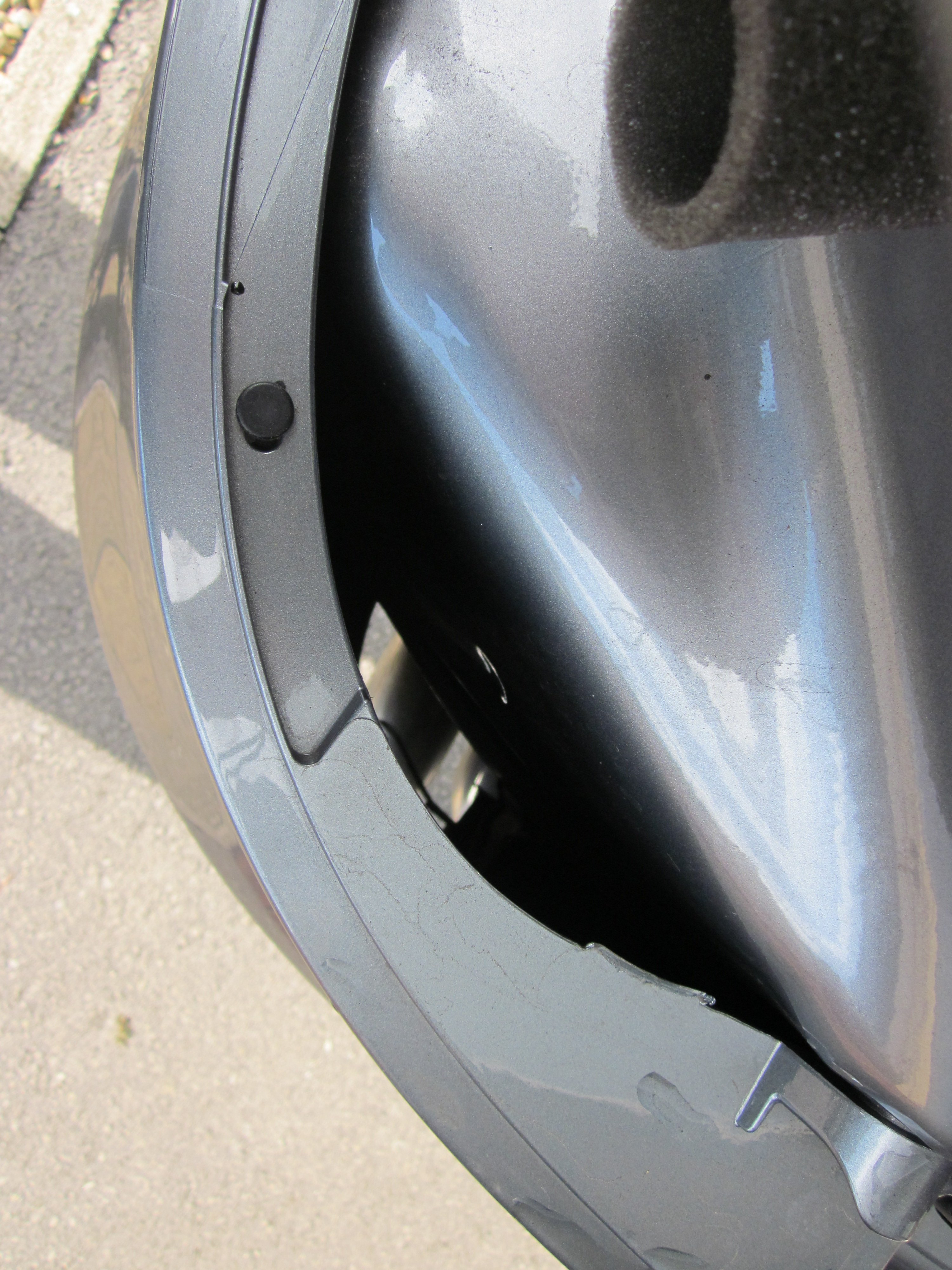

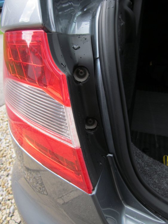

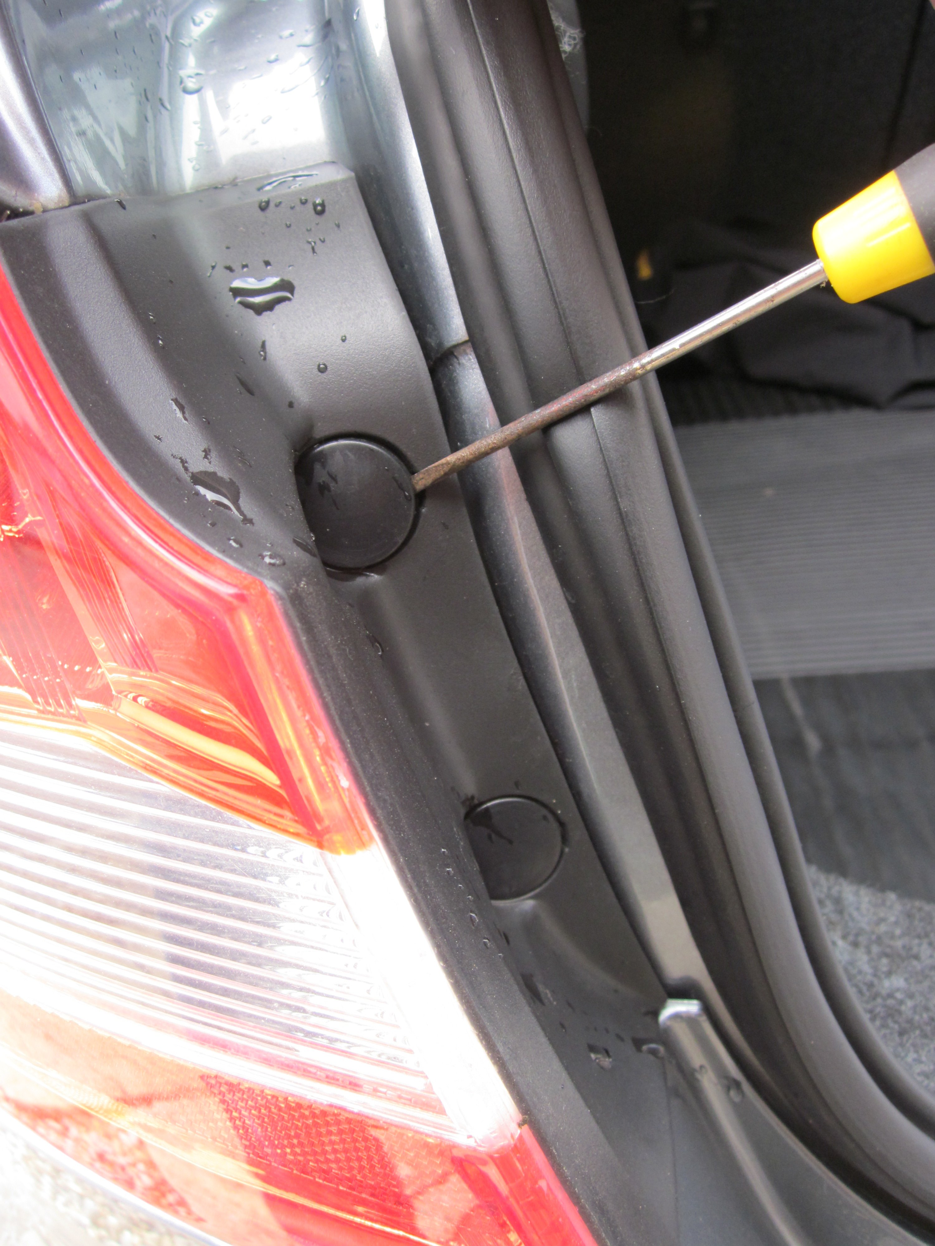

STEP 2: Take a small flat ended (slotted) screwdriver and lever off the 2x black plastic caps that cover the screws.
NOTE: There are two small indentations on each cap (at 3 o’clock & 9 o’clock) to help locate the screwdriver or levering tool. These caps are held in place with two small lugs which are easily damaged. If one or both of the lugs are broken the caps will not sit securely in the hole and will need to be replaced.

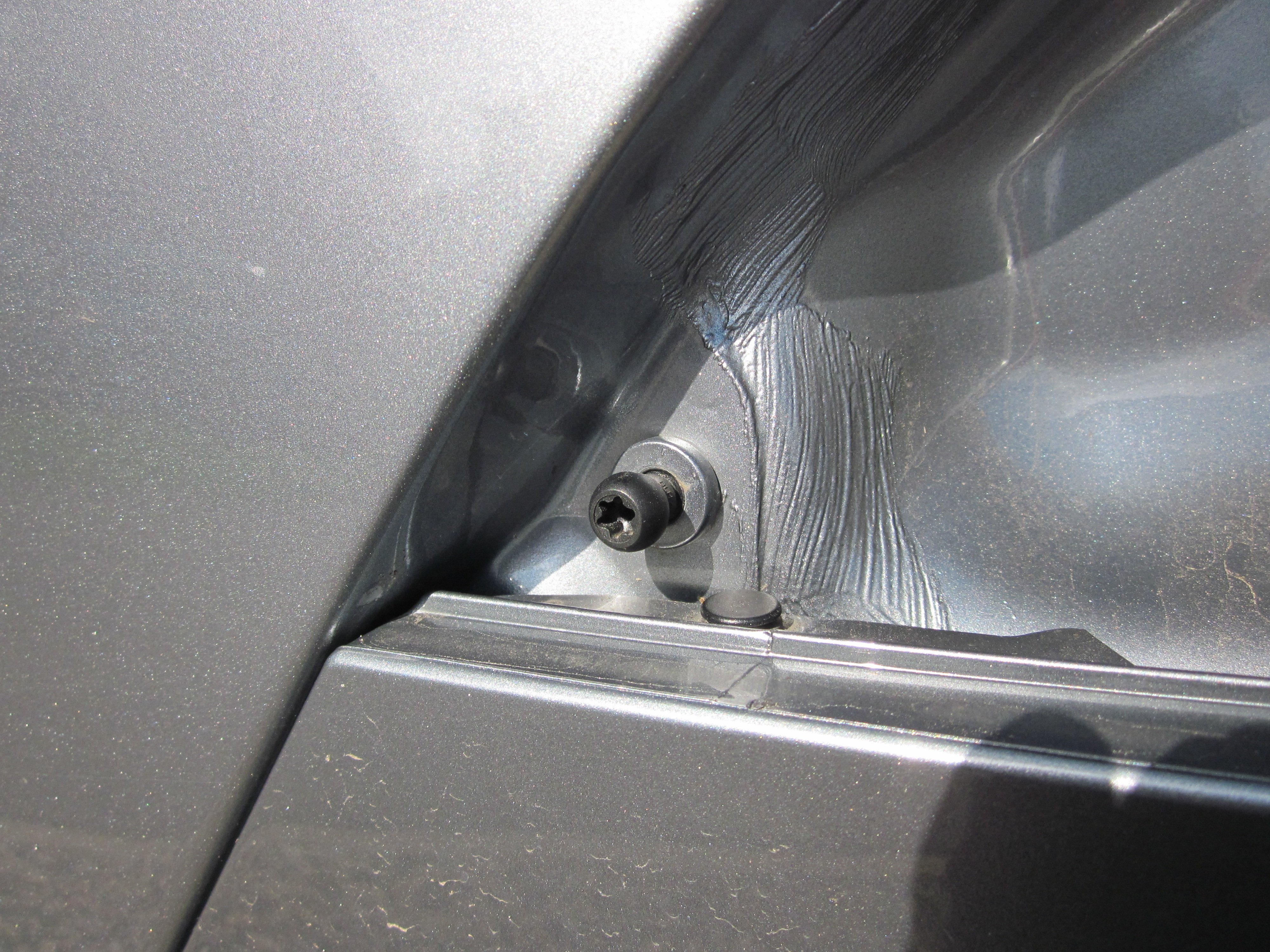

STEP 3: Using a T20 (Torx) bit remove the two screws. These are the only screws holding the light cluster to the car so be careful that the cluster does not fall out when they are removed.
NOTE: Be sure not to let the screws fall out as there is a gap behind the rear bumper that they could fall into.

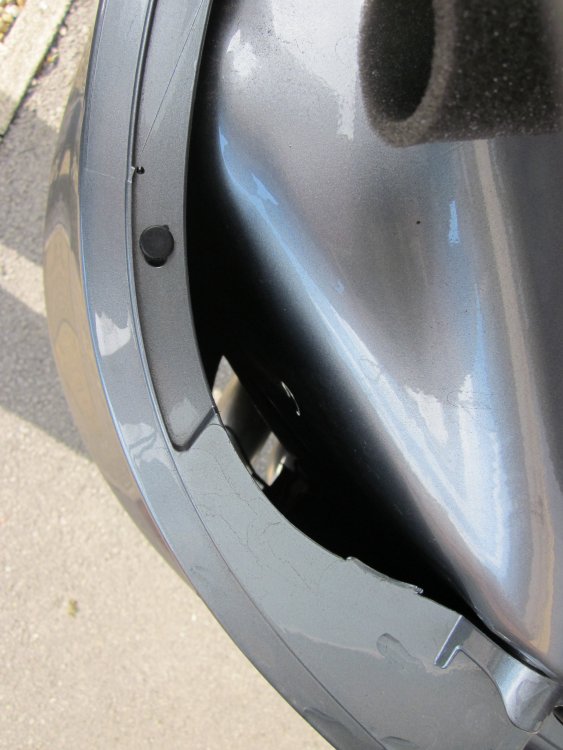

STEP 4: Placing one hand here (1) and using your fingernail here (2) pull the cluster back towards you away from the car. There is a locating lug close to point (2) which due to the build up of dirt can be quite tough to release, wiggling the cluster very slightly should release its grip.
NOTE: At this point the cluster will still be attached to the car via the electrical wiring loom so don’t expect to be able to remove the cluster completely.
1261895369_SkodaSuperbLEDTailLights(7).thumb.JPG.f299bdfa2e44bae7b1644dfe4042d752.JPG

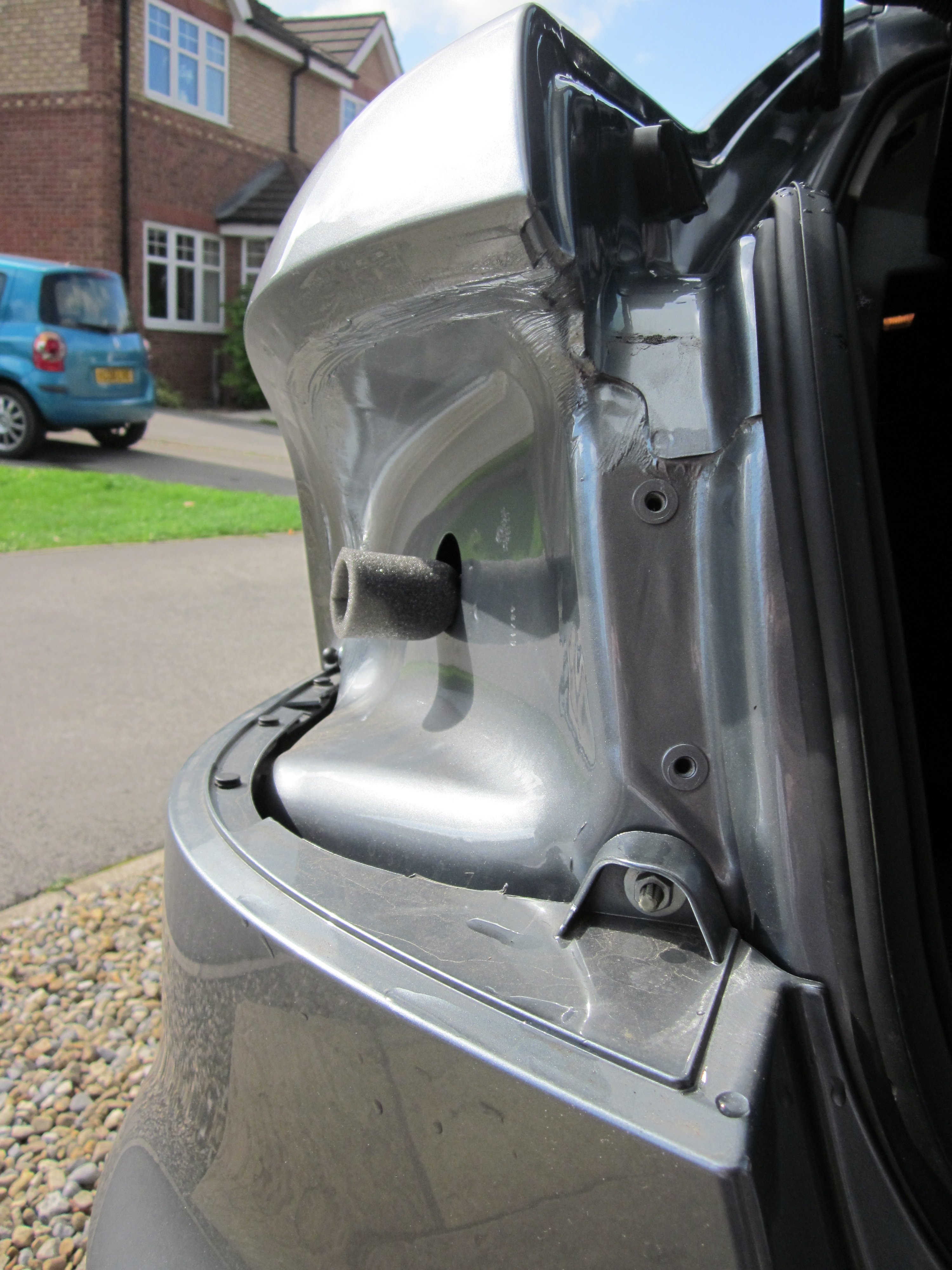

NOTE: At this point I recommend placing a towel or cloth over the upper edge of the bumper. The cluster will move whilst attempting to disconnect the electrical connector and may scratch the paint whilst you are trying to hold it steady (most likely with your knee!).

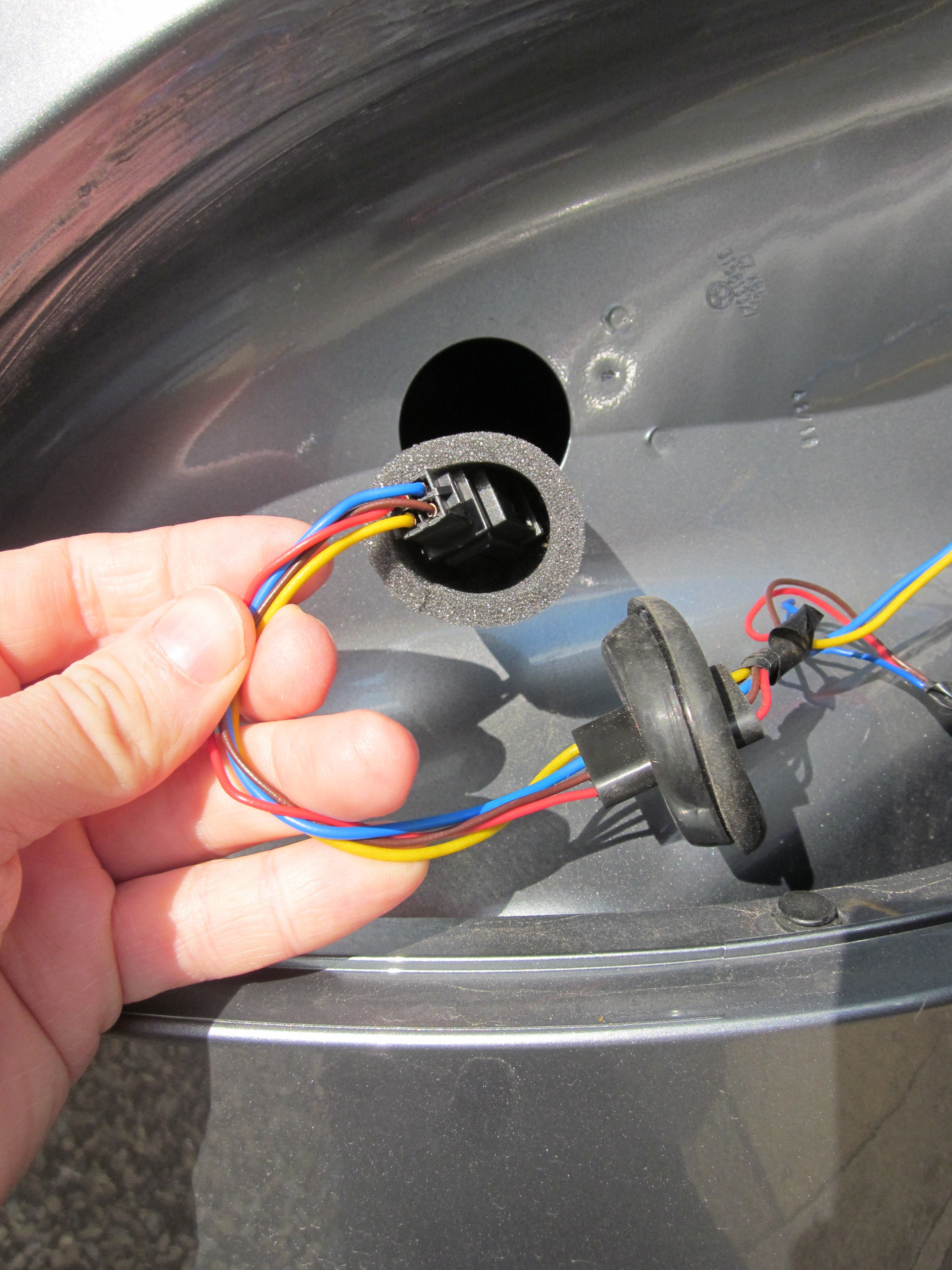

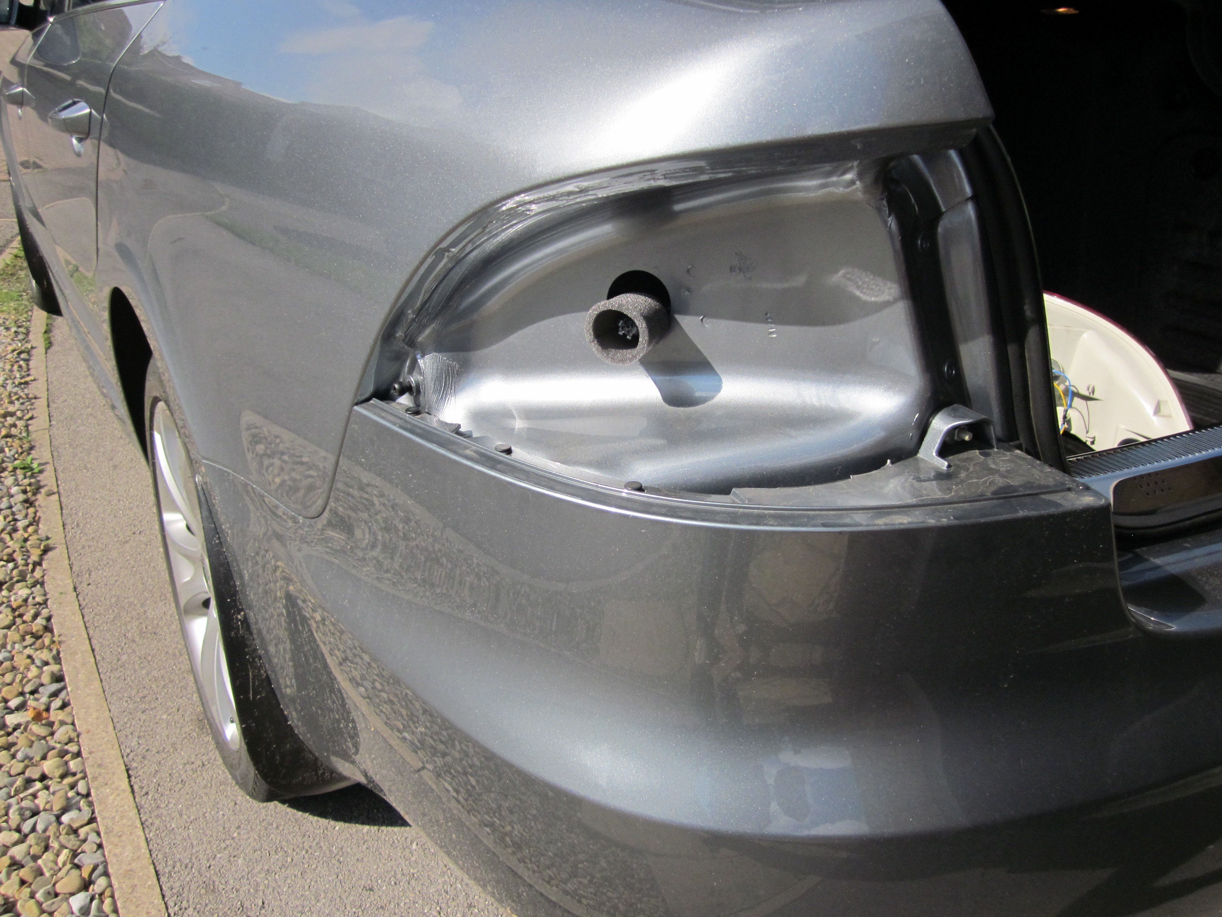

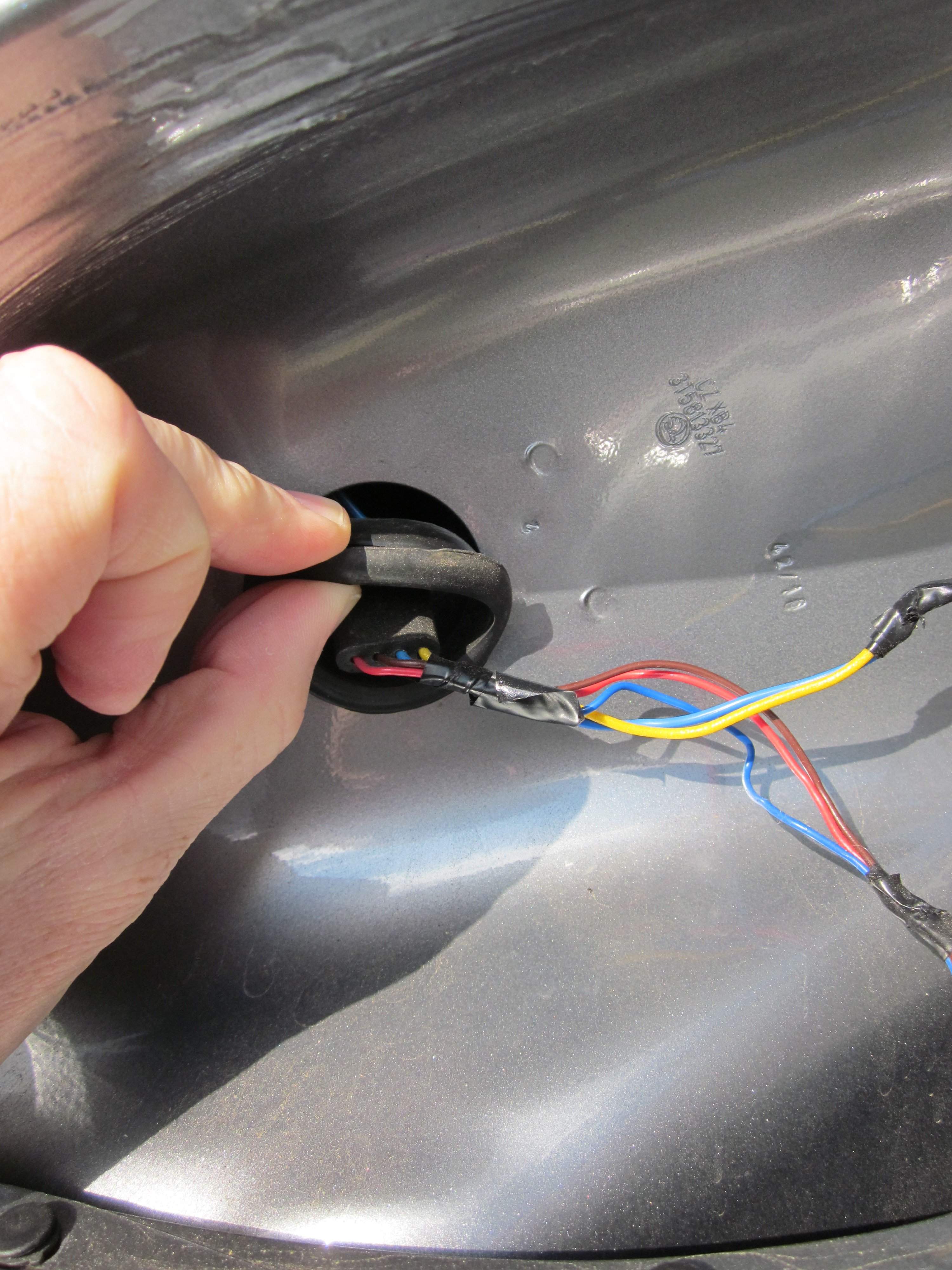

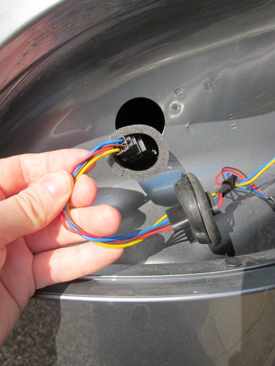

STEP 5: Using your fingernails prise away the rubber seal from the body of the car where the wiring loom passes into the boot area. Once you have released it enough to get a full finger behind it you should be able to pull it off easily. Be careful not to split the seal as this forms the watertight barrier between the outside and inside of the car.
621758987_SkodaSuperbLEDTailLights(10).thumb.JPG.1948d3c6fe25c8e6cfd39ab9ee384a59.JPG
STEP 6: Once the rubber seal is released you will be able to feed out the rest of the wiring from inside the body of the car. The electrical connector is covered in a protective foam material to prevent it making contact with the metal body of the car. This will need to be gently peeled back to expose the electrical connector.
STEP 7: Press the two small lugs on either side of the electrical connector to release the light cluster end of the connector (male) from the cars wiring loom end of the connector (female).
373255872_SkodaSuperbLEDTailLights(19).thumb.JPG.b0672dab2bf23f6aca3fbcb21ead7048.JPG
NOTE: Be careful not to let the female end of the connector still attached to the car fall down inside the hole where the rubber seal once was.
 1585625010_SkodaSuperbLEDTailLights(12).thumb.JPG.be13983a18746774046b23a398b9d9f3.JPG

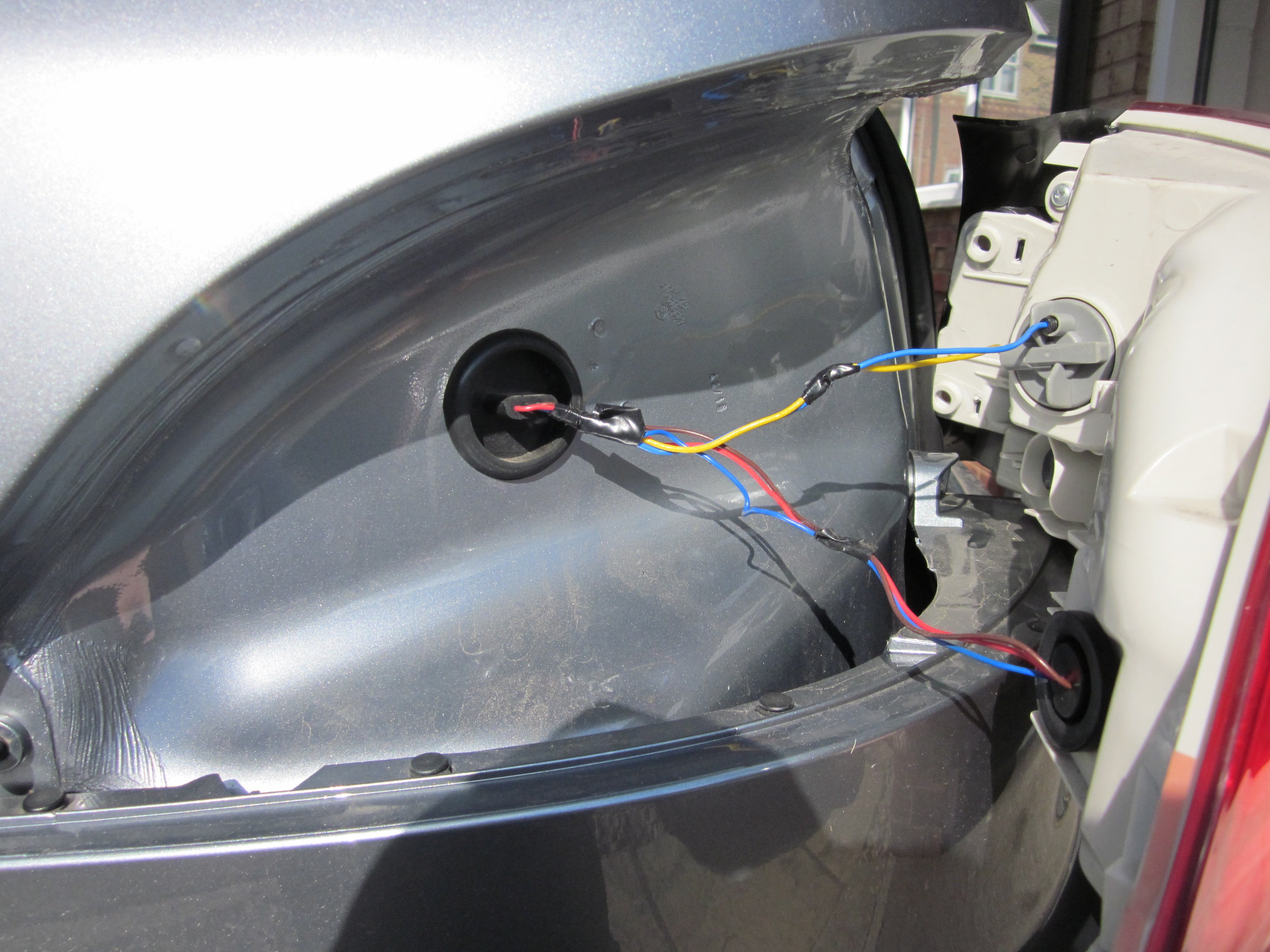

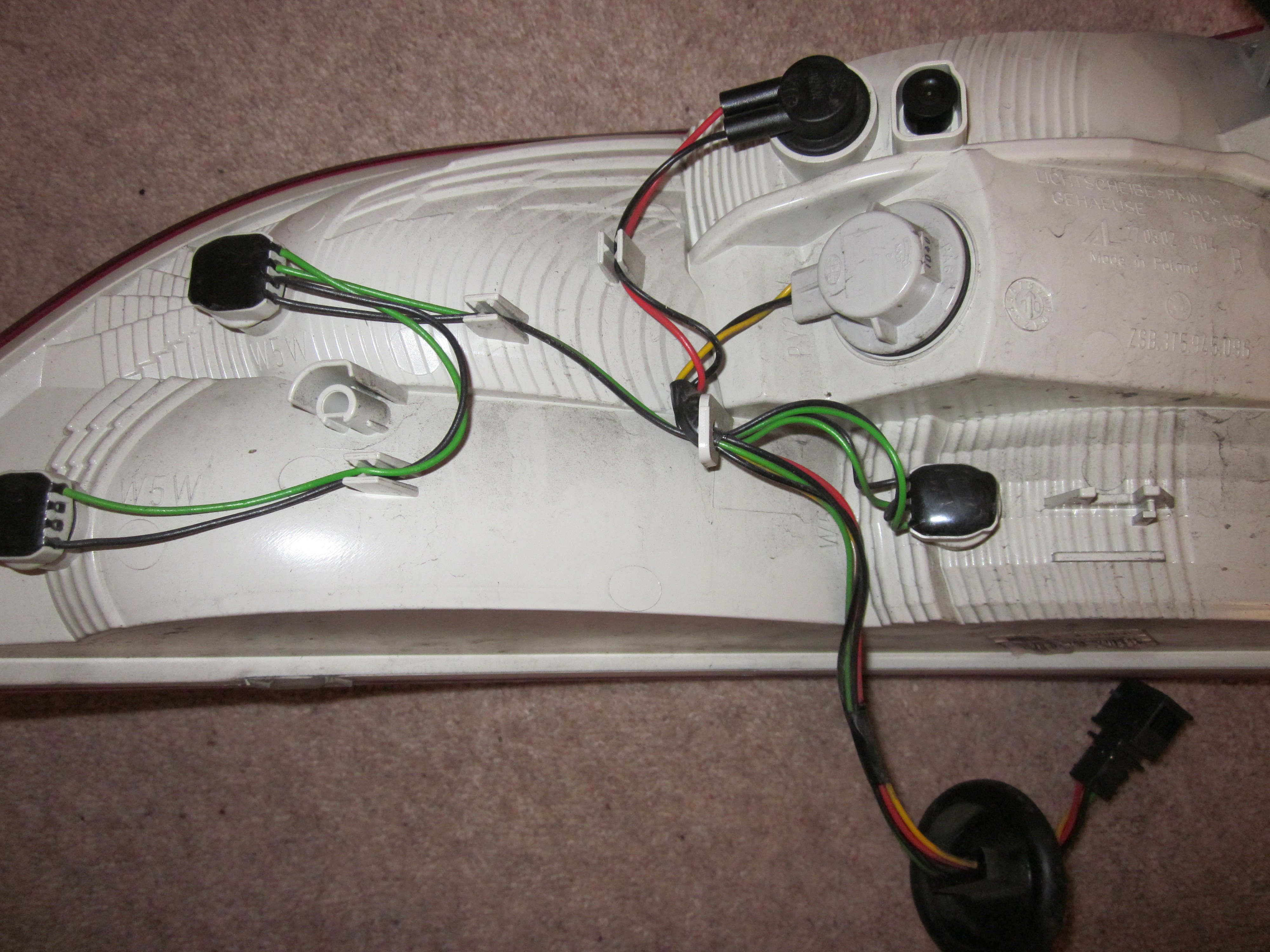

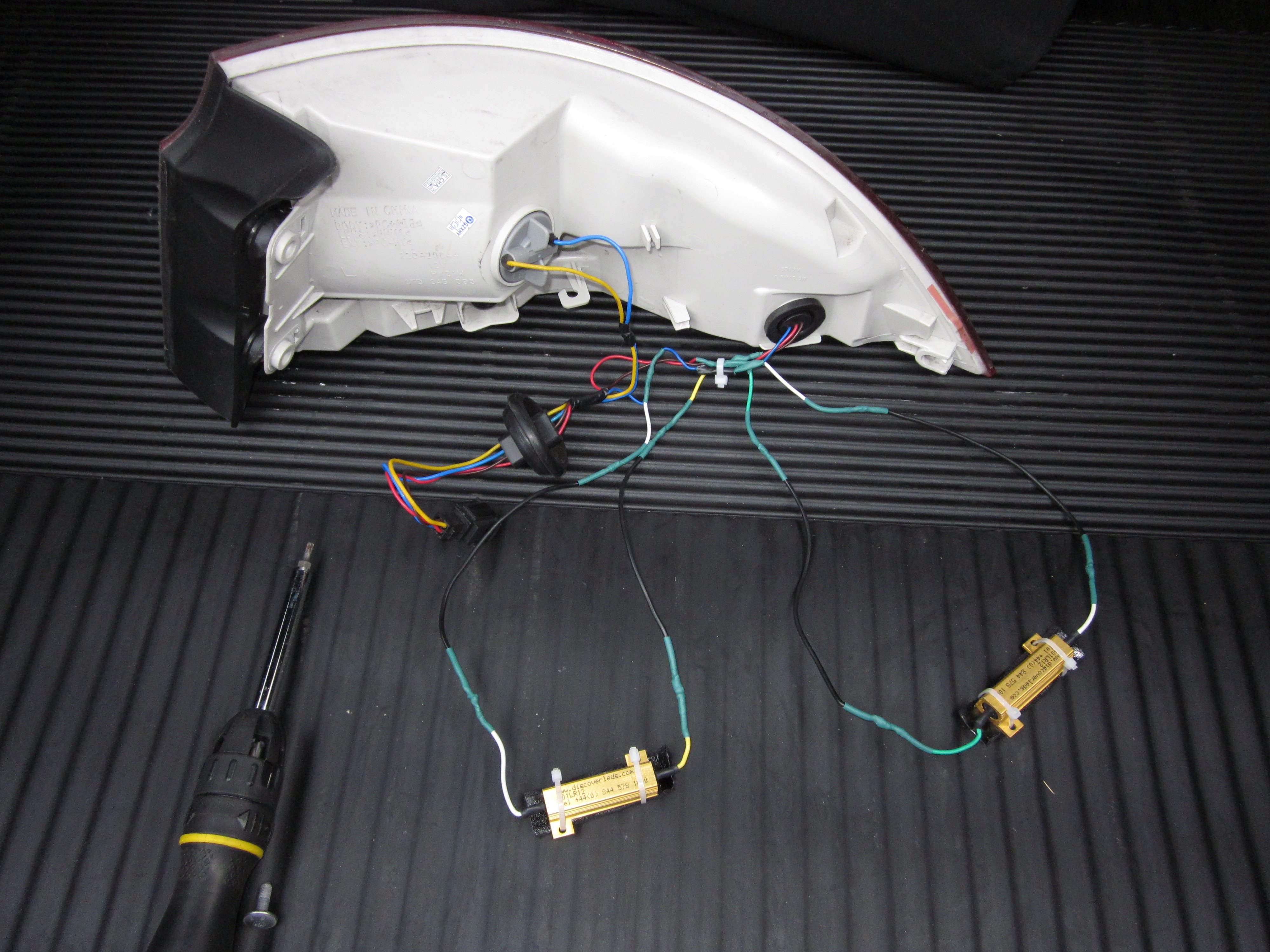

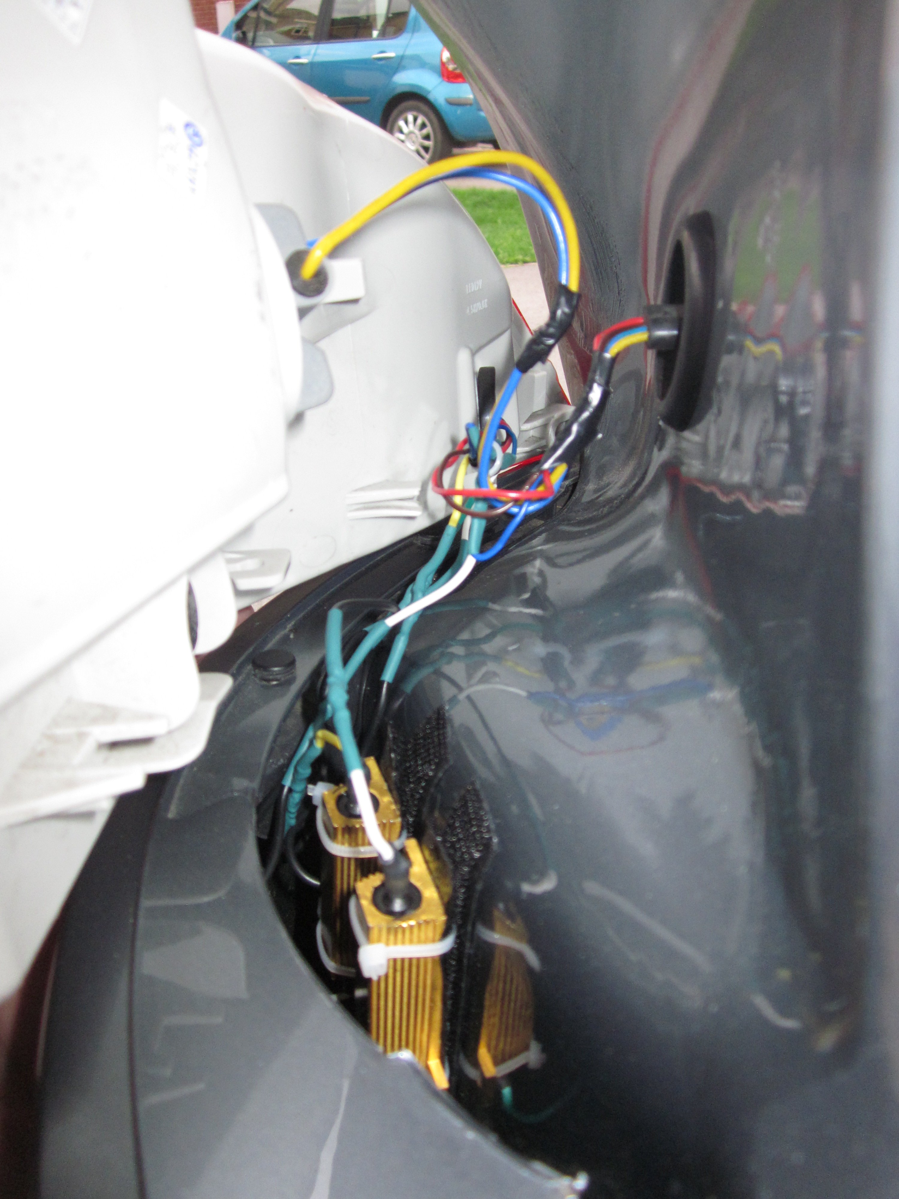

STEP 11: Prior to re-inserting the light clusters be sure to use the wire clamps on the back of the clusters to hold the wires in place. This prevents them from getting trapped when the light cluster is pushed back into place.
Here you can see the resistors wired into the light clusters with all the joints soldered and heat shrunk for a strong and fully water proof connection.
In this picture you can see that I used tie wraps as an additional method of holding the Velcro to the resistors. This was in anticipation of the resistors getting hot and melting the adhesive on the Velcro strips. When I removed the clusters recently the heat had weakened the tie wraps and they were very brittle and simply crumbled away so I didn’t use them the next time.

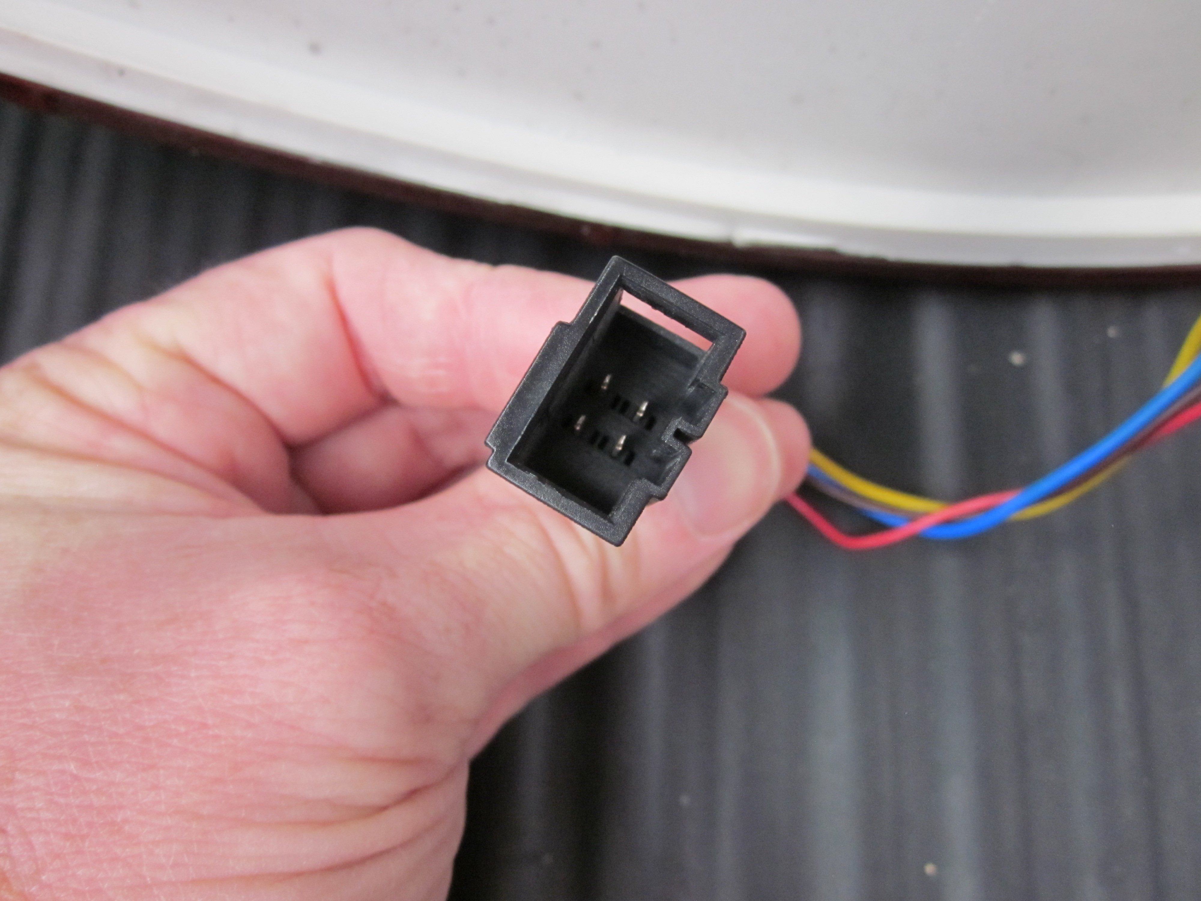

STEP 12: If you look at the electrical connector you’ll notice both sides are different. This is to ensure that the connector can only be inserted into the female end one way. Be sure to offer up the male connector to the female connector the correct way around to avoid damage.
STEP 13: Offer the light cluster up to the car and firmly push the resistors onto the Velcro strips attached to the car to secure them into place.
Be sure that all of the wires are untangled and that none of them are stretched or strained.
Push as many of the wires down past either side of the resistors into the void behind the rear bumper to keep them out of the way.
As previously mentioned make use of the wire clamps formed into the rear of the light clusters to hold the remaining wires in place.

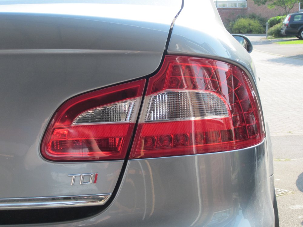

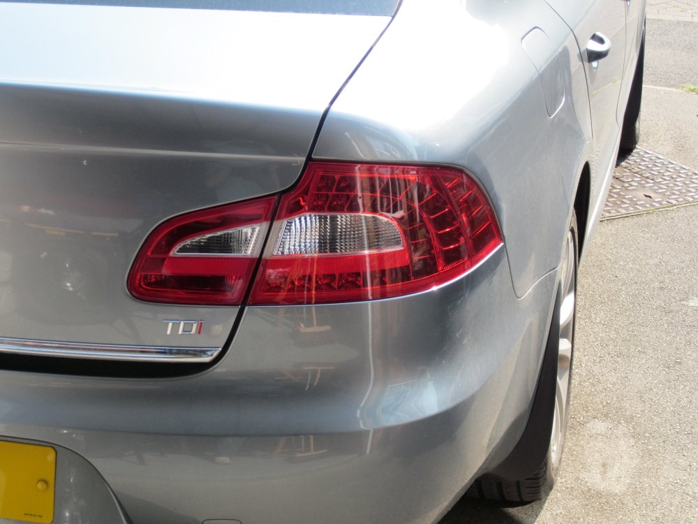

All finished...
You will need to either upgrade the BCM (Body Control Module) or have the car coded to prevent the blown-bulb warning...
