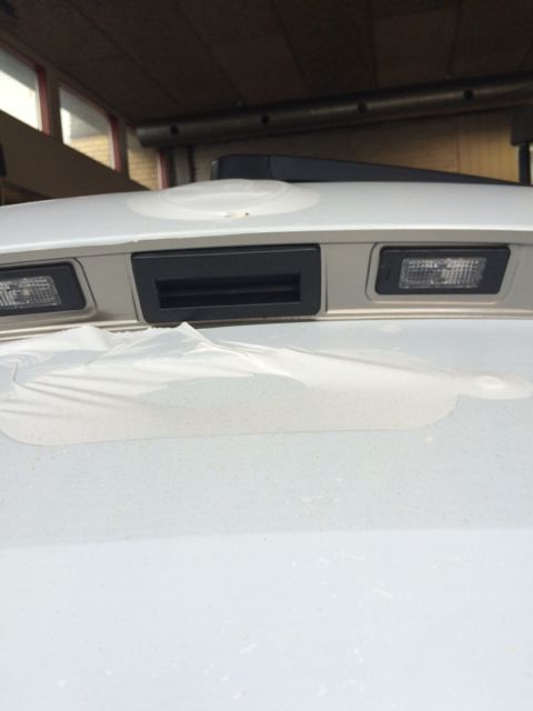

Just recived 2 rvc for the O3 from juq-performans (stefan)
A small rvc (aftermarket) and a large rvc (original)
The new (2015) O3 estate is coming with a larger boot button than the sedan. Same button as the Yeti.
I'm going to put it in a O3 Vrs sedan with columbus on monday
Will provide pictures and code if someone wants it

And your O3 needs to be 2015,5 - that is build week 35/14 or later in order to have the correct size opening in the trunk lid. So yours might just be new enough.
Just visited my dealer today and spotted a new Octavia built in week 36. It had the big boot switch opening. Another one built in week 34 had the old smaller switch.
If anyone works out what's needed to retrofit this to a Bolero, I would be very happy!  The reversing camera is one thing I really miss from my old car.
Mine has the smaller aperture, so just missed out. Thought honestly, can't be hard to enlarge it a bit.
