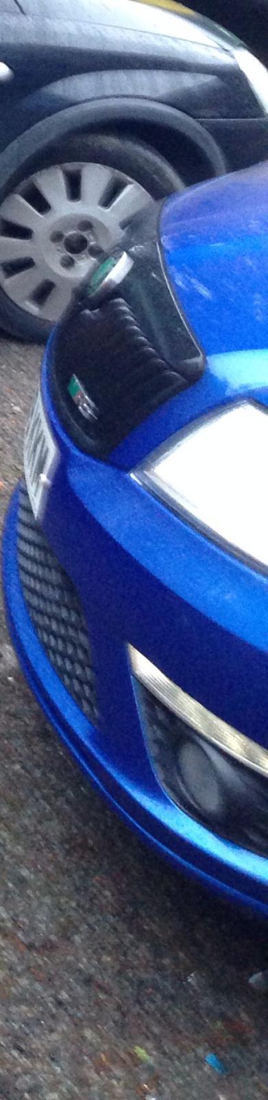

They not the ones in the headlights I have attached the photo

You have a facelift VRS with LED DRL/sidelights. The top sidelights in the FL VRS are not connected -- they do not work. There was a post on here a few months ago where an MOT had been initially failed because the tester didn't know that the sidelight function is taken over by the dimming of the LED DRLs rather than the bulbs in the headlights on this model.
