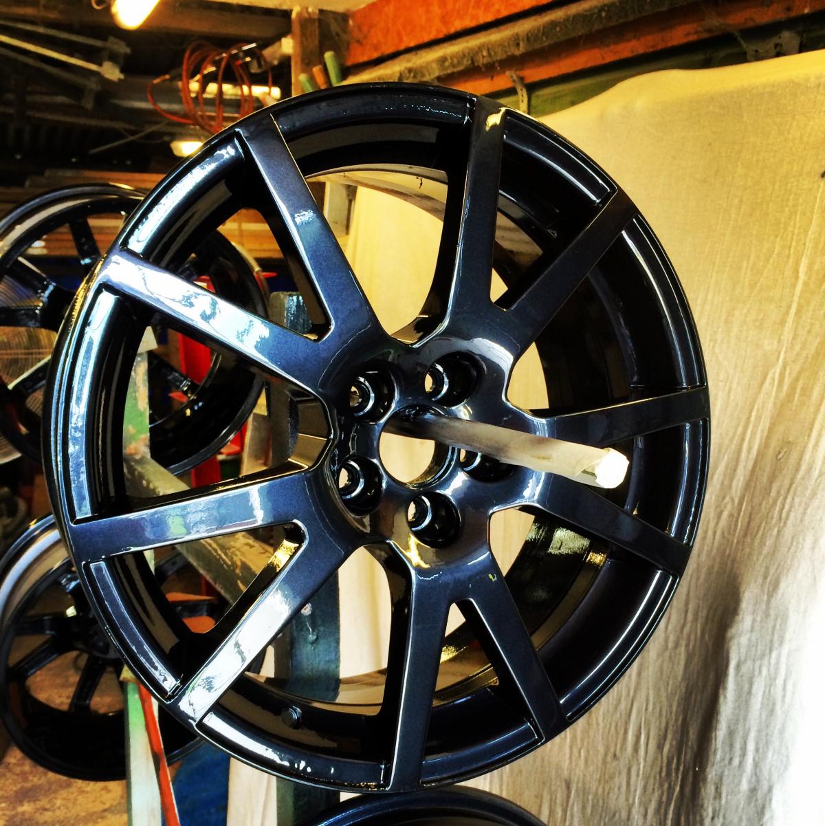

Just thought I would share with you, iv just returned my spider alloys as they look horried before.
Hope you like the look of them
For the set I used
2 cans of grey primer
2 cans of satin black for a base colour
0.5ltr of audi grey water based
1 ltr of scratch restiance lacquer

Don't take this as a criticism but I wouldn't have gone for the gloss black however as it really shows even the most slight imperfection, but I think you did a good job for a home refurb to get them as good as possible without having them fully refurbed.
With that finish you are giving yourself a very high bar to reach, but they really don't look bad at all now.
Matte look with gunmetal is a bit more forgiving on imperfections, mine need doing again and I've got a can of the e-tech to refresh mine again

It's audi pearl gun metal grey, just lighting in my shed prob didn't help,
I have spent a week prepping them ready for this back to bare metal for a lot of it.
I don't do matt colours I want deep gloss finish on my wheels.

How much do you reckon its cost you all in (obviously not taking into account the time its taken you)?
Well I had the primer in my shed from previous work. Lacquer I had too. Colour I had given to me for a favour just brought the black base coat, so a total of £8.50 lol

I know it's looked black but it a real dark audi pearl grey colour will try get some more in better light
