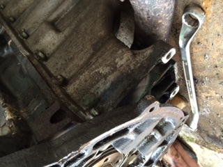

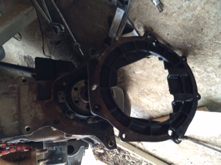

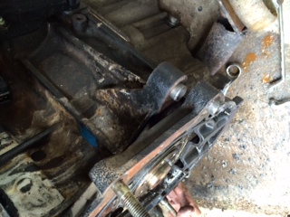

]HI GUYS  wonder if you can help me out
just removed my engine from my fun  and as far as I know its aee type and never been changed and the drive shafts at the gearbox ar the cuped type not the bolt on
ive just brought an aee from an Octavia  visual is air filter alloy sump and exhaust manifold and engine mount
asi was strippin the clutch I notice difference  in the fly wheel and pressure plat as it was backwards mounted so I removed that  and that's when I found a problem
the gearbox spacer plate will not fit it
 now im not sure what is going on
is there two types of block for the aee type engine
post-110996-0-45371200-1402779746_thumb.jpgpost-110996-0-02376500-1402779747_thumb.jpgpost-110996-0-55078600-1402779747_thumb.jpgpost-110996-0-07987300-1402779748_thumb.jpgpost-110996-0-60448500-1402779748_thumb.jpg
Ah yes, it's something that has always troubled me about vag group engines, you are indeed right the is actually 3 different types of block on an aee engine code, it beggars believf that the could do something like that as well, it's outrageous that the same engine code can have a different physical shape depending on which vehicle it is fitted to, sadly for you it looks like you are going to have to find another engine, preferably one from a felicia or the type from a 6n polo, tis a shame they didn't re-classify the ones with a different gearbox bell house bolt pattern to a different engine code because it leads to massive confusion.
the other 3rd type I mention are by rare and were only fitted to polos prior to 1995 and they have a chain driven oil pump instead and the sump has a different bolt pattern too, but other than that it will interchange as a bolt on fit..
the rule of thumb to go on is if it has a steel sump it will fit your fun bus.
thank you for your reply  . I will have to try to get   a refund  or  an exchange  .  hope this post helps some one else out
