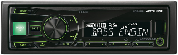

As per title I just picked up an alpine single din unit (UTE-81R) new
Is it plug and play? is there anything extra I need in order to fit as I wanna have this in tonight
Any instructions would be greatly appreciated
Thanks

If you are going from the original Symphony it isn't quite plug and play. To use the radio you will need an adaptor to send power up the coax antenna connector to the amplified bee sting antenna on the roof. If you don't do that you will probably have dreadful radio reception. Some people seem to be able to get away with it for FM in very strong signal areas but it won't work without it for MW. The antenna adaptor needs a power supply which if I recall correctly is a blue wire that may be provided from the head unit labelled as "ant cont" (at least it did with the Kenwood unit I did a couple of weeks ago. Power is only supplied when the head unit is set to tuner. Swapping the lives over has already been mentioned. These are the yellow and red wires and they probably have connectors on them that make it easy to swap them over.
Edited by svenedin
Cheers svenedin system is in, it was plug and play and I sourced an antenna adapter so fm stations are working perfectly
Also had to swap reds and yellows all working a treat
