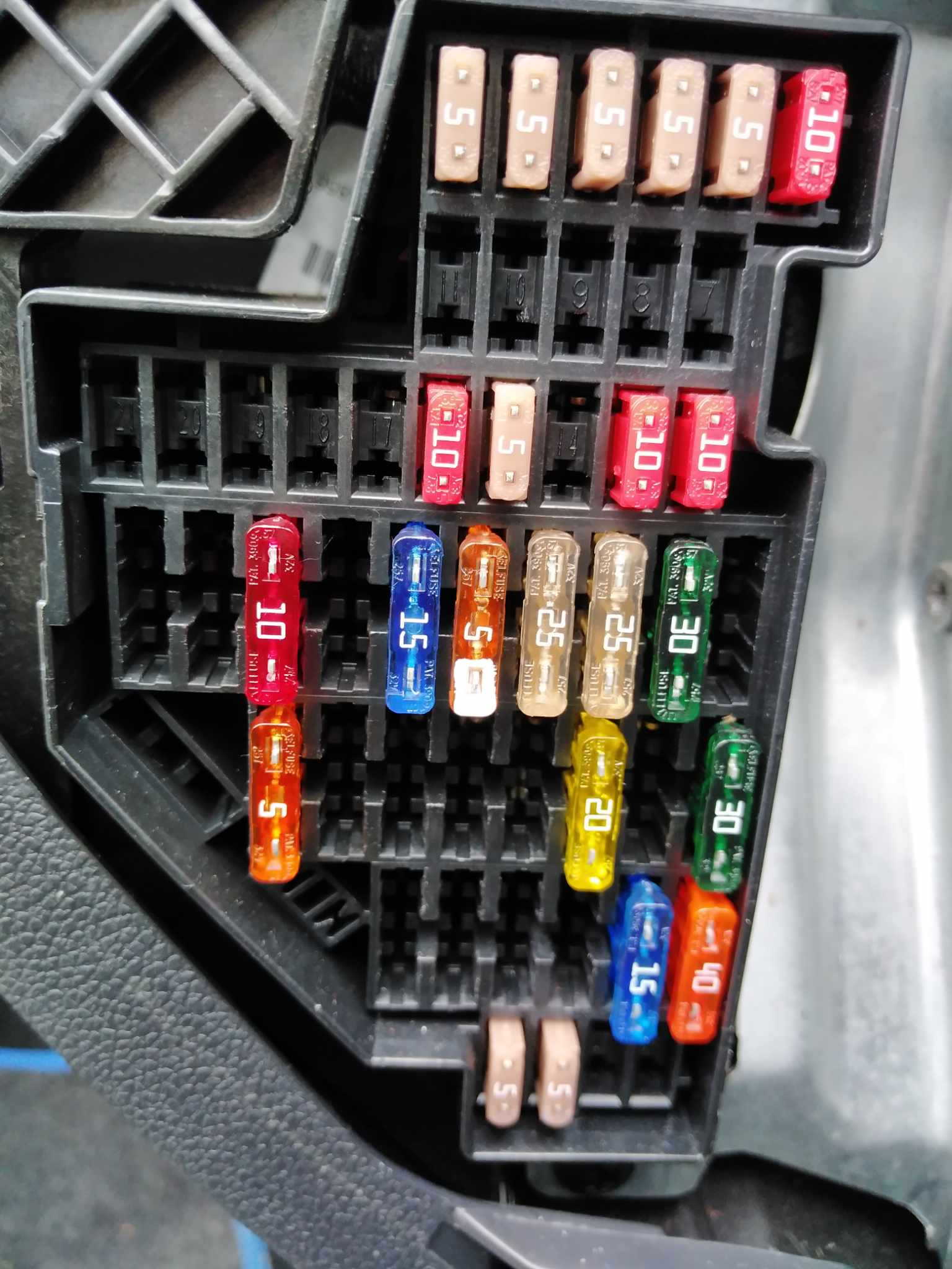

Hi, I've got a 2011 Mk2 Octavia, the rear windscreen wiper isn't moving. Before replacing the motor I looked to see if the fuse for it had blown or been removed in the dash fuse box (driver's side, not behind the glove compartment. Looking in the manual, the rear wiper fuse position is 41, but space 41 itself appears to not be functional or assigned, the fuse just falls straight out of it.
To add to the confusion, certain fuses appear to be fitted to active positions for items not fitted to the car, such as a fuse in the electric sunroof position. So the manual appears to differ from the car itself. Does anyone have a 2011 Mk2 Octavia diagram I can check it with, or know why the position for a fitted component isn't assigned? It's baffling me.

Apologies, it runs from right to left. I've just tried fuse position 18, it's inactive, fuse just wobbles in it. 14 and 19 appear to be active but you can't get a fuse into them, 17 is active with no fuse. So position 18 can't be it, because it's not an active slot. The plot thickens.

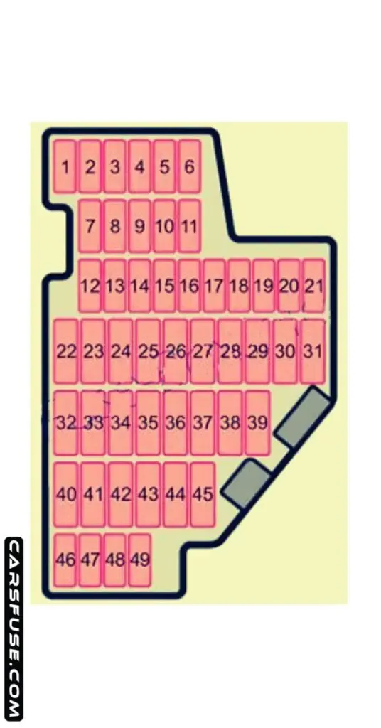

This is what I've been working from: image.thumb.png.94bdbfadf24a49a0f8fdb5c6d1768875.pnghowever in my box it runs from right to left (21 is where 22 is, then 20 (23), 19 (24), etc.
image.thumb.png.8c943a9b7add978e5d5aed5cfb2ba6d5.png as you can see the numbers are running right to left.
On the row you mentioned, 41 should be 2nd from left, but the entire row except 3rd from right and the 2 with fuses in them on the right are inactive and don't have contacts, the one that is active, 43, appears to be for the sunroof, which isn't installed on my vehicle.

No, for RHD 41 is 2nd from right, where there is a blue 15A fuse.

Hang on, I think I've got my left and rights wrong, 41 should then be where 44 is, which has a 15 amp fuse in it.
Just realised I had my rights and lefts mixed up. Found tried a few fuses and no luck, so the motor's dead.
Just for completeness here is my method of getting the fuse position right.
Sit sideways on the drivers seat and hold up a mirror that reflects the fuse location at the end of the end of the dash. The reflection in the mirror then looks like the diagram for a LHD car, as shown in handbook.
