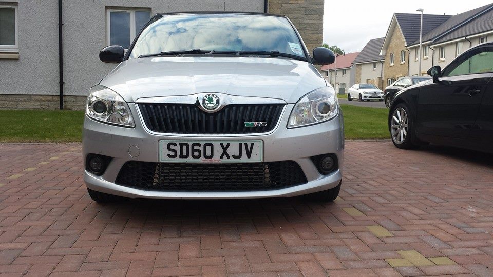

FItted this at the weekend. it was a biiiiig job. it took me around 5 hours to do, mainly due to the fact i kept fitting things in the wrong order.
Im going to say now, this is not a simple job, if youre not confident, please do not try it, a garage will probably charge around £150-200 to fit. and imo that is better than having an unusable car
I didnt have to cut a crash bar, i had to cut the plastic cradle, BUT i have managed to retain the standard intercooler mounts so you can still go back to standard in the future,
its early days and i dont really know what to say but the car is much more eager and pulls a lot harder, after a boot, the oil is around 98oc instead of the 112oc+ i had been seeing recently since fitting the bluespark box.
NOTE: You really do have to remove every single bit from the front of the car, Nothing against small people but if you're small this may be a bit of a struggle if working alone. you do need long arms and a bit of strength behind you, eg when you remove the front frame, crash bar which comes dropping down etc.
from fitting this i see a few areas you could improve on to make this kit better so;
This is what you need:
Intercooler: http://www.ebay.co.uk/itm/Universal-FRONT-MOUNT-INTERCOOLER-Medium-550-x-180-x-65-UK-/181347296562?pt=UK_CarsParts_Vehicles_CarParts_SM&hash=item2a39242532
Joiners: http://www.ebay.co.uk/itm/300941171420?_trksid=p2055119.m1438.l2649&ssPageName=STRK%3AMEBIDX%3AIT
The kit i used had straight joiners, when taking the car out for the first time i managed to blow a hose off, so i would get ones with lipped ends!
2xSilicone hose: http://www.ebay.co.uk/itm/BLACK-Silicone-Hose-57mm-x-90-Degree-2-25-Silicon-/351014338318?pt=UK_CarsParts_Vehicles_CarParts_SM&hash=item51ba15bf0e
these need trimming where they join the intercooler, a few inches maximum.
10xJubilee clips 55-70mm : http://www.ebay.co.uk/itm/Genuine-Jubilee-Hose-Pipe-Clip-Tube-Clamp-Air-Fuel-Water-Gas-Silicone-Rubber-UK-/141317281903?pt=UK_DIY_Material_Nails_Fixing_MJ&var=&hash=item20e72a986f
I personally after having my hose blow off fitted 2 jubilee clips to each join. i see the money spent here is better than losing out on money due to missing work... this is up to you though. ONLY USE QUALITY CLIPS! dont skimp out on a couple of quid for you to be removing the front of the car weekly! time is money in my eyes, do it right, the first time!
Stainless steel support: http://www.ebay.co.uk/itm/380830463267?ssPageName=STRK:MEWNX:IT&_trksid=p3984.m1439.l2649
I used 2 of these to support the intercooler and a couple of bolts i had lying around
A little bit more than £100, but at around £120 for a front mount you cant really complain, IMO this would the the kit i would have built if i didnt get a used one for £70.

Well done mate. I'll keep an eye on this to see you long term opinion/results.
so far, its going great, the car, imo is scary fast from 3600rpm! my old focus st didnt throw you in the seat as much as this does. im totally in love with this car now. i think downpipe next then im going to get on with some suspension work. I'll update this thread as time goes by :)
as long as you use the quality parts i have listed above i cant see any reason why it wouldnt be an amazing piece of kit :)

IMO there is no bodging at all. all you need to do is trim a few inches off the plastic intercooler cradle.
