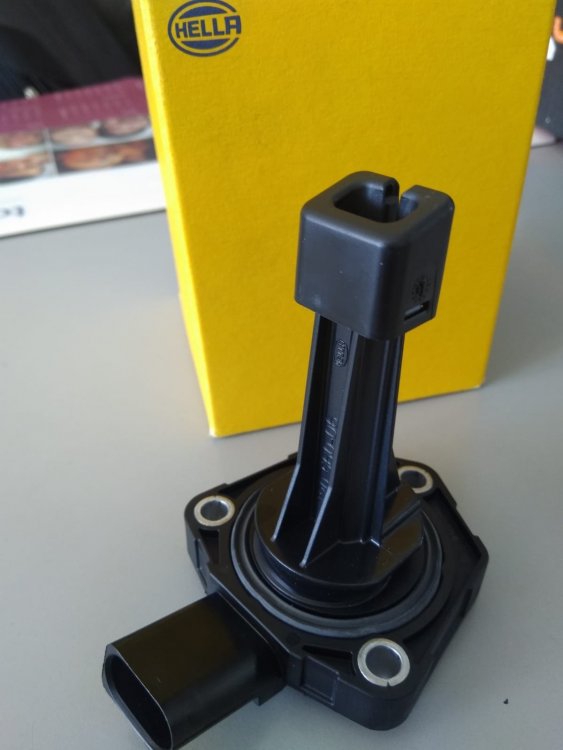

Here's an upside down picture of a CBZA sump, with the position of the level sensor ringed in red, if the fuse is OK, check the wiring near the sensor connector next:
Problem finally solved! Oil sump sensor replaced. Have driven over 100k and no oil light. Thanks for all your help.
