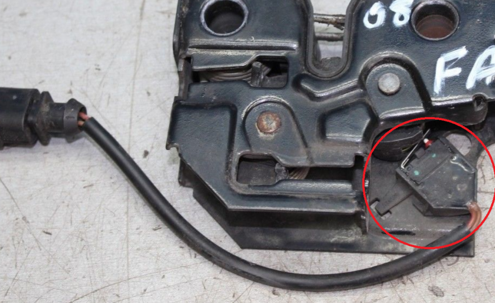

If your car has a factory fitted alarm, the part number of the bonnet latch is 5J0823509A, as far as I can see here (item 27):  https://skoda.7zap.com/en/cz/fabia/fab/2010-608/8/823-823010/#27
The actual 'is the bonnet fully shut' sensing element is a microswitch, shown circled in red in the pic below.  Not available separately from the latch, as far as I can see, but looks like it could be removed and another transplanted in, with a bit of cunning or bodgery.  I think the failure here may be wiring problems as well as the switch itself, so have a close look at whatever wires you can get a view of, looking for breakage.
Edited by Wino

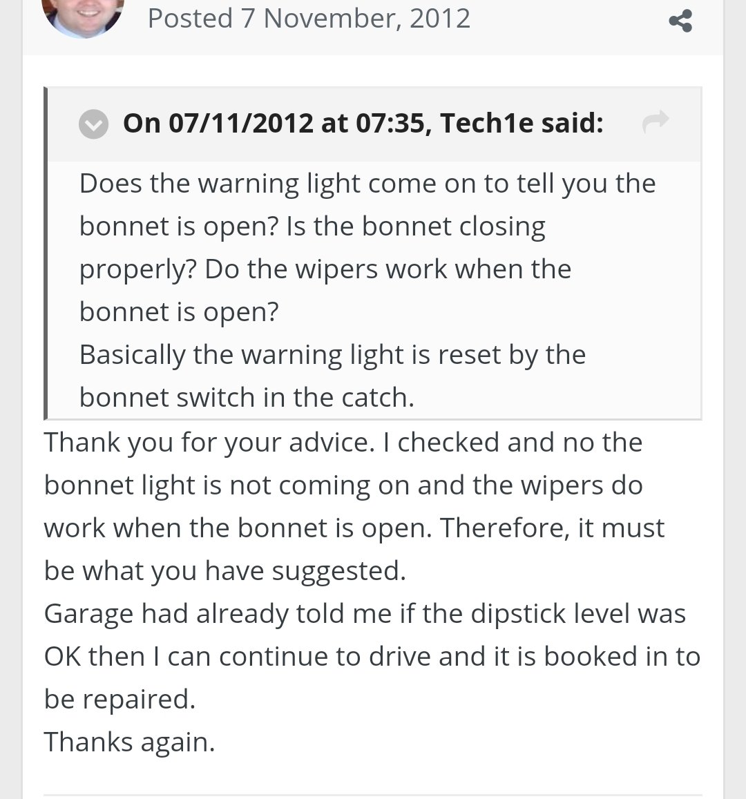

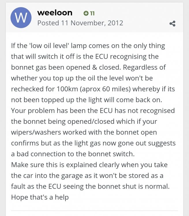

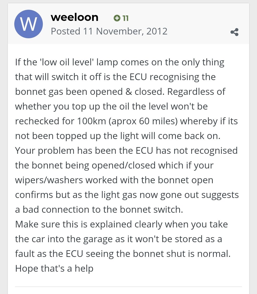

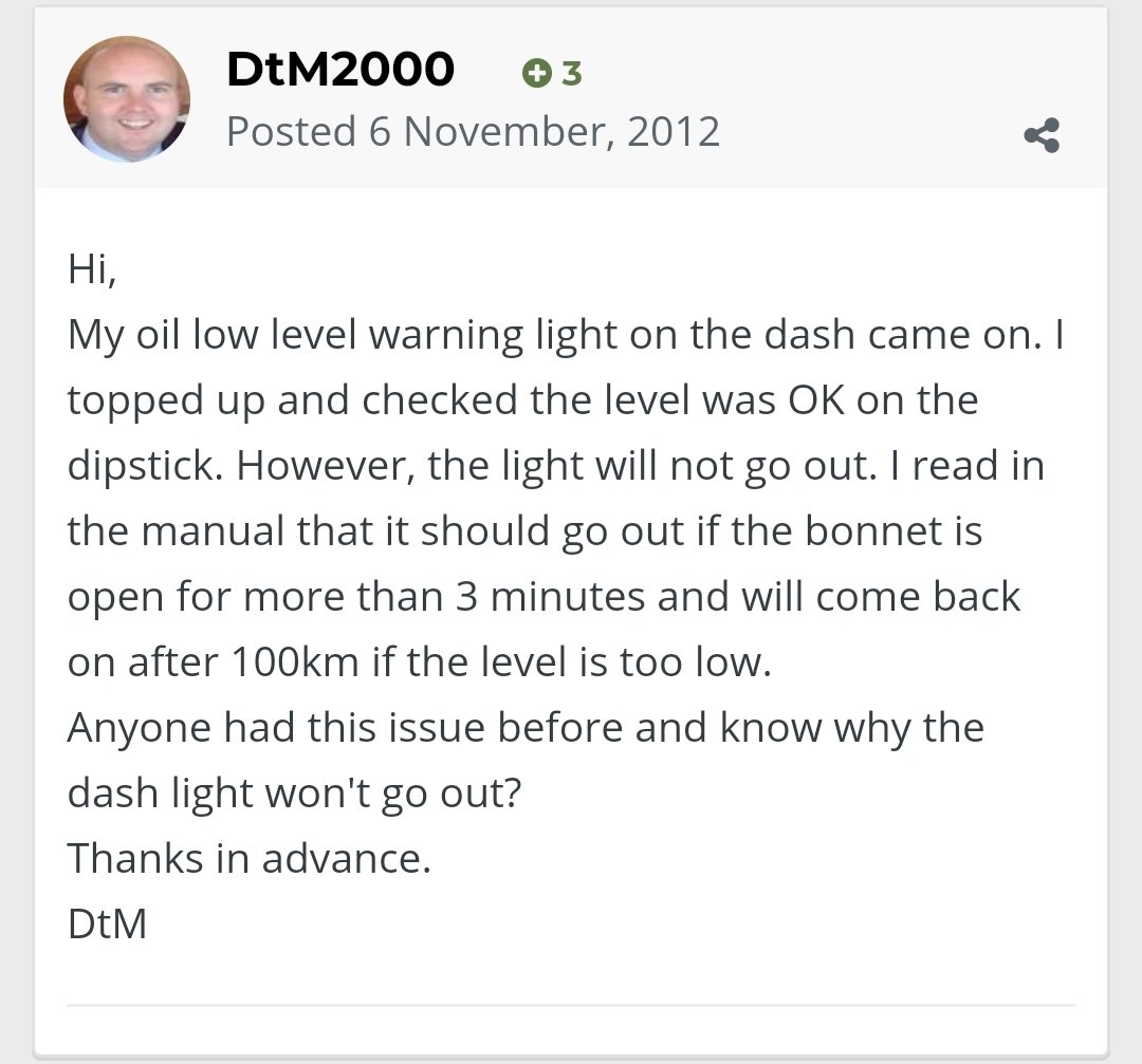

This is what has been posted before on this site.
Just re-read the responses, so it's likely to be a problem sensor at the bottom of the sump?

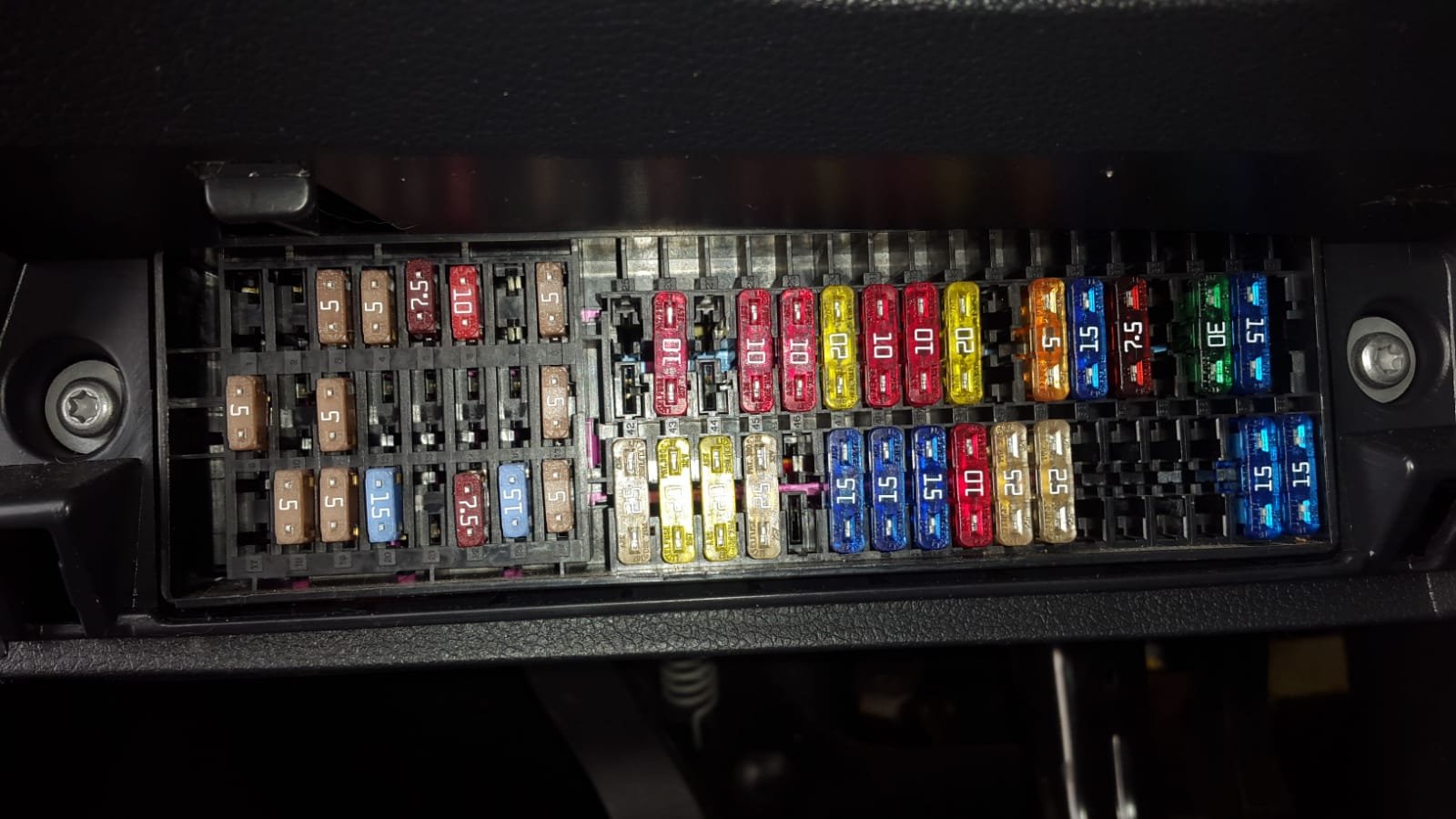

  • Sponsor

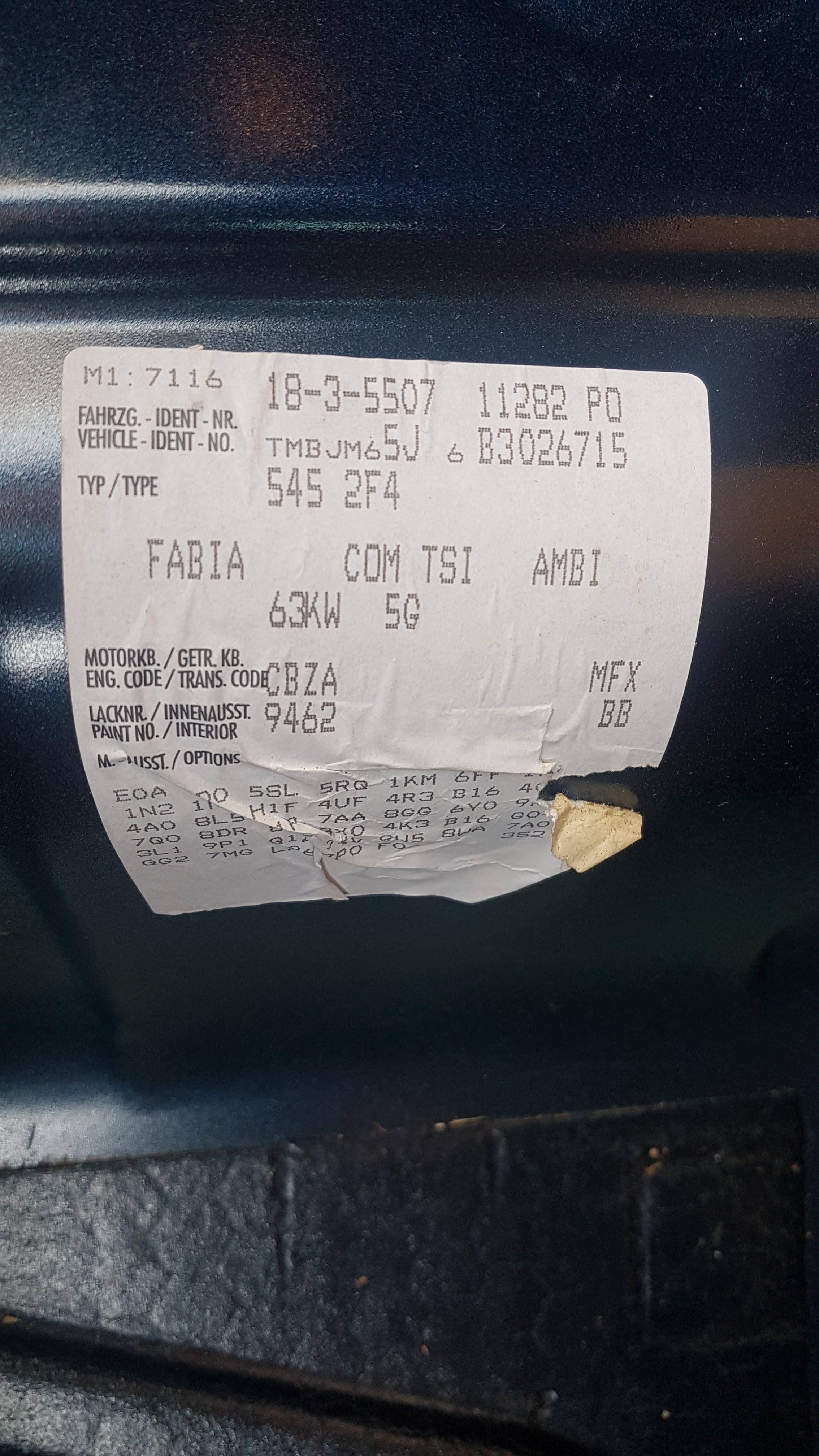

Check fuse 3 in the cabin. Not certain it's that one for your engine, but the first few I've seen are that one. If I knew the engine code of your car it would help me to find the right one, see my signature for how to find that.
Edited by Wino
Thanks. I can't find "your signature" to find how to find the engine number. Is it the number written on the glass etc.?
  • Sponsor
Guess you're browsing on a phone? Signature is some text displayed below each post, that you can add to display permanent messages. Mine says words to the effect. "Engine code is a great help when diagnosing car problems; you can find it on the data sticker on the boot floor, and maybe also there's a copy in the service book".
Here's the sticker
  • Sponsor
CBZA engine. Will just double-check but I think that was one of the ones where it's fuse 3.
  • Sponsor
Yep, fuse 3; 7.5 amp rated I think, but it looks like it powers a few other things so I think you'd probably have noticed if it was blown. Worth checking though. Bottom row of the smaller fuses, third in from the right.
Crossed out as that description was for RHD; should have said third in from left, top row of smaller fuses, for LHD.
Edited by Wino

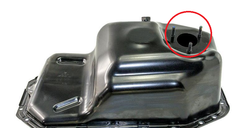

  • Sponsor
Here's an upside down picture of a CBZA sump, with the position of the level sensor ringed in red, if the fuse is OK, check the wiring near the sensor connector next:

I think it's more likely to be this then. We've checked the fuses, none are blown.
