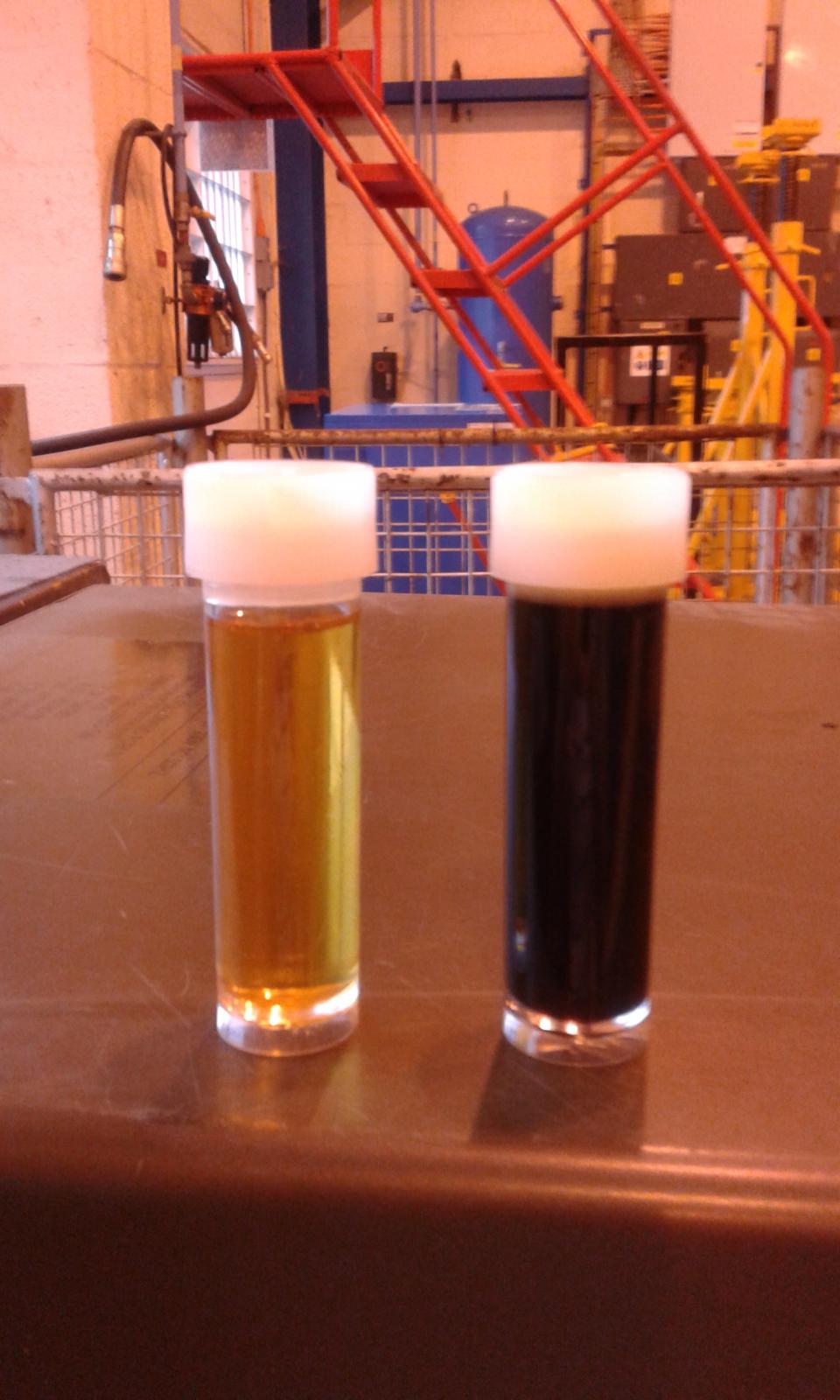

VAG say it's filled for life but just wait till you see the colour of the oil!
Phil
I changed the gearbox oil on my 2008 octavia thats covered 54,000 miles & this was the colour of the oil that came out (the tub on the right),it improved my 1st to 2nd gear change alot & made the gear changes much smoother,mine is the 6 speed box.
