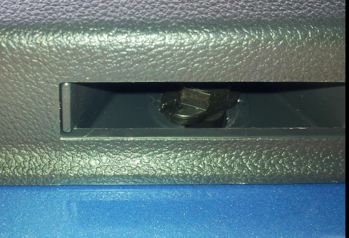

Ive notice there are no torx screws at the bottom of the panel, are they just normal door clips ?
just to update i think it is a nut on a thread attached to the door ?
Edited by hossit

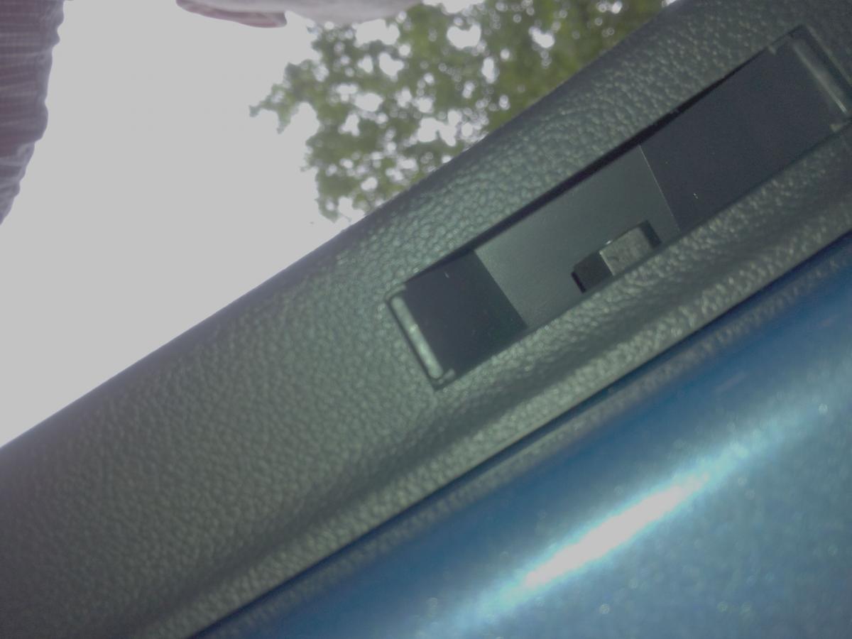

well it's a 10mm nut, tried to undo but just seems to keep turning, hoping someone else can throw some light on this , thanks
another update, it appears that if you give it half a turn it should release the panel, according to a skoda mechanic, not tried it that yet, will update
Finally sussed it, its a nut that turns in elongated slot, proball have to pop the bottom to clips first on the corners then tutn the nut untill it releases, better picture attached
