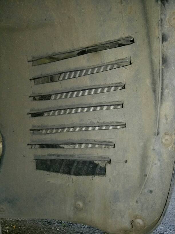

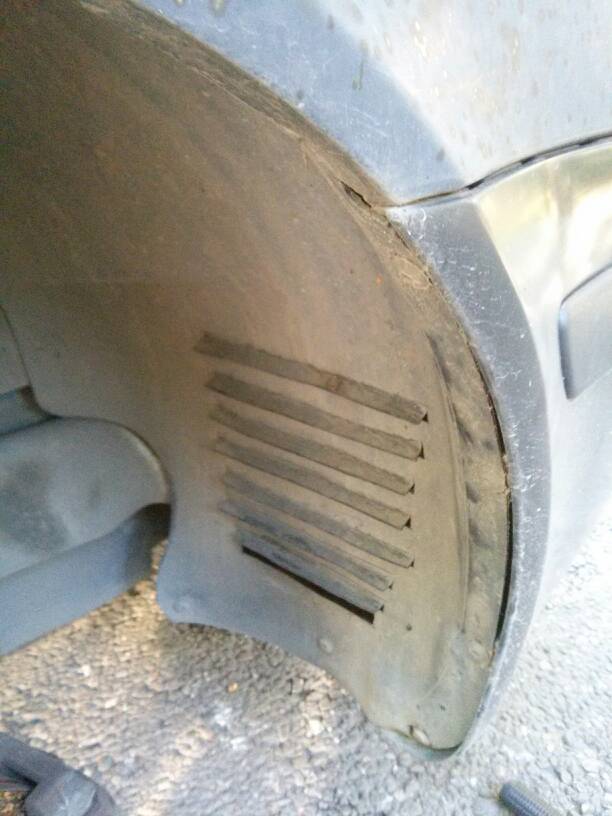

fit a b&q metal luverd vent in the drivers wheel arch behind the intercooler this will help cool the intercooler better when runinng remap they only cost £5 and spray black with some old spray paint then rivet to wheel arch job done ,also audi s3 upper and lower strut braces these fit straight on and look oem and are a good price from the main dealer,also fit a large 3inch cold air feed to the std air box which gose down behind the bumper i always retain the stock filter and replace every few months those k&n pannels are a ripoff these days,its well worth investing in a silicone boost hose and breather hose kit as the ones fitted are likely to be old and shot and when you remap boost will just leak with the higher presure ,creation motorsport do both sets for a very good price loads cheaper than forge motorsport.
B&q yes, but not the metal ones. When you put it next to the plastic ones they have a much larger flow area. You can also trim a lot of material off the front vent cover which helps. Defined air box and the larger snorkel or some holes drilled out the bottom help stop tip collapse when you have the remap as well. Before looking at remapping though you need to check what engine code you have as some of the 1.8's have the ko3 not the ko3s like the 4x4 and the VRS
Just drill the arch liner
Or go down the scrappers and find a suitable vent from another make of car.
The difference in flow area over just drilling is significant, I started with drilling, looked at metal(aluminium) vents and also donor vehicle vents but the scrappies want stupid money for stuff. The b&q plastic vents work best and are cheap, you can find them even cheaper on line too.
do you place the vents so the holes are up or down? don't need it for smic as i have a fmic but my air filter is down there
post-56156-14040596676784_thumb.jpgI did this
Your air filter is passenger side
Smic is drivers side
And louvers pointing downward
I know as I put it there....

As for the vent you can have it facing down or as I have done, out of the wheel arch.
